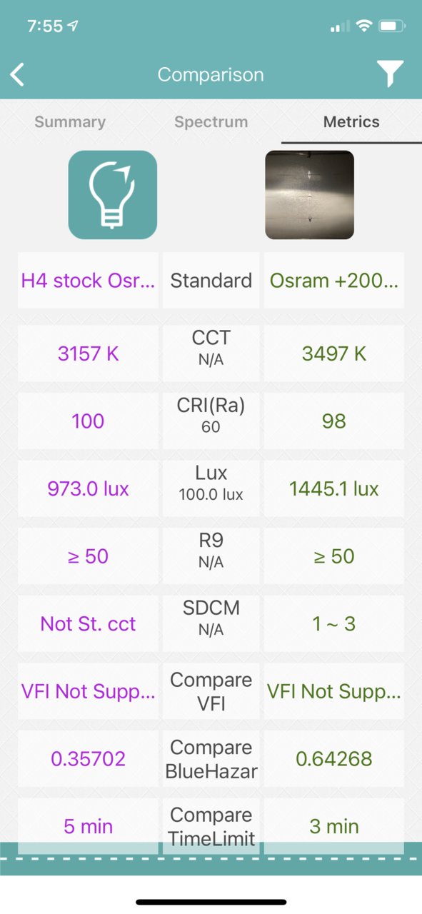

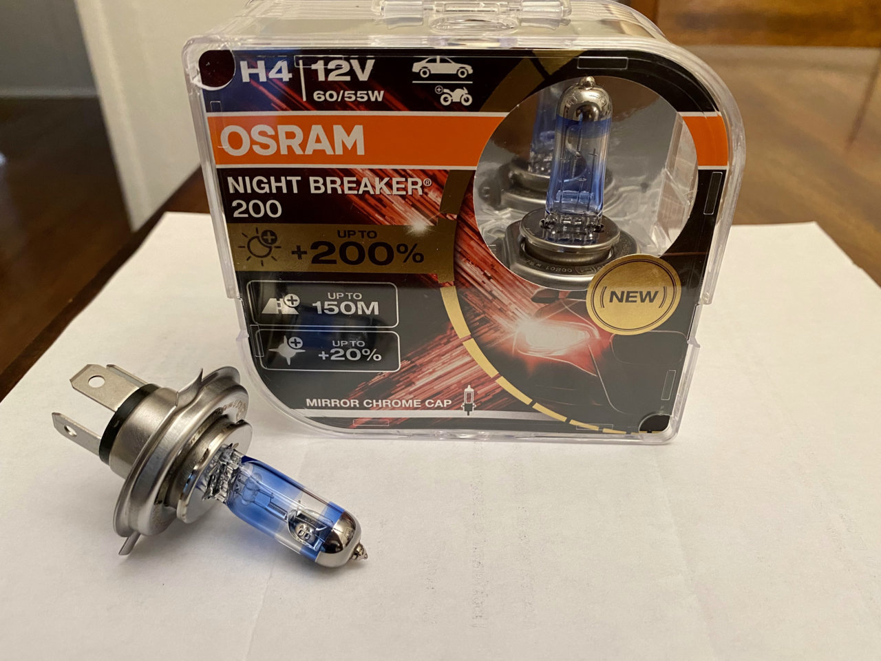

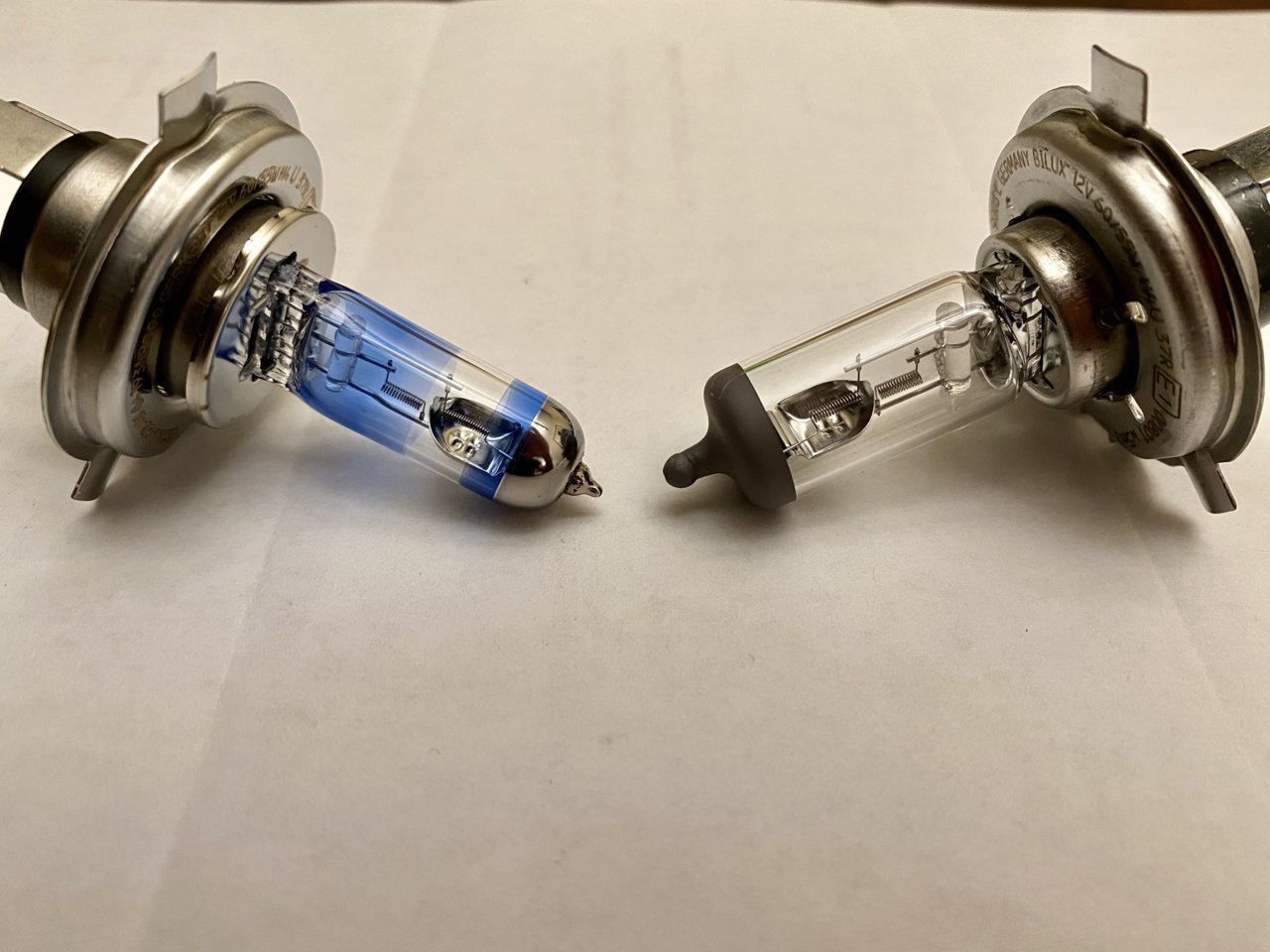

    Osram Nightbreaker +200 H4
    These latest +200 bulbs from Osram were released after Philips previously came out with their GT200 +200 bulbs. A common shortcoming in these products is the high beam filament is coated in a performance robbing blue coating. Interestingly on the Osram' Nightbreaker +200s, the blue coating is slightly lighter around the high beam filament than the rest of the bulb, to reduce high beam performance loss. I put the bulb on a white sheet of paper to make this trait more visible. Unfortunately I don't have the Philips GT200s on hand to compare. Interestingly these +200 bulbs are also rated at 400 hours, just like the Philips GT200s, making them very much a competing product in terms of performance claims and bulb life. Osram Nightbreaker +200 specs here.
    Ironically Osram goes out of their way to market the chrome bulb cap, but in an 9003/H4 application you will typically have a glare cap inside the assembly that covers the end of the bulb, so it won't be seen.
    The Osram +200 capsule size is smaller than the stock Osram bulbs.
    Output is noticeably brighter and whiter than stock.

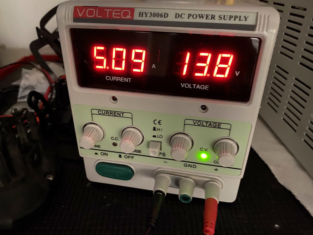

    Low beam power draw is at 70.2w.
    The Nightbreaker +200s are good for ~49% improvement over stock, while also providing 300k+ whiter output.

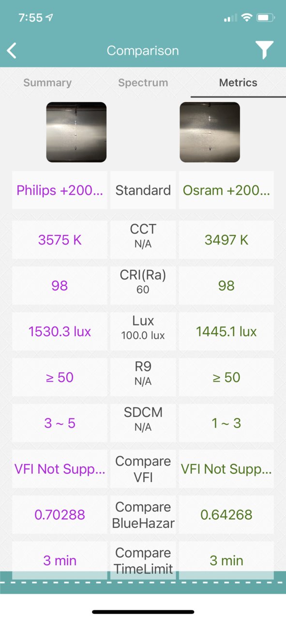

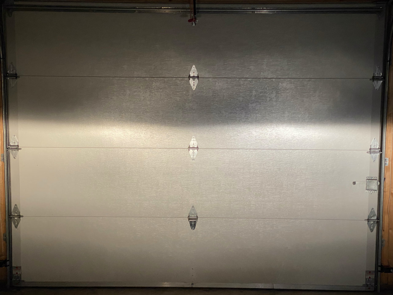

    Comparing the Philips GT200s to the newcomer Osram Nightbreaker +200
    Philips edges out Osram by about 5.9% peak intensity, while also being just over 75k whiter. Interestingly the Philips is 69w vs the Osram's 70.2 based on my measurements. It would initially appear here that the win goes to Philips. However, Philips did not do the lighter shading above the high beam filament like Osram did on their Nightbreaker +200. I did not measure high beam performance but while Philips low beam outperforms Osram's based on my measurements, I would expect Osram's high beam to slightly outperform Philips high beam based on the coating color. Not the best picture for comparison, but Philips GT200s shown below.
    Both products perform very well and are a great upgrade over stock with impressive bulb life for a performance bulb.
    With the Philips Racing Vision GT200 +200 the bulbs performed at about the same level as the Philips Racing Vision +150 bulbs, but the newer bulbs had significantly better life. It would appear some brands are adjusting their plus rating up by moving the baseline down, maybe to LL bulbs. I don’t have the Osram Nightbreaker +150 H4 performance measurement on file, but I wouldn’t be surprised if the same trend existed and performance was similar to their +200, just with improved life like Philips.

    That crimped-on base of the Osram +200 makes it look cheaply made, especially next to the stock bulb. And the smaller bulb means less gas volume, I wonder how that might affect performance and/or bulb life.
    As always, thanks for putting these tests and comparisons together. This is awesome information.

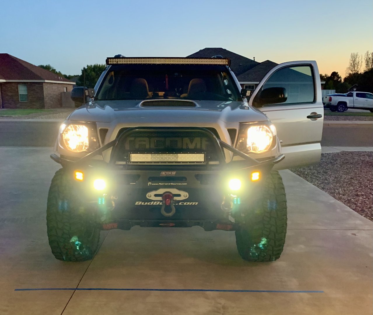

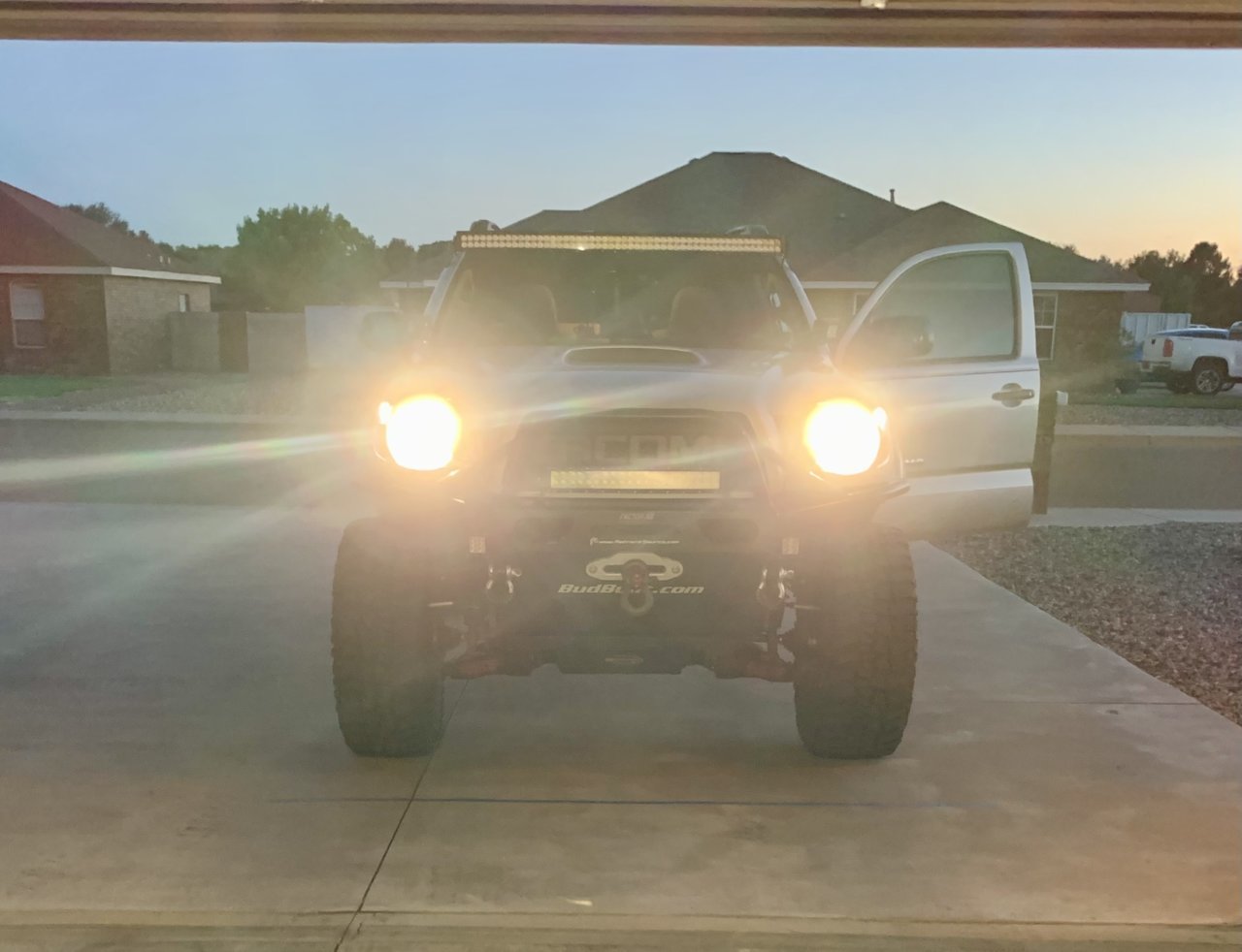

    PO installed a retrofit Depo headlight hid /halo system. I upgraded today to this system. So very happy with the outcome. Quality harness cannot recommend enough.
    now to aim the lights tonight.
    thank you to the OP for all this great information.
