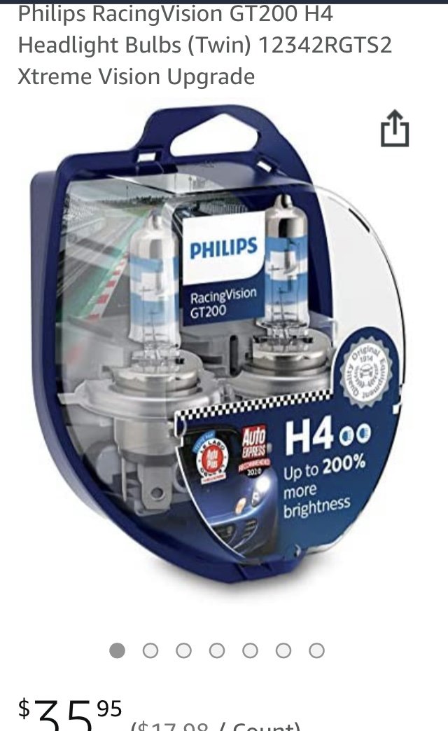

    As for the Halogen bulbs I didn't want to do any wiring upgrades so I decided to go with the Philips Racing Vision GT200 H4's. I am so pleased with these lights that I ordered another set. I also replaced my 4157 DRL Sylvania bulbs with a new set (same brand) just to have them all new. I'm surprised nobody flashes their high beams at me because these are very bright AND the range is awesome. I was so used to my LED's that I didn't realize how much less range those lights had compared to my current Philips H4 Halogens. I'm including some pictures with the obligatory :D front of the truck picture as well so you can see how the lights look. I live in Miami so it's hard to find a completely dark road. I'll be heading to the Everglades soon which is pitch black. Looking forward to shining my lights on some gators :rofl:

    Do u have the upgraded harness?

    No need for the upgraded harness with those bulbs.

    still happy with these bulbs? Want to do the full upgrade as described in the thread but short on time with holidays and travel right now.
    swapping bulbs, as you did, for the improvement seems like a no brainer.

    Yes. Very happy with the bulbs. The ONLY thing I may upgrade later is the fogs but for sure I am happy with these Halogens.

    where did you order bulbs from? Tried searching the auto stores near me but haven’t had any luck. Amazon?
