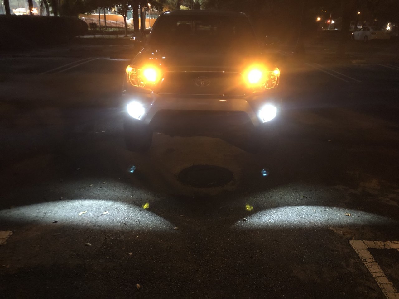

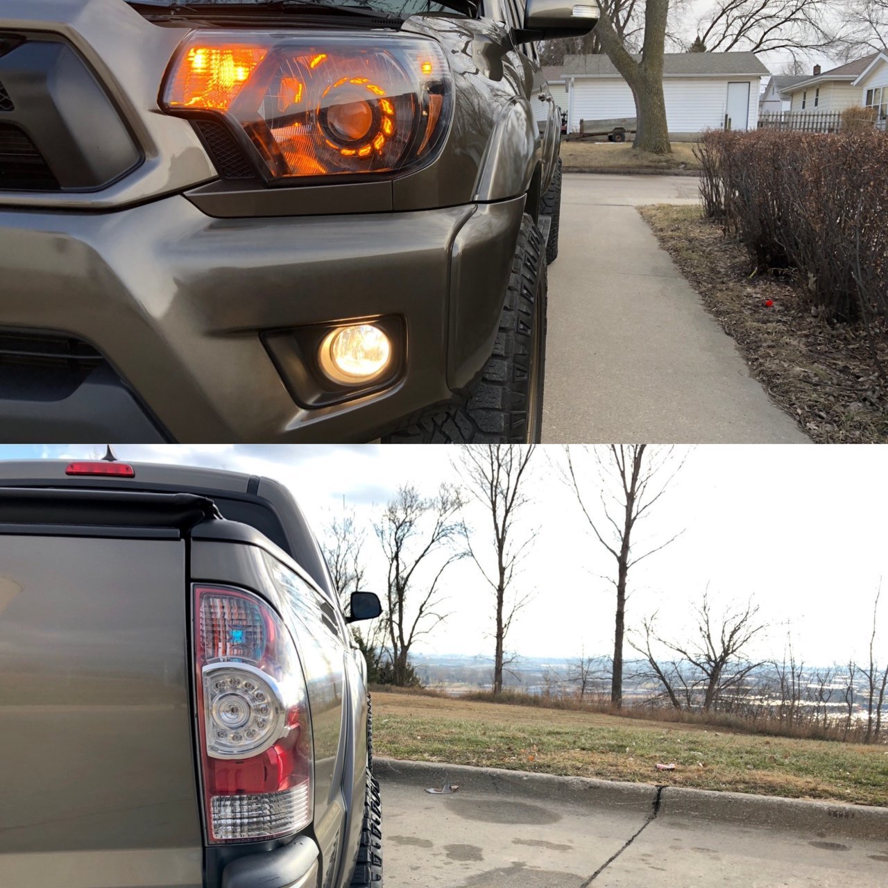

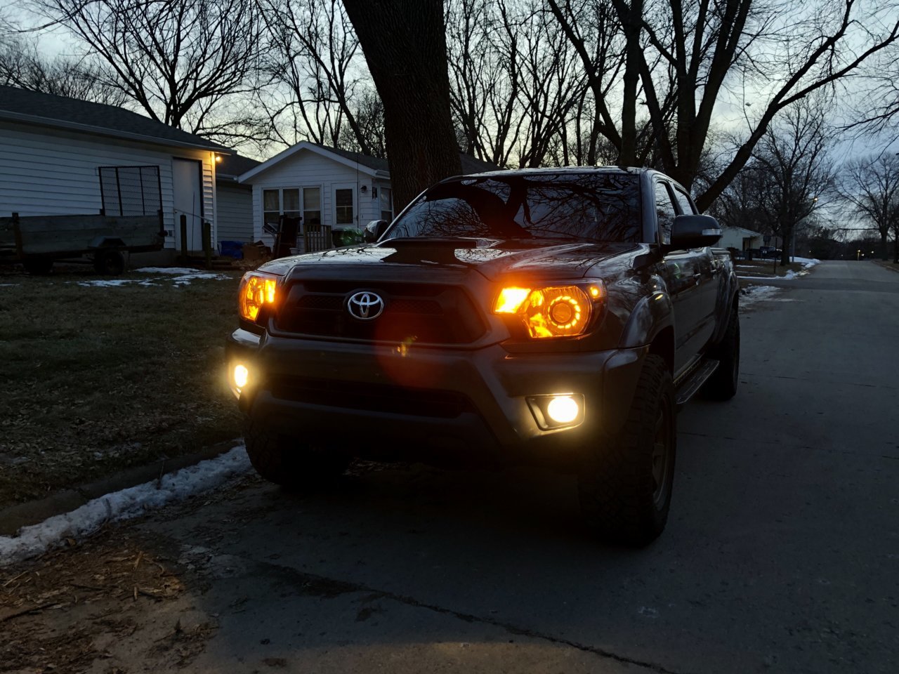

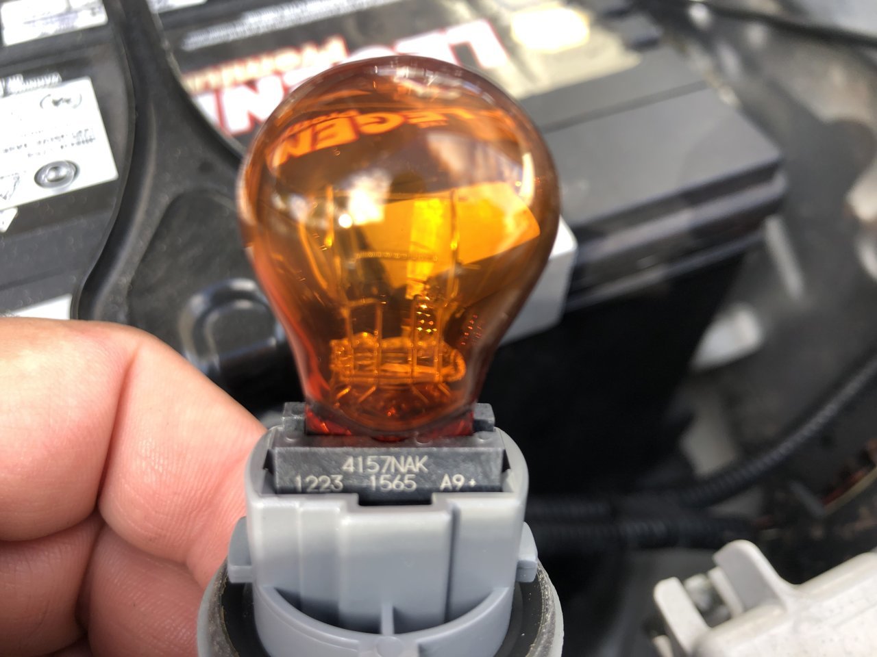

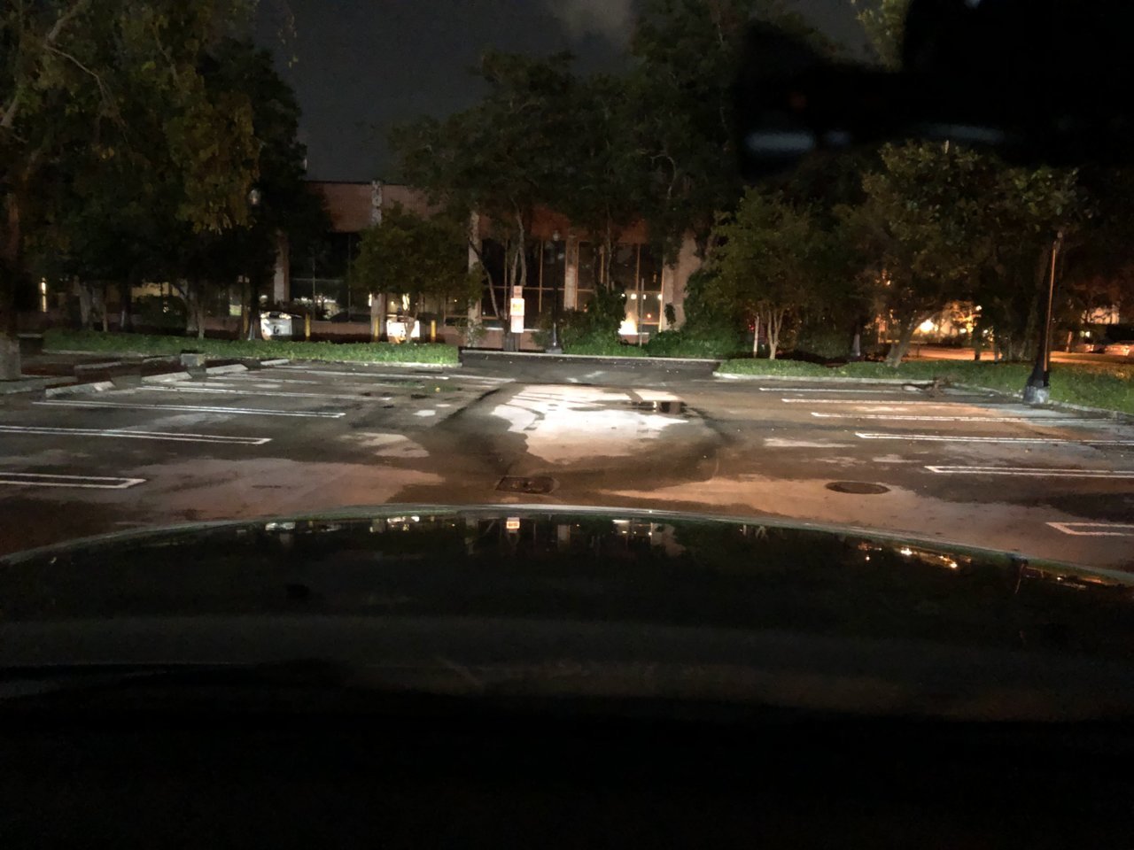

    Those 4157's are great bulbs. If you want another option that is a little more stylized (neochrome) when off and equally as bright and/or potentially brighter look into the Sylvania Silverstar 3357A. I've had them in multiple vehicles and one set I swapped from one car to another has gone over 10 years before I sold the car. I normally don't suggest anything with the Silverstar name on it, but these things have been amazing!
    https://www.amazon.com/gp/product/B000AME5GI?ie=UTF8
    In this picture is the above bulbs with Profile halos behind the shrouds of the projector. They have a nice deep amber (not dark though) which I prefer as well. I have them in both the front and the rear and when the signals are on I can see the light on the ground in my side mirrors from the rear bulbs.
