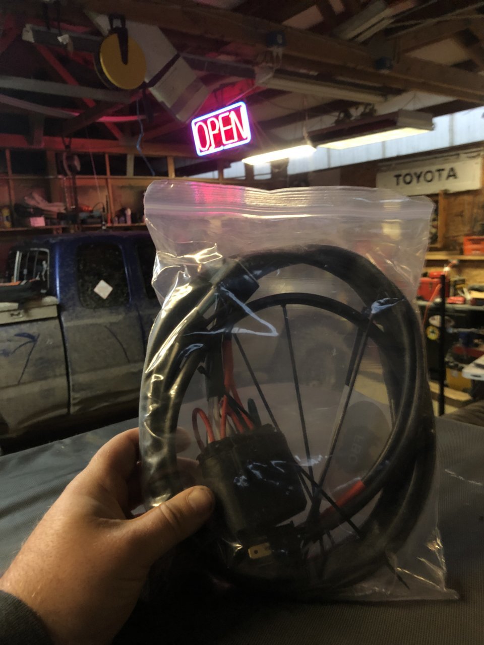

    When you guys ordered your harness from headlight services, did you guys receive a tracking number? It’s been two days and haven’t gotten an email.

    I used Paypal, and got an email from them the day after ordering that had a tracking number in it. But I never got anything from Mike.
    The Harness was delivered quite quickly for me - just a few days.

    He does all the harness stuff in addition to his day job. I waited about a week or so before he made my harness.

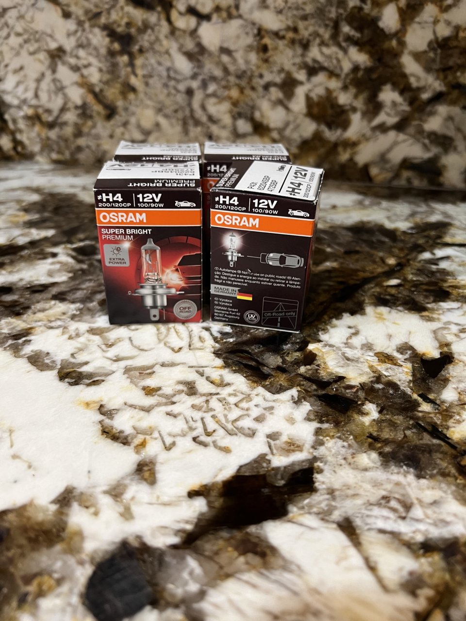

    Just got the bulbs yesterday. They came in way faster than expected shipping/delivery date given. Got here in about 5-6 business days and thank god they are ‘Made in Germany’. B7B1470C-3F1C-4F64-AB49-B5FA724E23C9.jpg

    Brother remember that if your concerns were counterfeiting that they all will be marked "Made In Germany". Not to insult your intelligence but there is a difference between actual OEM manufacturing location and counterfeited merchandise. Your boxes look like mine ordered from a known distributor and are most likely ligament. But for true peace of mind contact the manufacture and confirm your individual serial numbers.
    I remember a while back there was some dust kicked up about pretty much the same thing with NGK spark plugs. People in the know were saying "buy only from Toyota directly". Frankly, I felt like this was a lot about nothing until I look into it a bit closer. My eyes almost popped out of my head when I saw an actual counterfeit box /plugs and how indistinguishable they were from the actual OEM. I even thought the counterfeit box was sharper and better-designed graphics-wise. I could not tell the plugs apart until the difference was pointed out.
    Yet they according to the information I found, and the input from a few mechanics here was causing serious damage in the cylinders by coming apart and scaring the cylinder walls or coming in contact with the valves. The point is, we are in a new era in the sophistication of counterfeiting most anything. And being sure of what you have is always a good idea.

    There is a Chinese version of the Superbright bulb, which I think more are concerned about receiving vs convincing knock offs, depending on where you order from.
