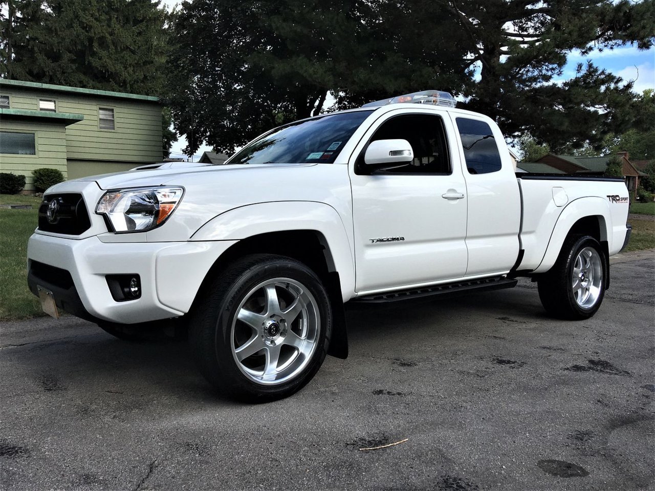

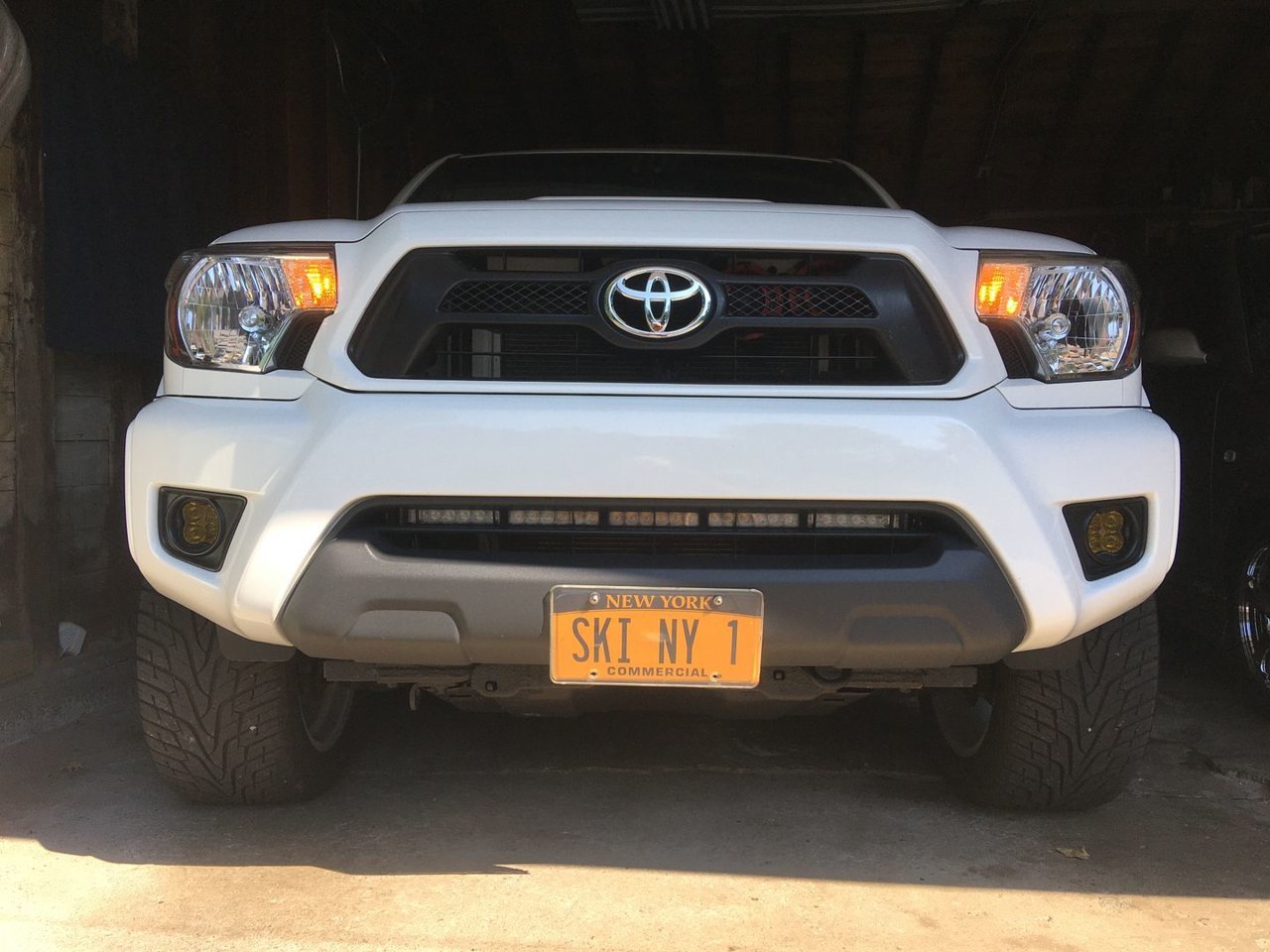

    #4208
    Too Stroked
    Too Stroked Well-Known Member
    Jan 24, 2017
    #208501
    3,924
    Tom
    South shore of Lake Ontario
    2021 4Runner SR5 Premium
    Based on the recommendations of our very own @crashnburn80, my 2014 Tacoma had the ultimate Headlight Upgrade (with the Osram Hyper bulbs that are NLA) along with Diode Dynamics SS3 Max selective yellow fogs, plus a 30" Diode Dynamics Stage all driving pattern LED bar. Man do I miss that lighting!
