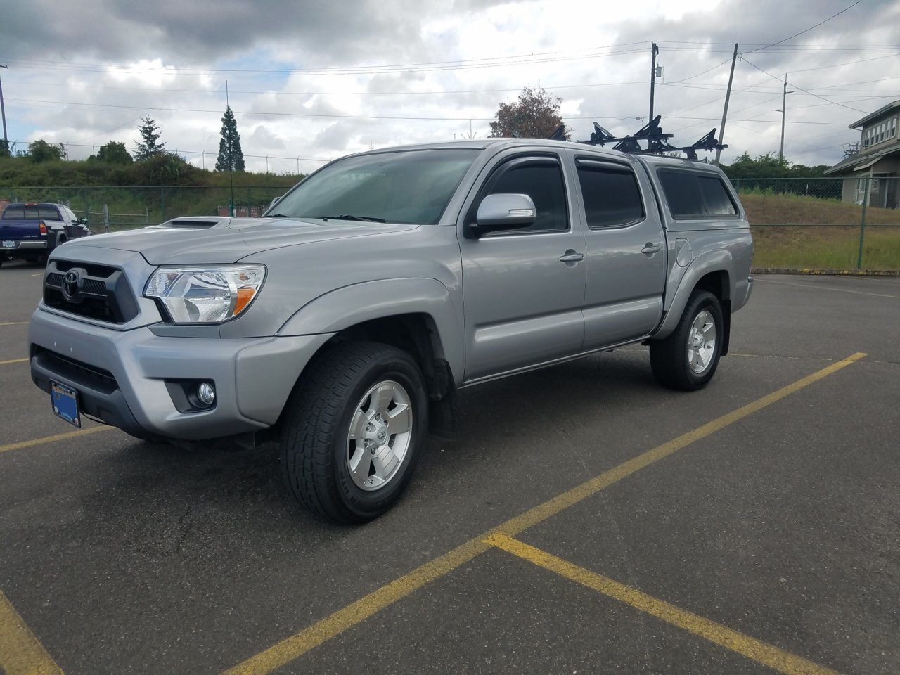

    @crashnburn80
    I'd like to put in some selective yellow fog bulbs. Any recommendations for my 2014 DCSB 4x4?
    OEM fogs now.

    The Diode Dynamics SAE SS3 LED assemblies are currently the highest performance option. But the stock H11 based fogs are quite good, if you are looking for an inexpensive bulb swap, I'd look at the H11 Nokya Hyper Yellows, or the Hella Xtreme Yellows. I have not tested these, so I cannot say if they truly fall into the legal selective yellow classification. The Nokya specs 2500k whereas the Hellas spec 2900k. Meaning in theory, the Nokyas will be a bit yellower and in theory the Hellas just slightly brighter.
