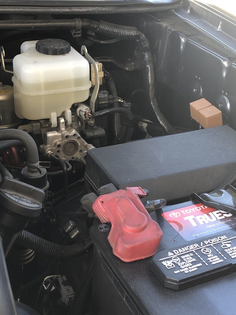

    Another ultimate headlight upgrade! Used the Headlight Services harness and Osram 90/100 W H4’s. Plug and play for the harness. I want to build a bracket to mount the relays to the open bolt holes in the engine compartment. Does anyone knows the bolt size?

    The two in the above photo are M8 x 1.25.

    Thanks HR! I'm contemplating on the Velcro attachment also.

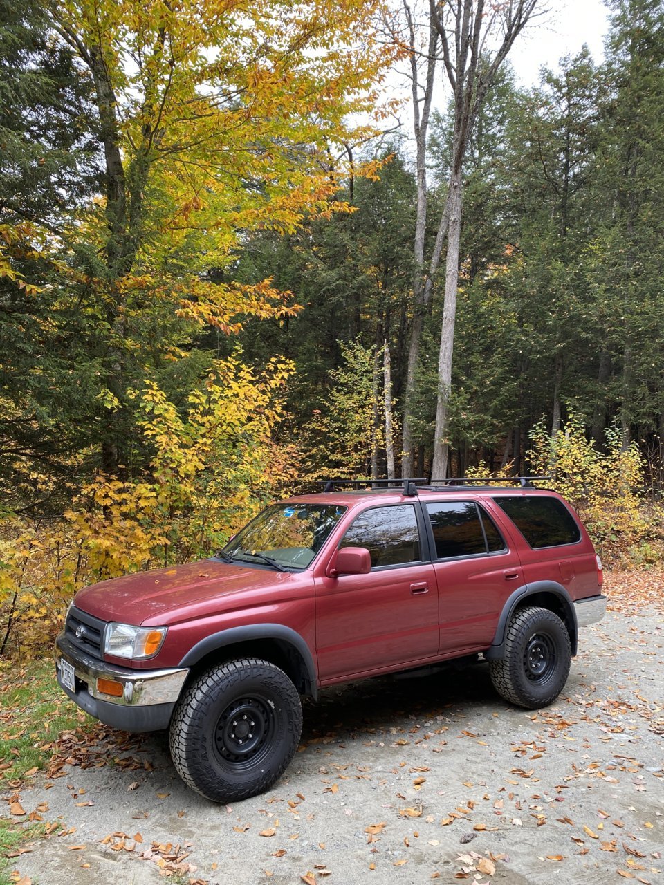

    I did this upgrade to my 3rd gen 4Runner today and wow, what a difference! The aging stock lights were truly abysmal on that thing.

    Hey, another 3rd gen 4runner guy! What year, and OEM or aftermarket lamps?

    Love my 4runner! It’s a 1997 SR5 5-speed with OEM 2000-2002 headlight housings.

    Even with the stock wiring, you're miles ahead with the fat-lip era lamps. My sister had a '97 in that same color

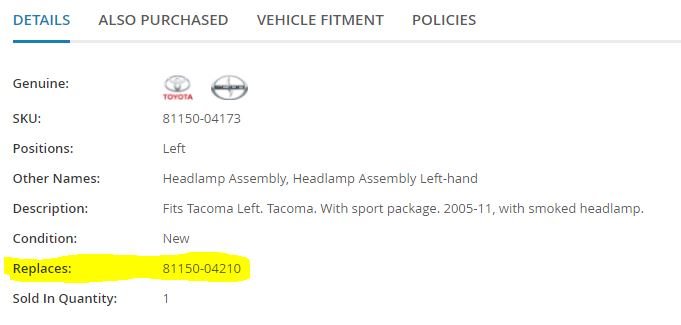

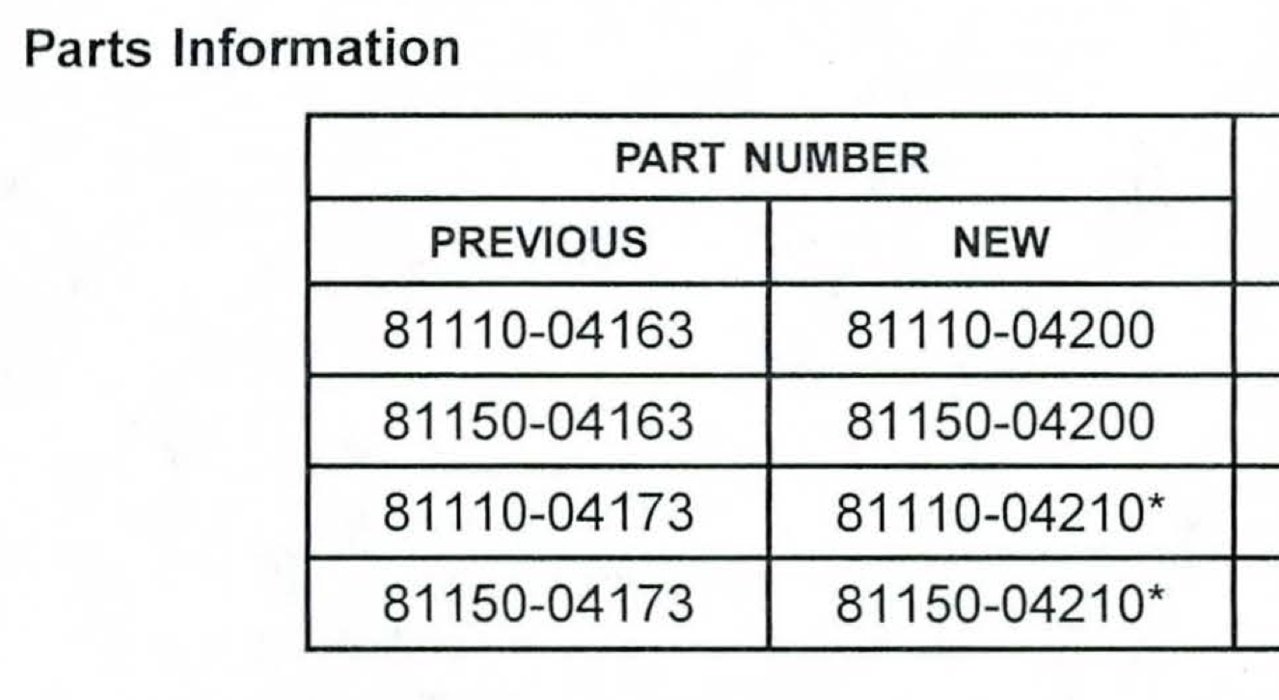

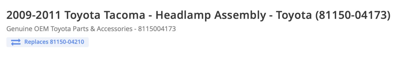

    It has just come to my attention that the links in the thread for the early 2nd Gen assemblies have been changed by the dealer to point to the Pre-TSB lights. And they list them as replacements for the post TSB lights, which is incorrect. I'm unsure of this is a parts availability thing and will need to search more when I have time.
    ^They updated the part listing to the preceding part, then listed this as the part the proceeds it?!
    Per the TSB:
    Hawapino likes this.

    That is weird but you are correct. I've been looking for 81150-4210 but cannot find it anywhere.
    Just looked at camelback site and found the following:
    crashnburn80[OP] likes this.

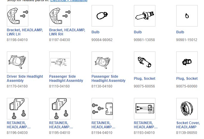

    sense we're talking about it, are the assemblies complete or should some of the other parts be orders along? (sans bulbs)

    There is a separate part number for ‘loaded’ assemblies that come complete with all bulbs. Which of course cost more.

    I was thinking like the socket cover and retainers
    I want to get a replacement set on standby with everything I might need

    Those come on all units. It is just bulbs/no bulbs that is an available difference.
