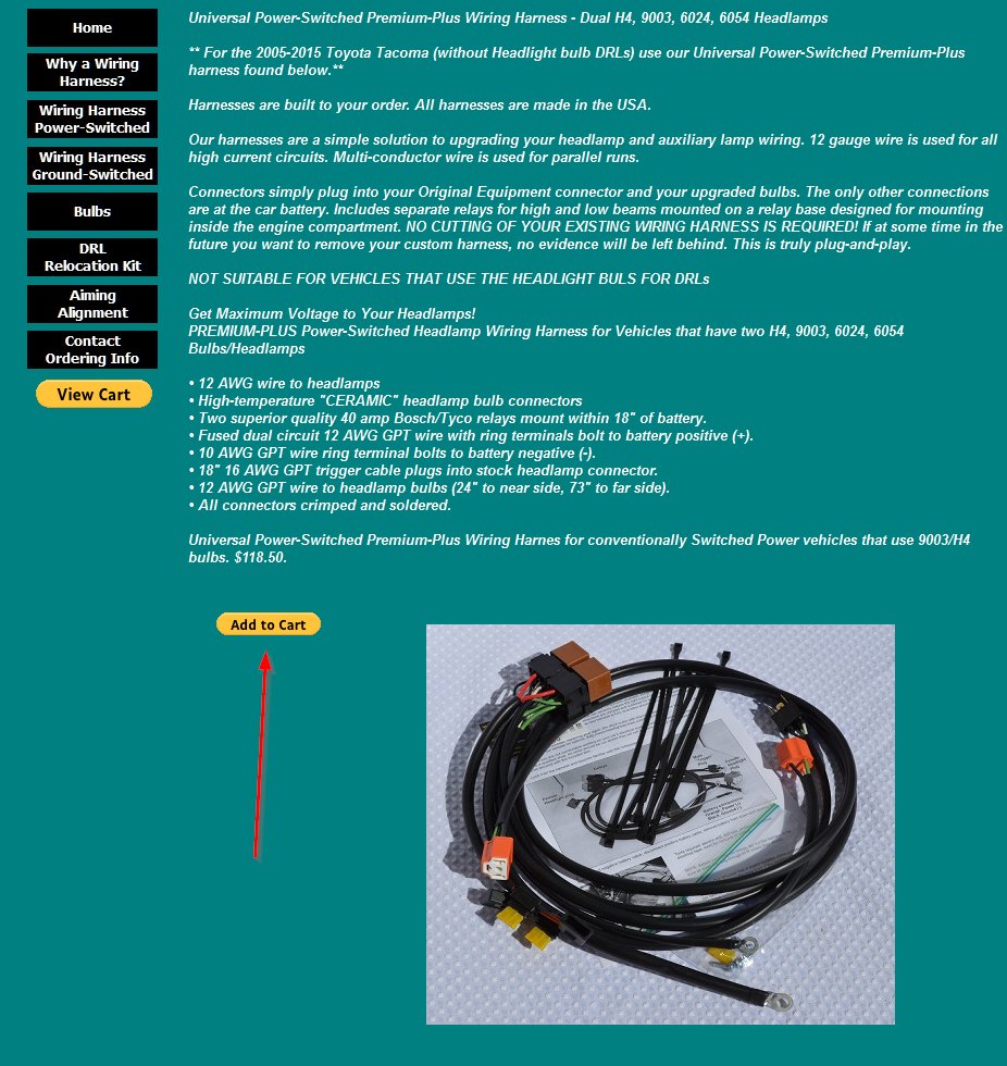

    When I click the link To the headlight services harness it takes me to the website but I can’t add anything to my cart ?? Anyone else have this issue

    works just fine for me...maybe try a different browser or clear you current.

    Ok. And for a 2015 Tacoma with DRL which harness do I need

    For my 2014 with DRL, amber and in their own separate housing, I ordered this: Premium-Plus Headlamp Wiring Harness, Power-Switched
    This one: http://www.headlightservices.com/Wiring.html
    nice to see the price has only changed $4... not bad for a great product.

    I had the same issue last spring. Try using chrome or emailing headlight services. He replied right back to me.

    If you don't see "Add to Cart" it's time to dump your internet temp files in whatever browser you're using.

    Thanks guys. Ended up contacting him directly and he got me squared away.

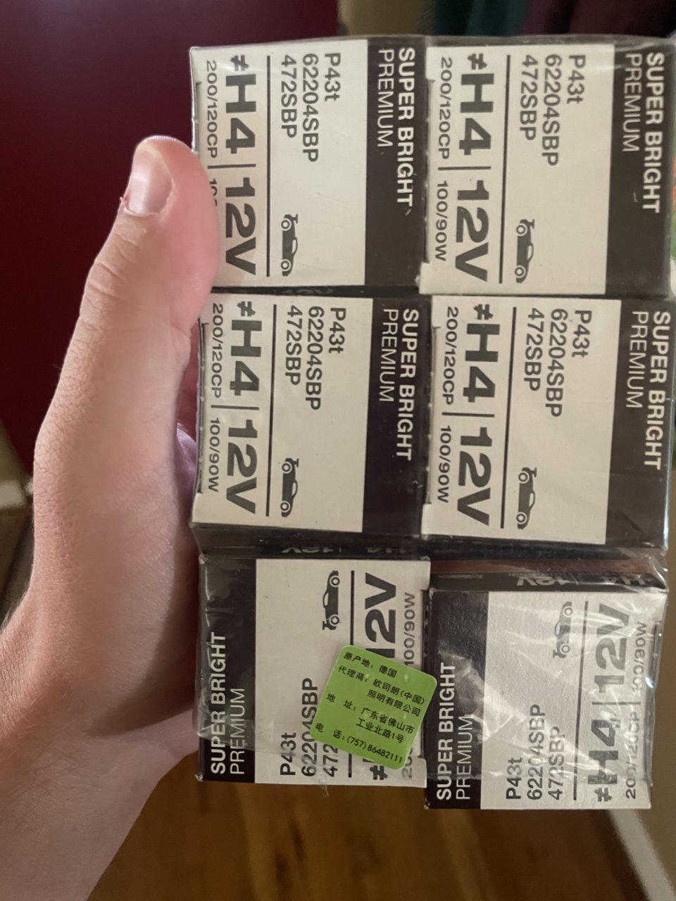

    that green label is some funny looking German

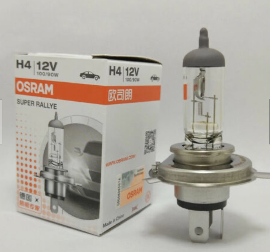

    Where'd you purchase from? I believe there is a made in china version of the bulb.

    The bulb America link just above

    Hmm. Last time the bulbs were in stock there they were German. What does the box look like?
    China ones have a white box
    German ones should have a red box
    Even then though I wouldn't necessarily trust the box color. If you open one up the country of origin will be stamped on the bulb.

    Place of Origin: German Agent; OSRAM) [Wu Ming Dao Co., Ltd. Address: No. 1 Industrial North Road, Foshan City, Guangdong Province: (757) 86482111 225

    Maybe BulbAmerica imported German bulbs out of China. Certainly possible.

    You can just email osram. I did and they were super helpful identifying mine as legit. I ordered mine from eBay previously.
