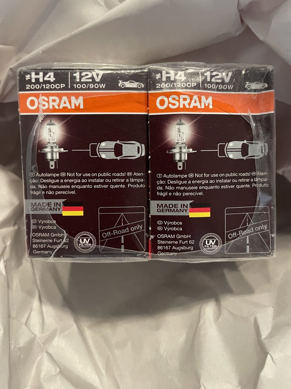

    I’ll post some more in a bit. It’s red box. The bulb says Germany on it. Wild to think how a bulb is designed in Germany potently made in China and then sold in the US

    Osram has German and China manufacturing facilities, as does Philips. Hella contracts out to both Korea and China. The German made bulbs are also available in China in addition to their domestically produced ones.
    My bet is supply chains are a mess, product availability on those has been spotty, the vendor has been out of stock for a while and likely found some German bulbs to import from China instead of Europe.

    I ordered some also and the boxes from the new ones match perfectly with the boxes from the ones I bought 2 or 3 years ago.
