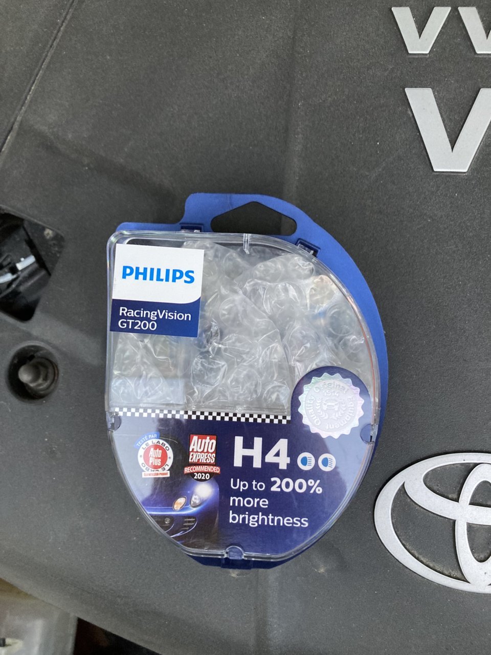

    Look what just showed up! I’ll be installing tomorrow for proper setting.AC30E101-F480-43B1-8076-3249343418A6.jpg
    dirtnsmores and crashnburn80[OP] like this.
