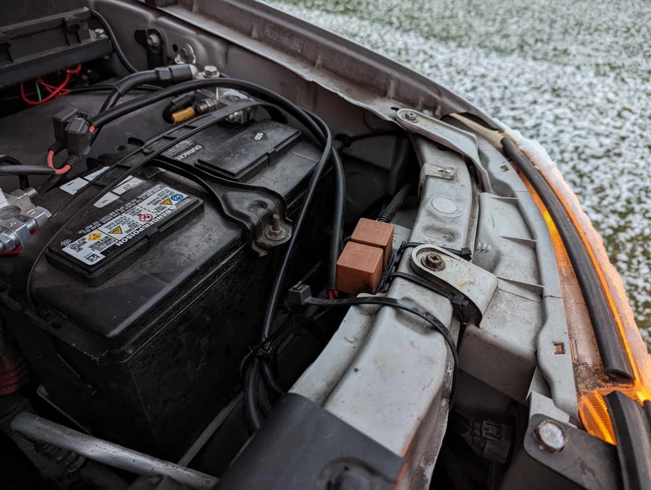

    My harness just arrived. Looking forward to installing it this weekend. Where did you mount the relays?
    crashnburn80[OP] likes this.
  3. Nov 17, 2022 at 3:30 AM
    #4603
    blur
    blur Well-Known Member
    Aug 1, 2012
    #83879
    206
    I mounted mine right next to the spot on the rail with female threads.
  4. Nov 17, 2022 at 4:10 AM
    #4604
    elricfate
    elricfate Well-Known Member
    Nov 26, 2019
    #311771
    867
    2009 Tacoma AC Silver Mica
    High, away from heat as much as possible, and always in sight so they're easy to remember. I also used zip-ties to affix just because it was quick and easy.
