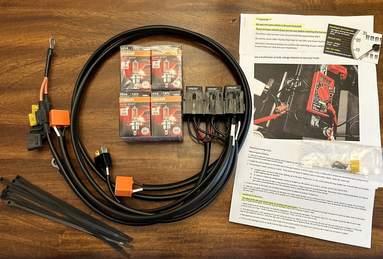

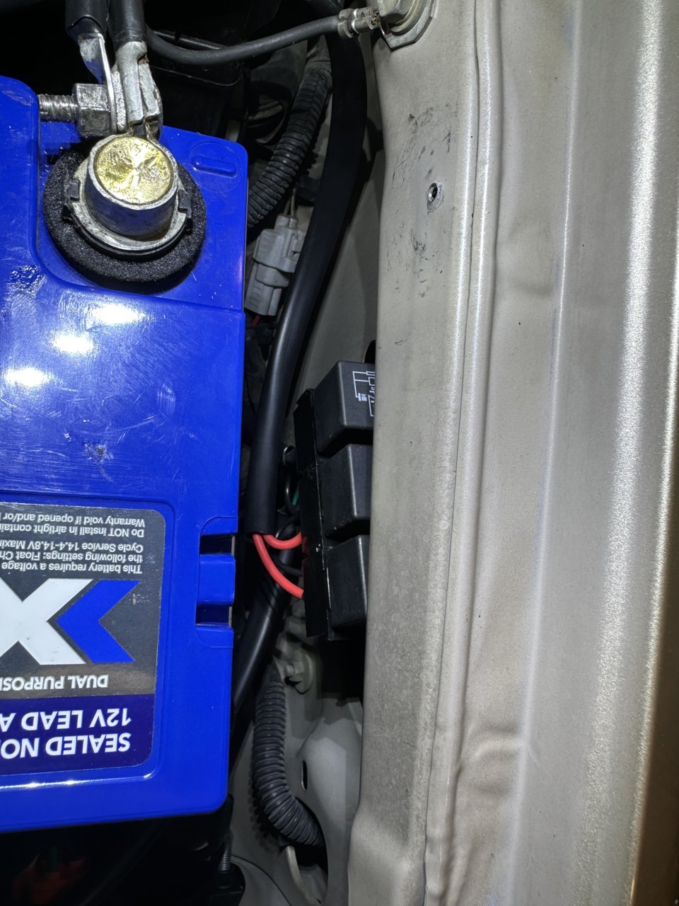

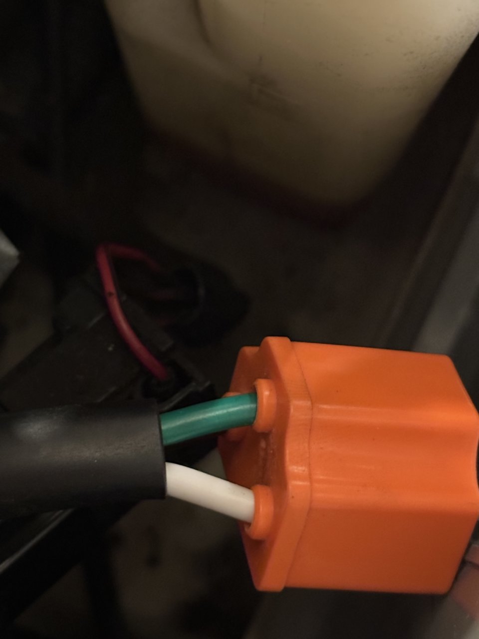

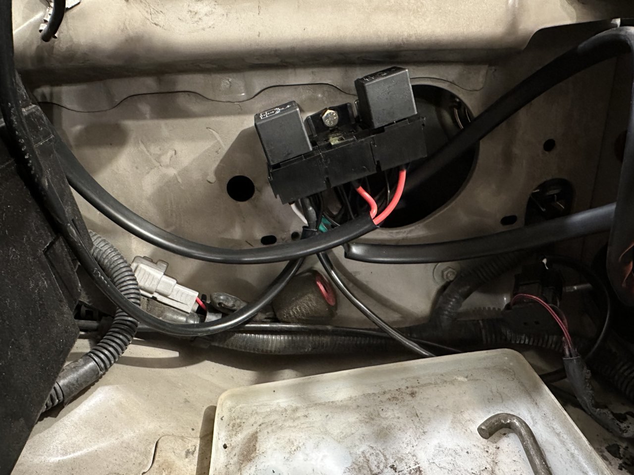

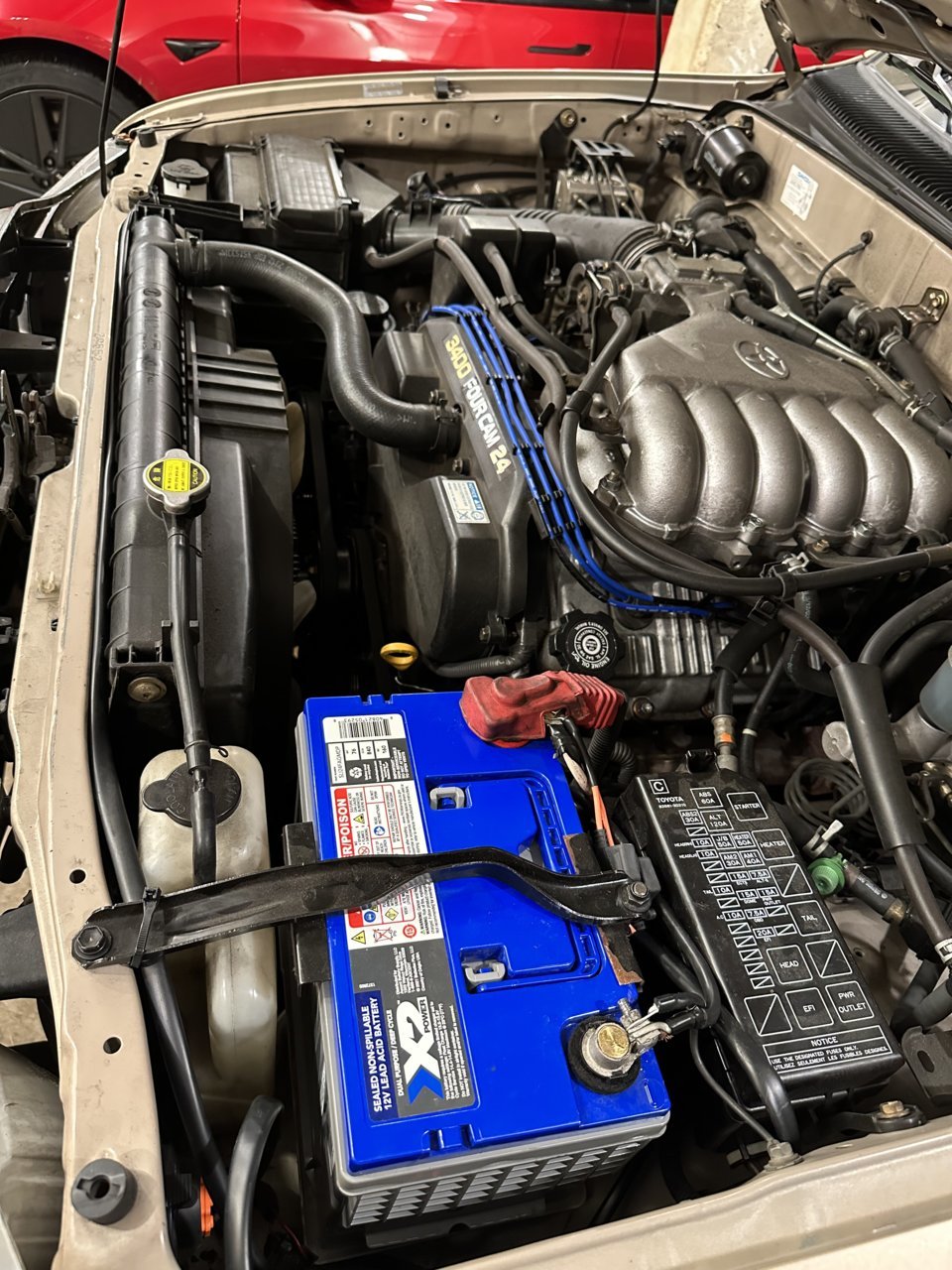

    Cross post from my build thread.
    Installing this upgrade on my 1st Gen. I had Headlight Services make me a custom length harness based on my measurements sized to the 1st Gen. We reduced 30" off the harness length in optimizing the design specifically for the 1st Gen, and in high performance harnesses the shorter the harnesses the better the performance while also providing a cleaner install. I also picked up 4 of the Superbrights from Headlight Services as well. As these bulbs are not readily available in local stores, you should ideally have a spare set on hand.
    Exceptional build quality. Looks like my headlight thread made the cover on the install instructions. Compared to my earlier review in post #1262, relays for the ground switched units have switched from Bosch to Picker relays due to supply chain issues.
    The headlight wiring guage comparison on a 1st Gen is a massive difference.
    Removing the battery, there are plenty of unused holes in the fender to hard mount the relays. Simple bolt with washers and nut on the other side then reinstalling the relay afterward.
    There is enough room to remove/replace the relays on the fender without removing the battery.
    Ran the wiring up and over the radiator with zip ties on either side to keep it in-place.
    I was conservative on the passenger side wire length and ended up keeping it longer than necessary. It is 6" shorter than spec, but could still be a bit shorter. Otherwise the wiring length reductions were great to eliminate unnecessary wire and further reduce voltage drop.
    This lighting upgrade is paired with the Northstar AGM + HKB voltage booster upgrade plus new OEM housings for maximum performance gains.
