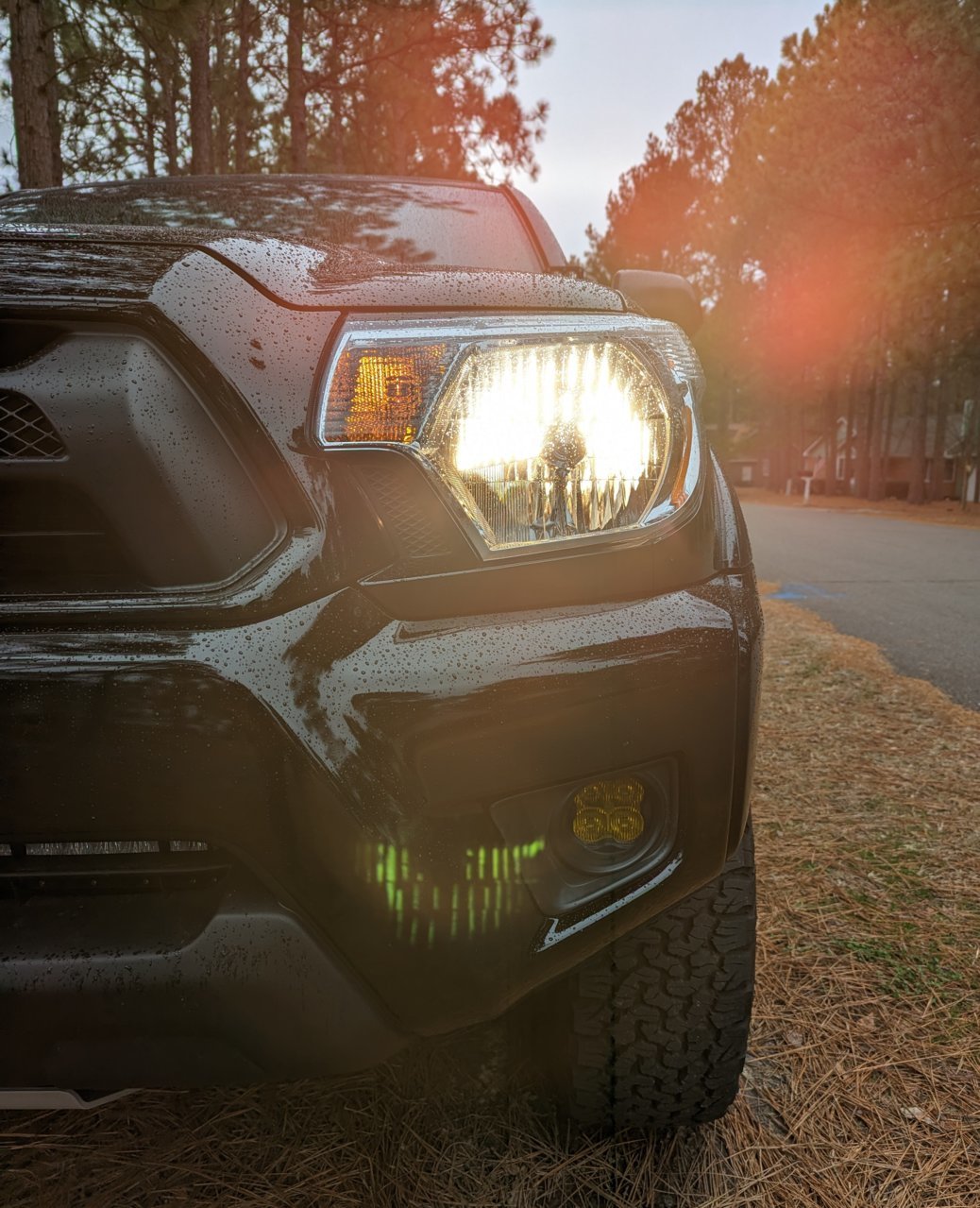

    Been running the HD harness for over a year now with Philips Racing Vision bulbs and have been very pleased with the low beam output and color of them. I figured the harness would allow every bit of available wattage to the bulbs due to less resistance from subpar factory wiring. I've been getting a year's worth of life out of these bulbs down to the month. My driver's side bulb went out the other day and I know the passenger side was likely right behind it. I decided to install the Osram Super Bright 110/90W bulbs that I bought with the harness but have been reluctant to use. We'll see how they compare later tonight when I use them. They are definitely a warmer white than the Philips which I don't like, but if the output is better than I'm fine with that. My headlight housings are OEM that I replaced about a year and a half ago. According to @crashnburn80 this should be the ideal setup. I'll try to get a night shot of the headlights soon.

    Running the harness will boost performance even on stock wattage bulbs. Both those provide great low beam. The high beam on the Osrams though will be substantially better than the Philips. Curious to hear your thoughts after testing it out.
    If your Racing Visions were the +150, those are rated at 200 hours just like the Osrams. I’d get exactly a year out of mine as well. The Racing Vision +200 are not any better performing in terms of output but do have an improved 400 hour life span.

    Here's an unfiltered nighttime shot of the Osram 100/90W with the HD harness and OEM headlights traveling about 25 mph. I have to say that the picture doesn't do this justice. The light output is excellent, and the shadowing is very minimal. The Philips Racing Vision +150 are really good also and I would run them again if I needed to, but they still don't compare to these, especially the high beams. Two thumbs up to @crashnburn80 for sharing this upgrade to everyone. The HD harness is well worth the money.
