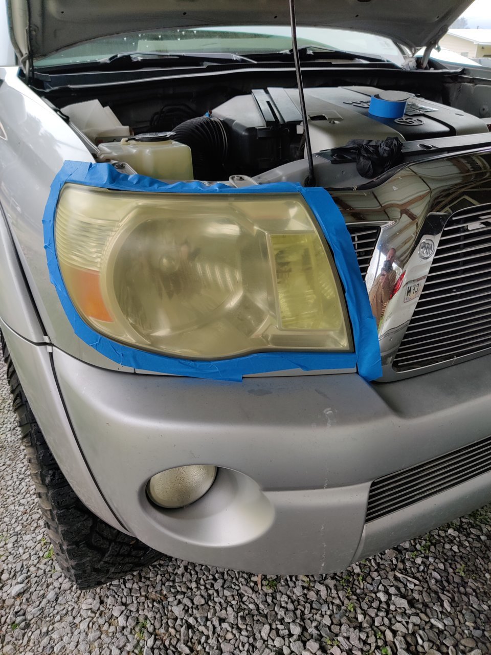

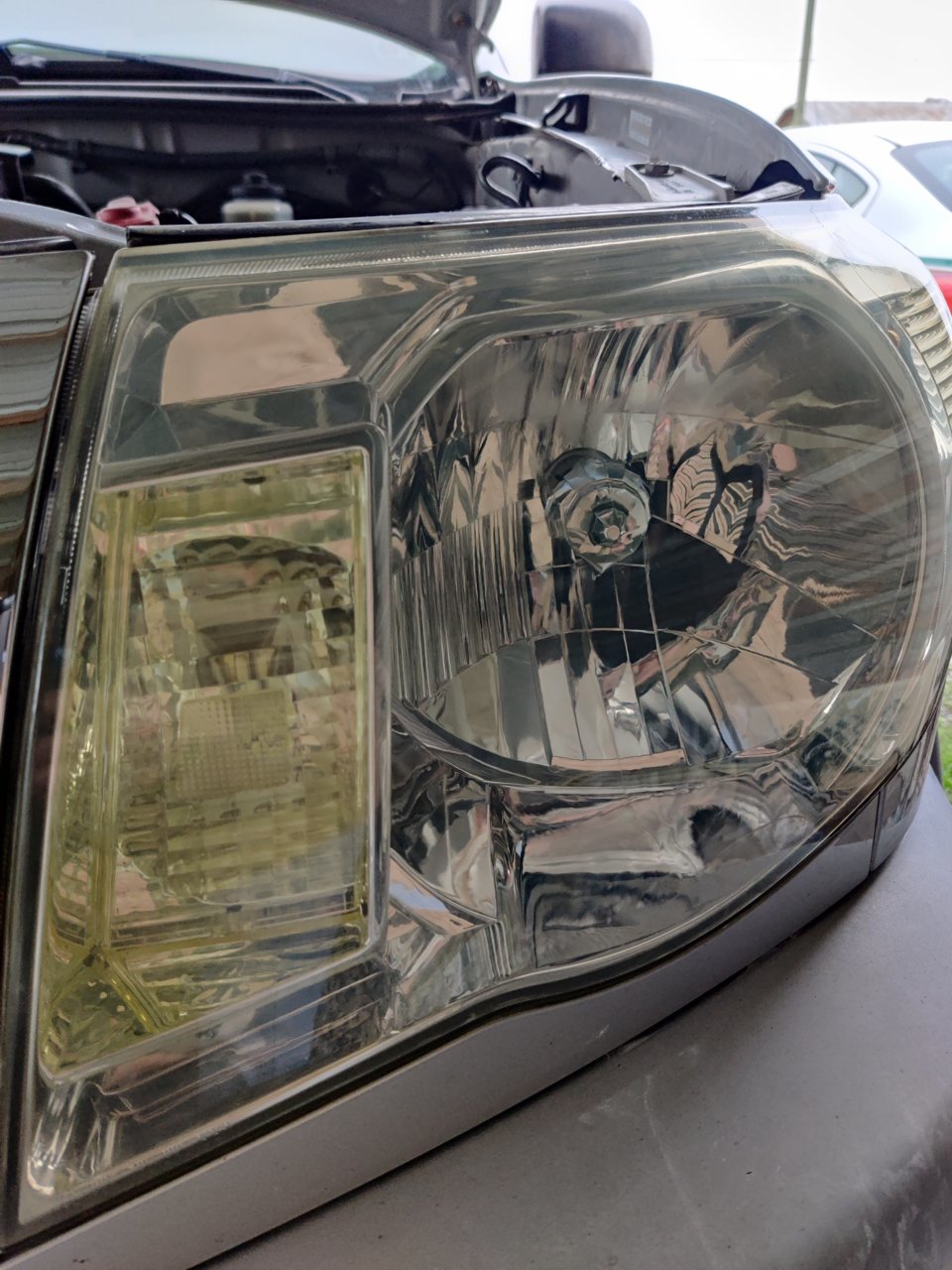

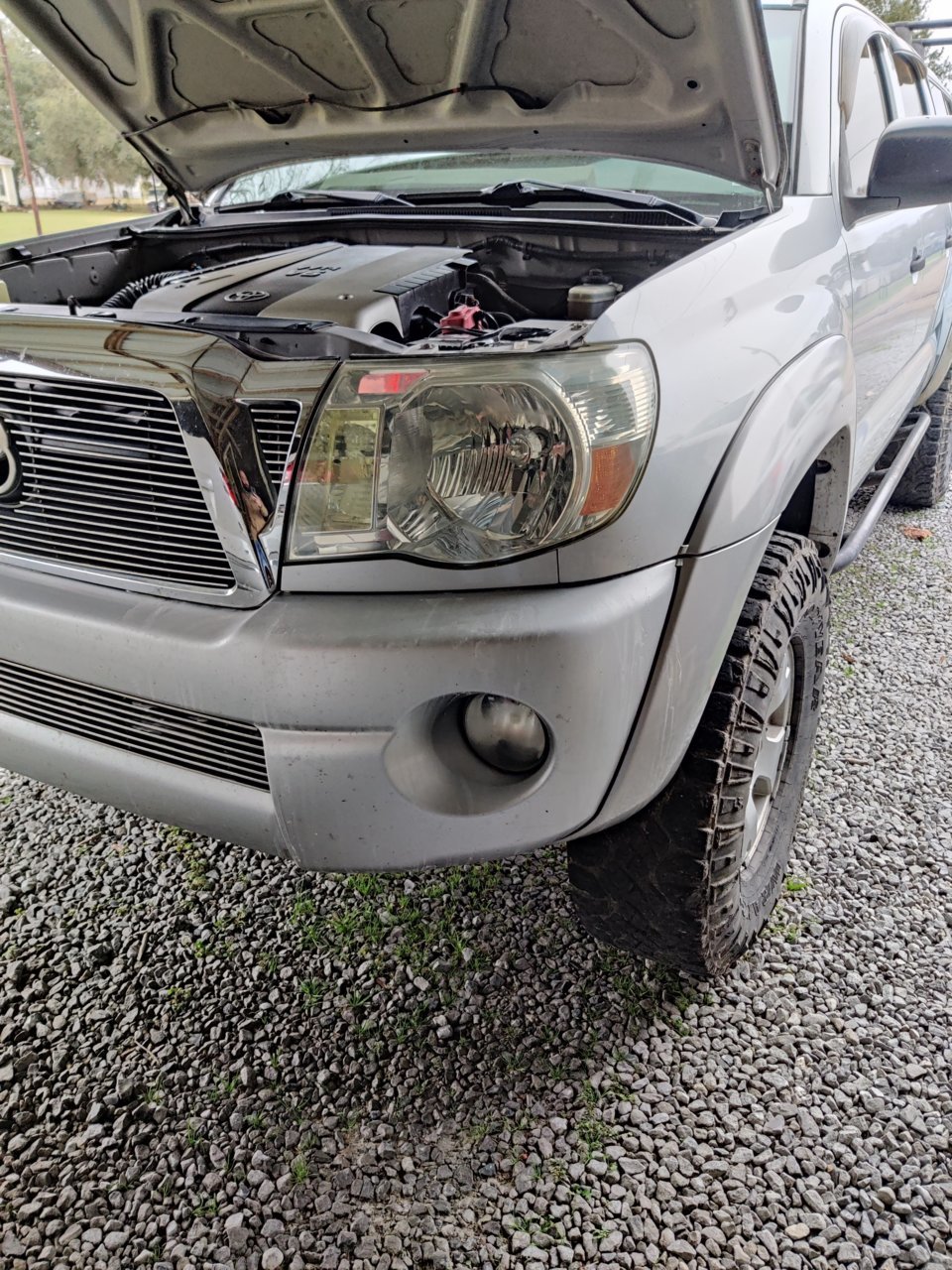

    Oh and dressed up my existing headlights.
    So still trouble shooting my "no cutoff" lighting issue.
    Just FYI I'm running stock bubls until my harness arrives, I know people were worried about the osarm higher wattage bulbs I was attempting to aim with.

    Much improved. What are you using to protect from immediate UV degradation?
