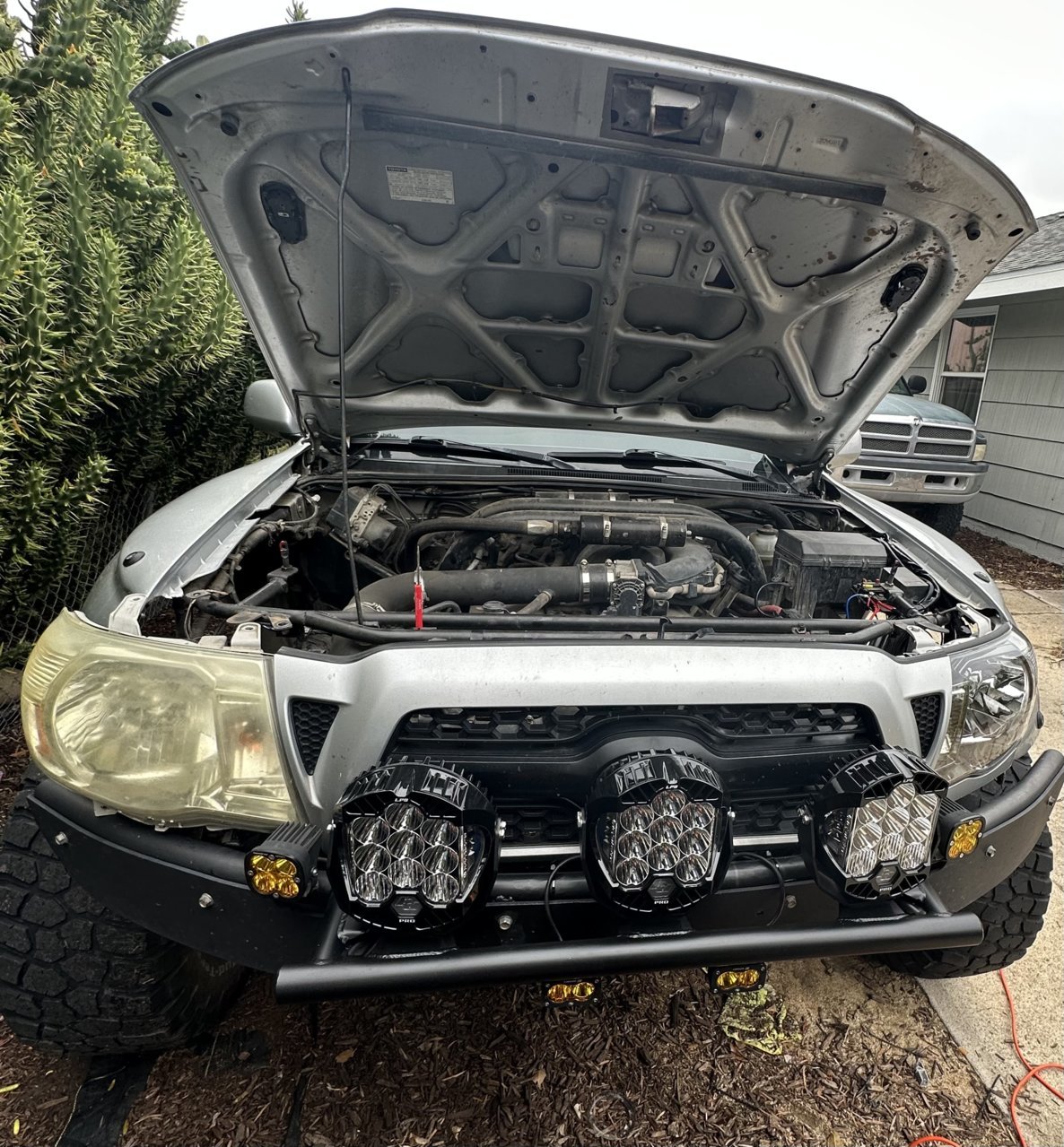

    finished doing the mod to my 2011, so much better than the leds I had in it.
    239EFB83-3A18-4E70-A13D-B470E1D18278.jpg D1B1AA0C-8A00-4A21-8454-5DC920485401.jpg
