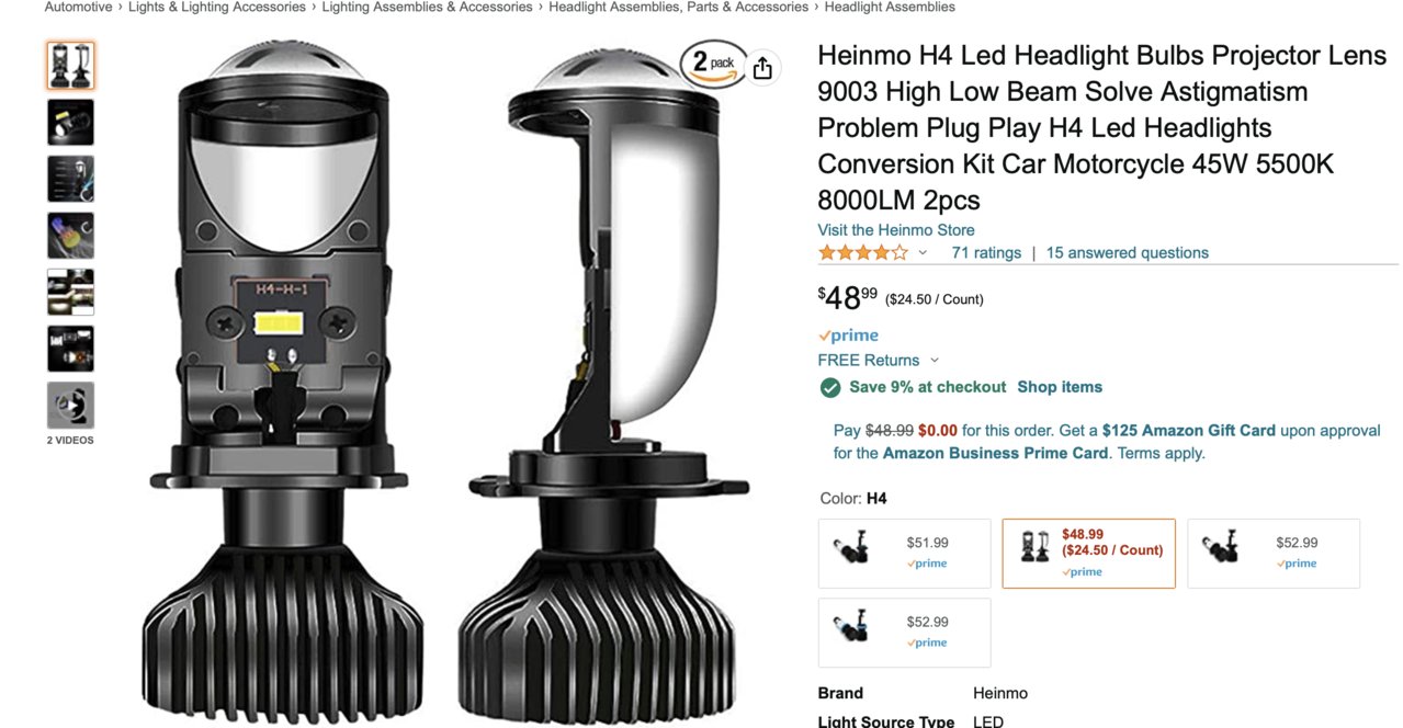

    Crash, any intent to test and see how bad these mini-projector LEDs that fit in place of a H4?
    I'm sure they are garbage but are they hot garbage?
    I saw a video of one that looks like it actually had some up light, so I got a little curious

    Pretty sure I know the product you are talking about, cause I’ve seen it make the rounds lately. But the concept isn’t new, it’s been around before, just has another new push on an old failed idea. But got a link?

    Assuming you are talking about this
    How well is that going to work with a glare guard in an H4 headlight, directly in-front of the "projector"?
    Shown with a bi-directional LED failing to illuminate the entire housing. That glare guard is going to result in direct obstruction and near-zero output. So you'll need to bake your headlights, remove the lenses and do a sudo retrofit to remove the glare guard then try to reseal it all in order to run some absolutely awful fake projectors. If you are going through that effort level, just do the real thing.
    These products are just another Chinese snake-oil product praying on those that don't know better. Its going to be garbage, even if you go thought the sudo-retrofit efforts to remove the glare guards. Stick to products from actual reputable lighting manufactures for real performance gains.

    that's the style I saw
    not looking for myself, I like having snow melting functionality

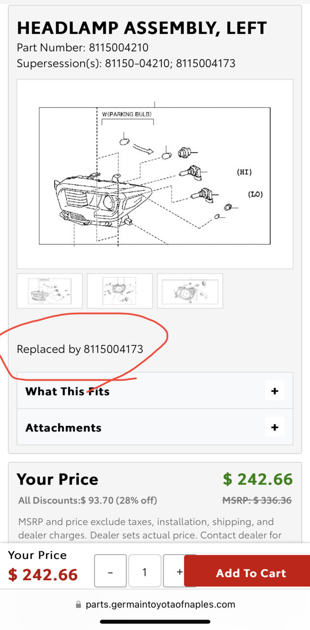

    CraigF likes this.
  14. Mar 14, 2023 at 6:38 AM
    #4794
    crashnburn80
    crashnburn80 [OP] Vehicle Design Engineer
    Jun 6, 2015
    #156893
    14,770
    Kirkland, WA
    2003 DCSB TRD OR
    Unfortunately that does not look to be the case. Correct new part number is listed at the top, with old part numbers as superseded, but then at the bottom it says this part has been replaced by the old part.
