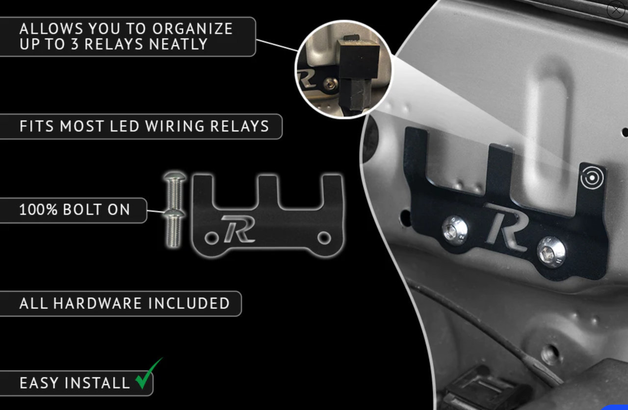

    Speaking of, anyone have cool tricks on relay mounting for these HS harnesses? I am zip tying right now, behind the fuse box. There are good fender threads right there but the relay plastic hole is tiny, I'd need to do some sort of bracket to adapt it, small bolt on the relays and then the Mwhatever for the fender (12 maybe?)
    308savage likes this.

    I just ran a self tapper into the fender with one of the mount and then ziptied the wiring up out of the way where I could.
    daveeasa likes this.

    Can you use a Rago Fab relay holder? I think I’ve got one in the garage that I never used.
  20. Apr 28, 2023 at 1:33 PM
    #4820
    daveeasa
    daveeasa FBC Harness Solutions
    May 14, 2020
    #328079
    7,483
    David
    PNW
    2016 Tacoma OR DCSB 6MT, 2005 RC 5MT PreRunner, 2002 Tundra SR5 RCLB 4x4
    ^^ yeah, I have one in one of my bins and was thinking I’d try to locate it. Not sure it holds those suckers though.
