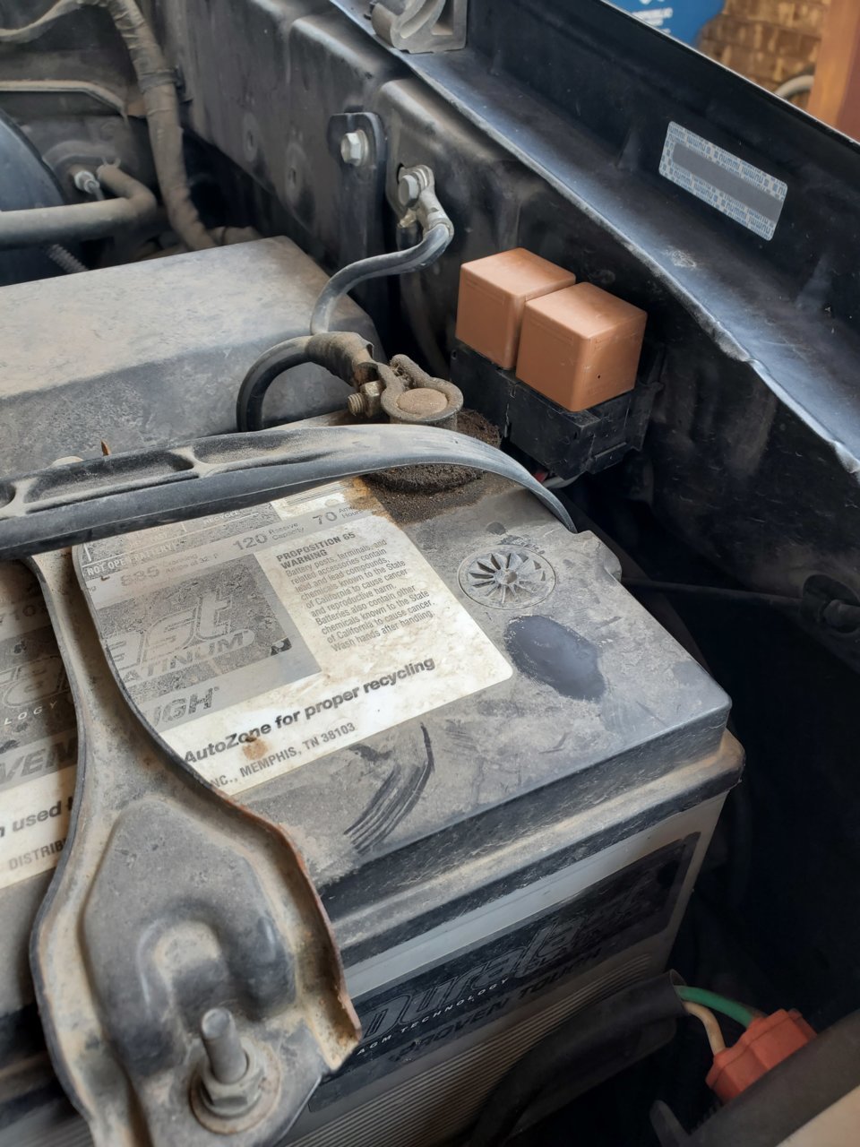

    That may be why I never used it! I’ll have to check later.

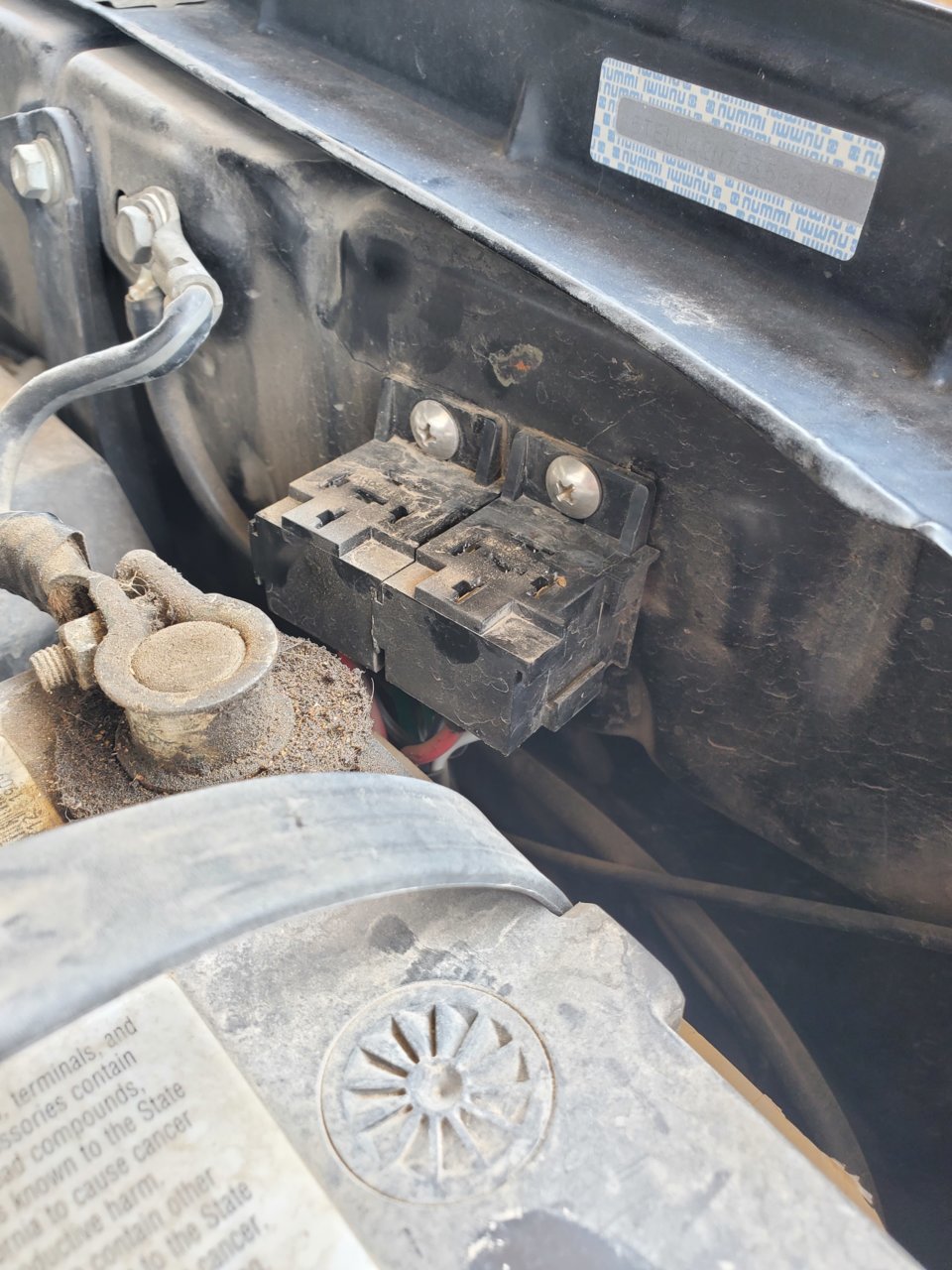

    Really curious about whether the Rago bracket fits the relays too. I mounted my wire harness last year with zip ties near the front just behind the grill, and I just found some of the wires have had their insulation rubbed through from contacting a metal panel edge. Looks like I need to buy a new harness and do a more robust installation.

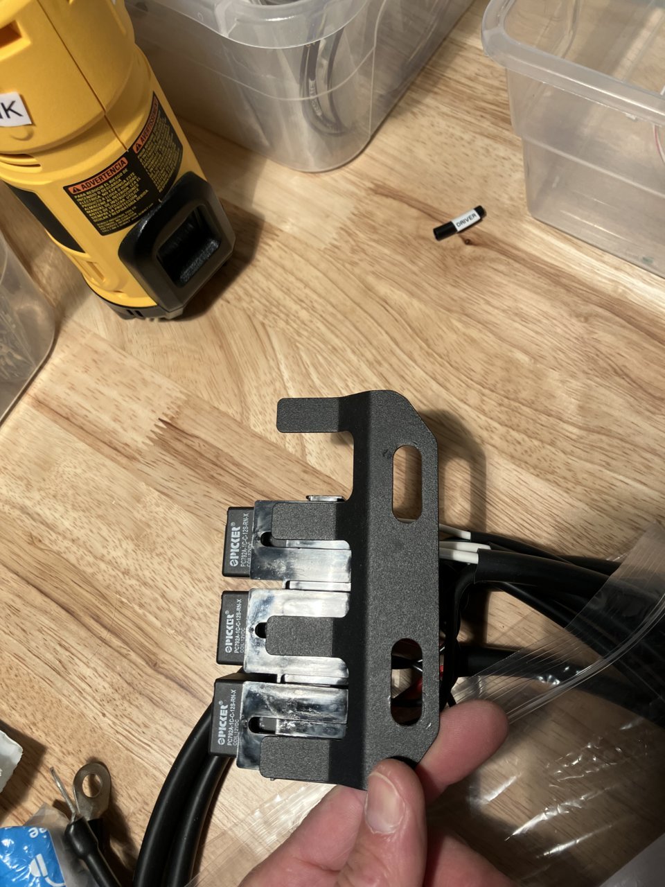

    OK, ok, I'll go hunt for my relay bracket, should have done that days ago... :)

    No super clean option but I could see an intermediate adapter marrying the two together.

    Actually, I see it now. Granted this harness is for my '02 Tundra which is ground switched, but this plan may work fine for the 2 relay power switched version too.
    I'll cut a small slot into the plastic relay connector on each side near the back. I think dremel with a wheel should work.
    Then I'll fill the void between the 4 tines of the fork with one relay each so that the tine fits into the slot.
    I think that'll do nicely if I don't mangle it all up. The alternative is a new set of relay connectors which slide right onto the tines if I can locate the proper part. De-pinning these relay connectors isn't hard to do so if I can source it that may be the preferred route.
    Regardless, the slide together part isn't really compatible with this relay mounting bracket.

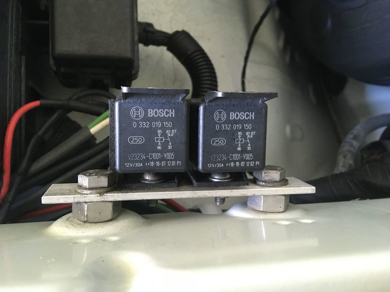

    This is all I did for my 2014. Not very elegant, but it worked perfectly.

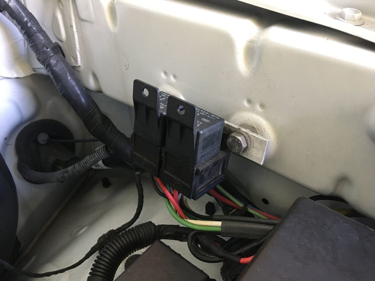

    This is what I came up with on my '08. I used some left over Subaru screws to attach.

    By chance, do you know what bolt (thread count/ pitch) those existing holes take? I have my parts on the bench now for this swap, and I like the simple clean mounting you came up with for the relay.
