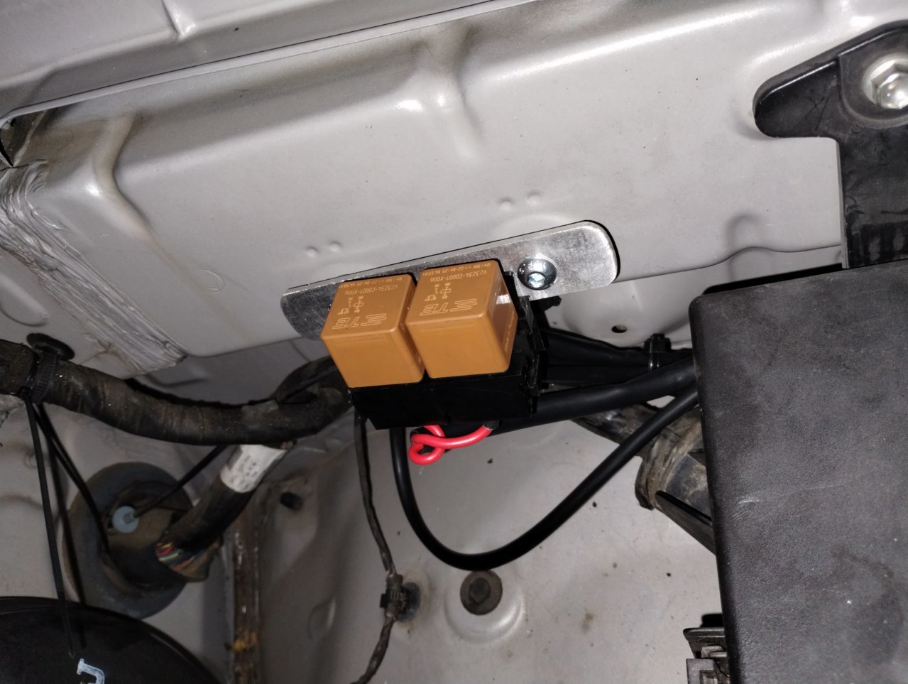

    Put it in today.
    Used a piece of aluminum to attach to bolt holes on the side.
