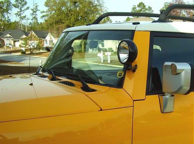

    Volunteering a project for someone to do, figure out product install then DIY
    A-pillar police spotlight
    it can be pointed anywhere you want and looks BadAss
    you might even be able to find it cheap used
    and maybe even mount whatever Pod you want on it
    you know you want to
    according to Unity website they even have a 6" HID version with Millions of lumens

    I used to work on cop cars. Those really arent to difficult ro install. The bigggest problems they encountered was the fat cops used them to pull themselves out of rhe car. Shorting them internally in a bent stalk. Just an fyi user advise
