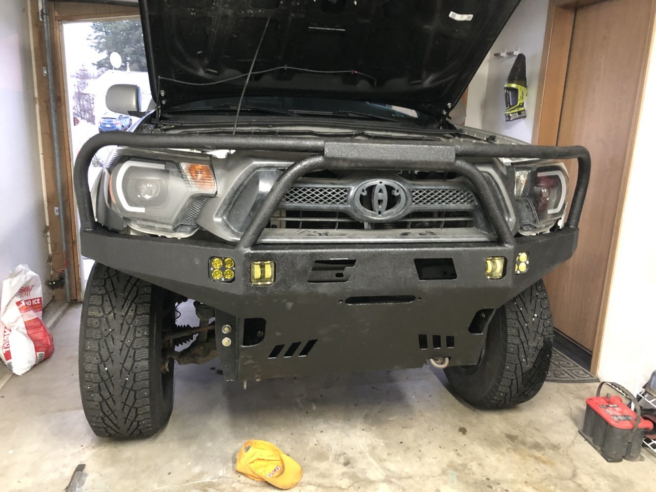

    Howdy folks, I’m hoping to get some opinions here. I’m thinking about upgrading my headlights before winter and I want to run the upgraded harness and high output bulbs, although I am definitely not willing to drop the money on some oem housings. What I am considering is getting some cheap Amazon headlights and applying some sealant and a protective coating to the lenses.
    I would like to replicate the look of the pro headlights with the light smoke look. What I’m having trouble deciding is wether it would be better to get some headlights that are already smoked, and then apply a clear lense protector, or get a clear headlight and apply a smoked film to it. My main concern in either case is that I don’t want the smoke effect to be too dark, and a film can be removed if necessary. Here are the smoked headlights I’m looking at, though the photos look like they just have the headlights photoshopped in, so they aren’t very useful haha. BDC7E0D0-7575-493B-A282-973FED633742.png
    Also, here are the headlights I have currently. The light output is really bad, even with higher output halogen bulbs. I was considering trying the upgraded harness on these housings, but I think that might be a bad idea. These projectors are just garbage (big surprise lol).
    Thanks in advance for any input. I can already anticipate people saying to save up for oem housings, and while that is good advice, im definitely not gunna go that route. I would just rather make a cheap part last as long as possible, for the sake of experimenting as well as saving money. Thanks y'all!

    I will of course say OEM assemblies are the best and the preferred route. But if that is completely not an option, you might look at a brand like Depo that offers the assemblies with blacked out interior trim. There are no aftermarket assemblies that I am aware of that replicate the exact look of the smoked chrome on the TRD units. Note that the TRD slights use a smoked chrome reflector, so the outer lens of the lamp remains clear so all the light can pass though. You do not want to put a smoked film on a headlamp as you propose as that will significantly reduce output. I'd advise against all stick-on films in general on headlights, as even the clear ones reduce focus and output, and sometimes removal of the film can cause as much damage as the film was trying to protect against in the first place.
    Yes, those Spyder style headlights will be awful no matter what you put in them, the projectors are garbage so best to abandon those.
    Curious, what are those center pods on your truck?

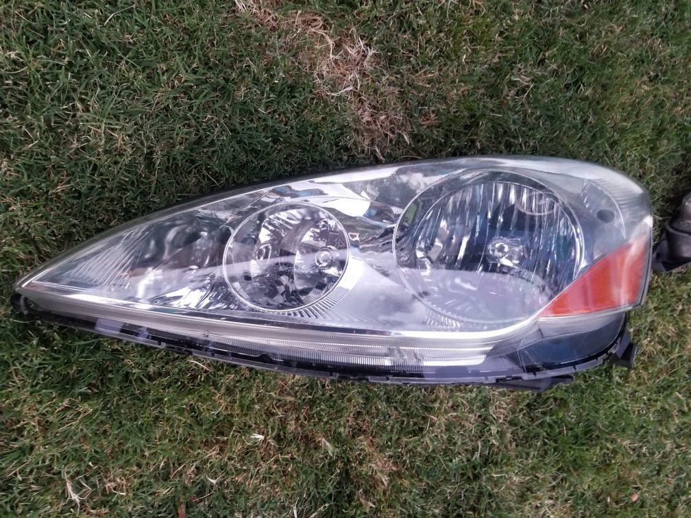

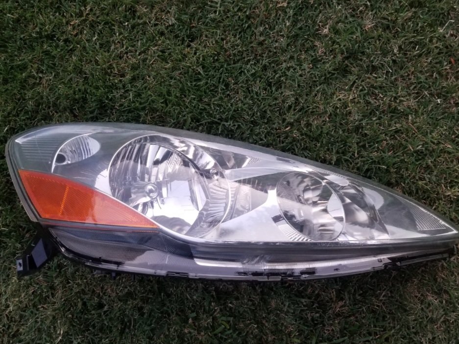

    I bought a USC Spray Max 2k clear with plans to use it on my new set of Tacoma lens'. I was having my sienna hood repainted so I went ahead and had them clear coated instead
    Paid $35
    sell for $25 shipped - Venmo

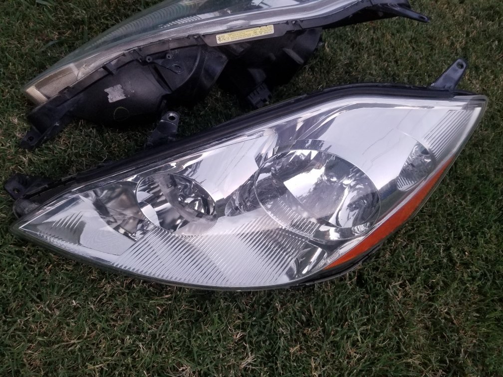

    Not the Tacoma yet but I had both the new hid and the original prepped and sprayed clearcoated for my Sienna. Turned out nice
    Resized_20230922_190633.jpg Resized_20230922_190722.jpg Resized_20230922_190741.jpg

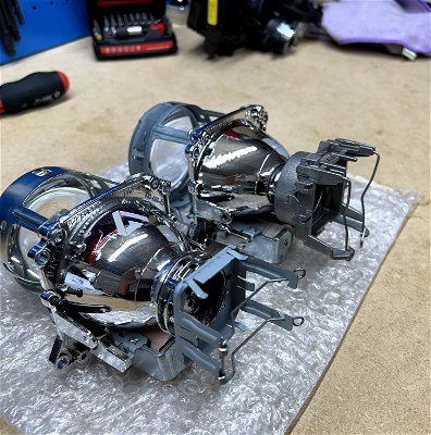

    Are you saying there's no good options for HID, whether from an individual seller, DIY, or company?
    I only say this because although I do have headlight harness and brighter bulbs,
    it is still not as good as my last vehicle
    In that case, it did take mods.
    -remove burnt 3" bi-xenon OEM projector, replace with Bosch/AL Gen2/3 'E46' (I believe also 3") that can cheaply be sourced from many newer vehicles that come with it including Aston Martin, Jeep Grand Cherokee, Audi R8, Audi B8, Fiat, and more
    gen2 has visible horizontal line in the middle, gen3 has a bunch of dots speckled on it
    -upgrade cheap regular D1S bulb to Osram CBI or competitor
    -paint cutoff shield black for crisper cutoff
    -swap in TRS/TheRetrofitSource clear lens
    -use non-AFS/corner swiveling version
    that setup was amazing
    I know on HIDplanet there are certain other projectors held in high regard as sought-after to retrofit, I believe:
    -S2000
    -Acura gem eyes
    -Prius LED
    -Acura TL
    I just typed in Tacoma in search bar of HIDplanet to see what people are doing and surprisingly, it appears not one person on their has retrofitted a 2nd gen
    If Audi had good parts ~2001-2012, then after that must be even better
    but would be much more difficult to retrofit in terms of LED, power use monitoring for bulb out warning
    and newer year means less reliable
    1. lots more parts in LED, including fans, control modules
    2. no repair serviceability; headlight is integrated. Tiny part fails in a year, $1000, throw it out
