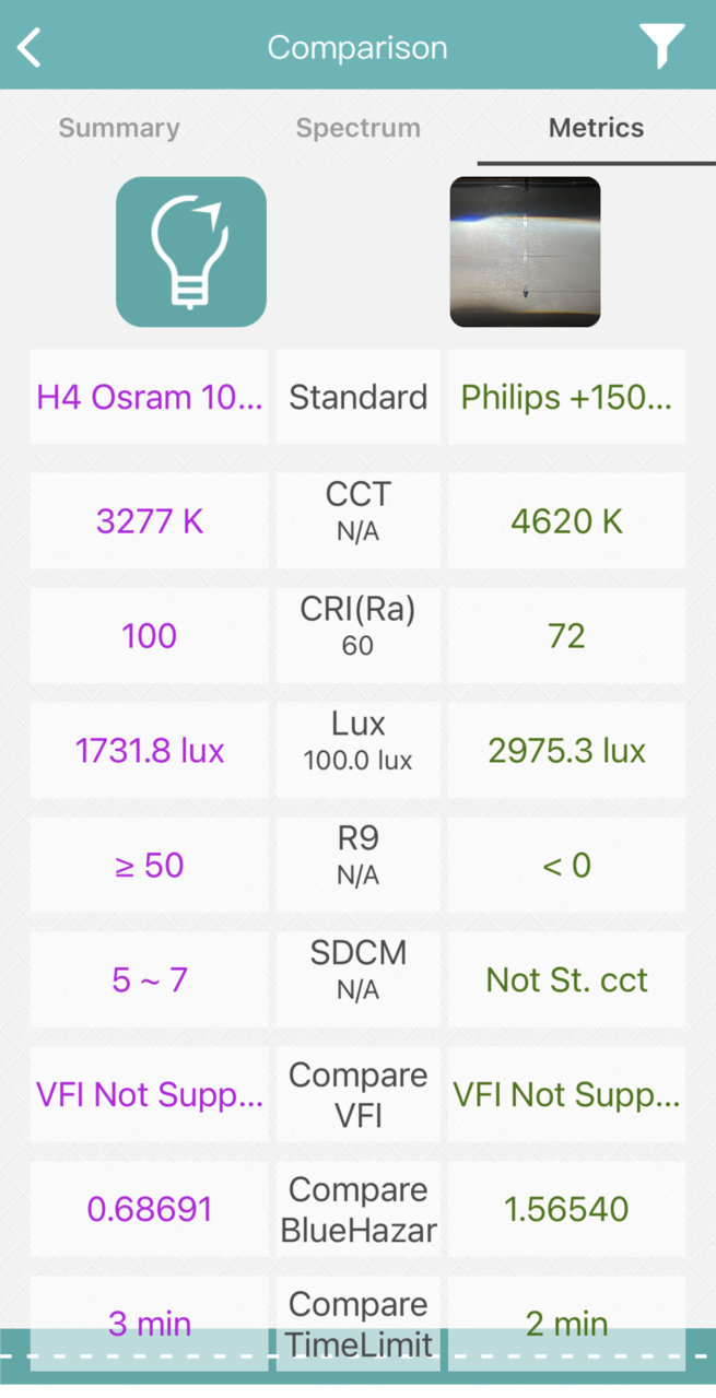

    The RX350 is widely regarded as one of the best performing projectors, especially for its smaller foot print. You'll notice in retrofitting a lot of what is easy or common is also complete garbage. Mini H1 which is a common go-to for retrofitters is a complete joke. It is a halogen Chinese projector advertised as HID (thought its not, it is halogen) and then you must run halogen based HIDs (which there are none that are legitimate) and you go down this terrible path of crap products compounding on more crap so you end up with a dumpster of garbage.
    RX350 review is posted in #5502. They are 3rd Gen retros, but the retro output is the same regardless of the assembly.
    2nd Gen Ultimate Headlight Upgrade vs RX350 running advanced Philips +150 D2S bulbs
    Yeah, not even close. The halogen measurements do not account for higher voltage from an HD harness or the possible gain from a voltage booster, but the combined advantage would be around 18%, or roughly 2042 lux. Still way below 2975 lux of the RX350s running the most advanced Philips +150 D2S bulbs at the time (greatly boosting performance over standard bulbs). Osram has since released an even higher performing D2S Night breaker laser Next Gen. "Next Gen" being the key differentiator over the older bulbs.

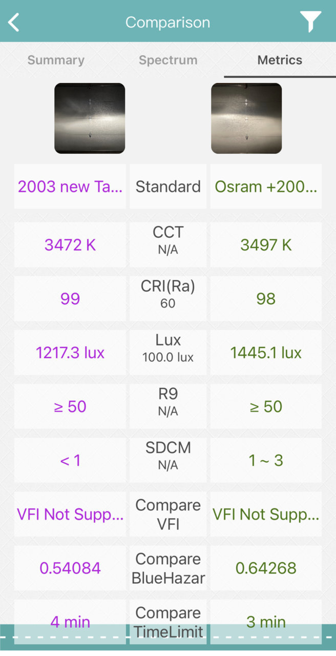

    Also unfortunately for 1st Gen, the headlights are not as good as 2nd Gen. Remember that larger reflectors are more efficient and performant than smaller ones all other things being equal, and 2nd Gen has larger assemblies. Most my post reference 2nd Gen output as those are my test assemblies.
    1st Gen (2003) vs 2nd Gen (2015) running Osram Night Breaker +200s
    You can see that 2nd Gen has about 18.7% higher output running the same bulbs compared to 1st Gen.
    Also note that 6000k LED signals are still not going to match ~4300k HIDs.

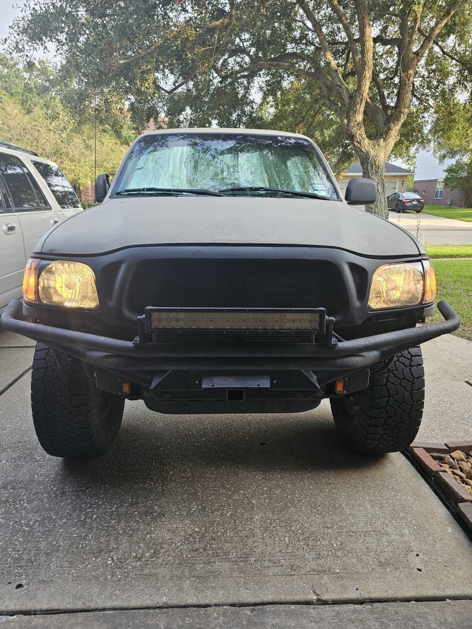

    This is what she's looks like currently. The Osram Super Bright 100/90w 2900 lumen H4s and upgraded wiring harness. No battery upgrade as of yet.
    I'm putting a TRD Grille in with lighted Toyota letters and putting the SS3 fogs on. I may change out the bumper and have not decided on if I'll keep the LED light bar.

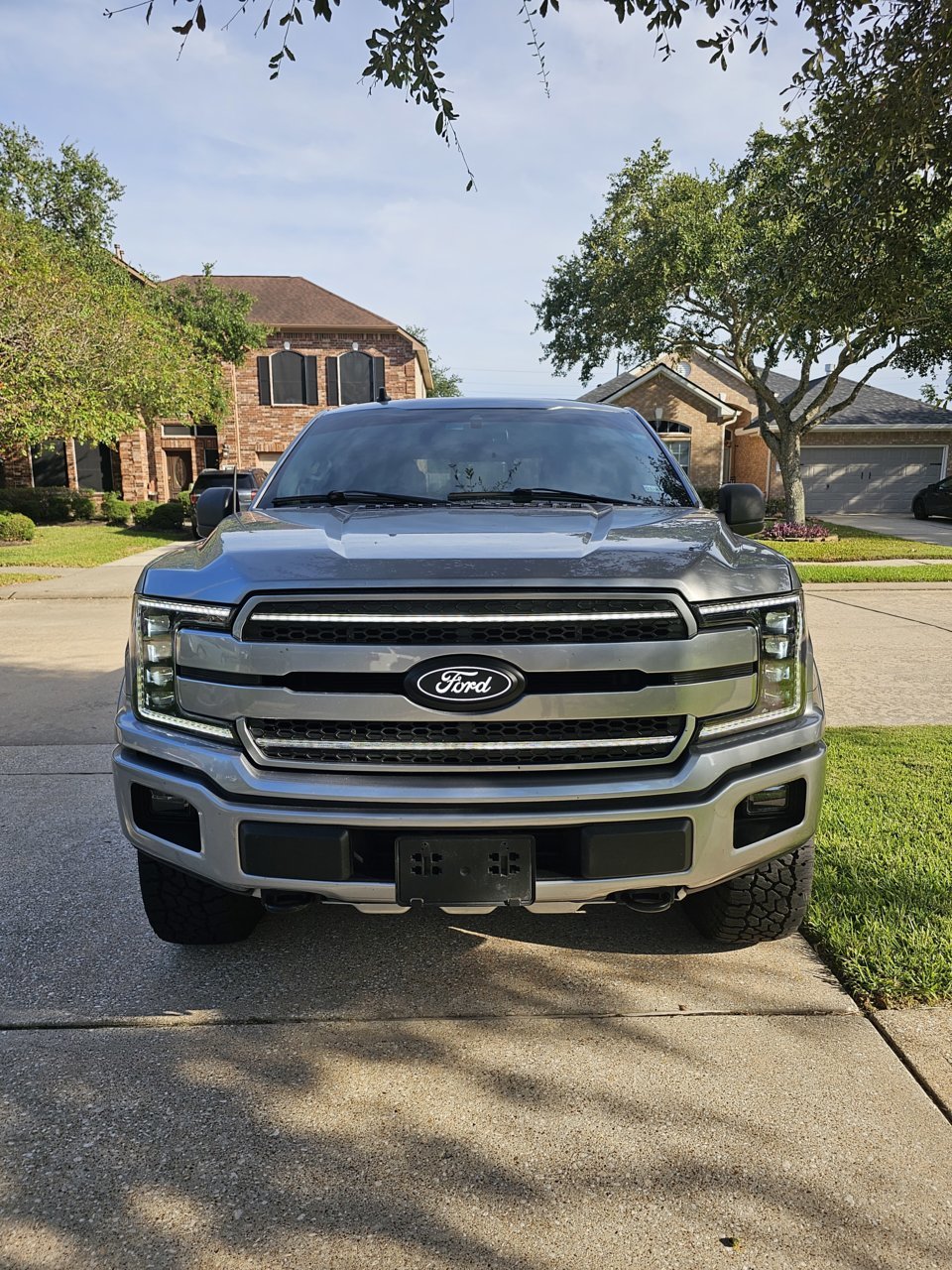

    Right. Because the Ford F150 has absolutely terrible LED headlights, whereas the Tacoma has incredible headlights. So while those Morimotos seem like an upgrade on the Ford, they are a downgrade on the Toyota, because Toyota's headlight lighting products are vastly superior over the F150 and Morimoto. And the OEM Toyota LED 4runner headlights are significantly higher performing than even the outstanding Tacoma LEDs. Morimoto simply does not compare to OEM Toyota, even thought it might seems like an upgrade on lower quality brands. Even so, the Morimotos lack uplight, it isn't a correct headlight pattern. The F150 is a difficult platform due to lack of good options, but if the model year is in the correct range Diode Dynamics makes replacement LED assemblies that do include compliant uplight unlike Morimoto. They are pricey though.
    M-LED do not have uplight. They are not a legitimate headlight projector, just another import with higher than average output. It's unfortunate because with engineered uplight it would appear to be a decent product. But definitely not recommended, the RX350 will be better.

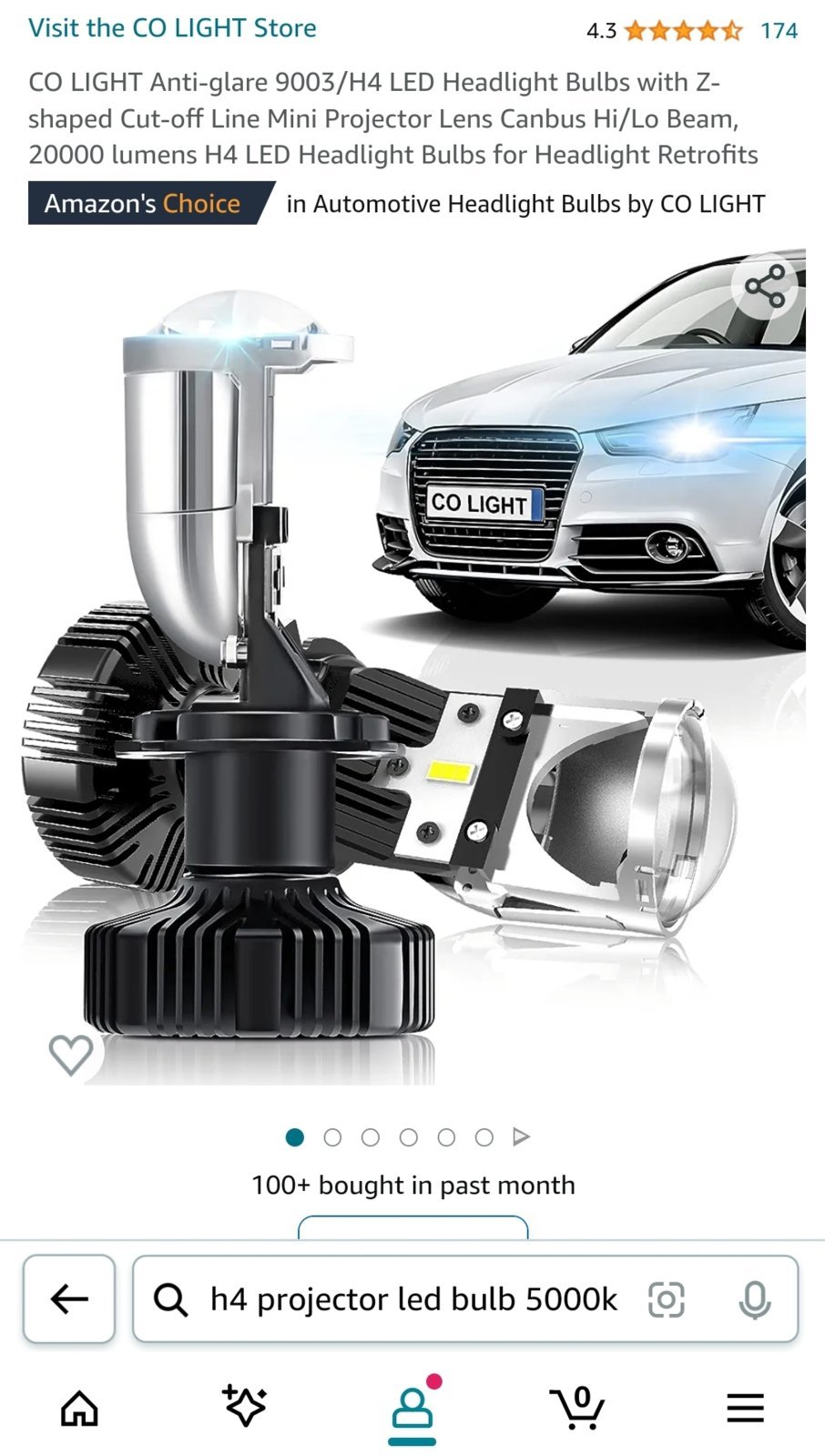

    I think you showed the light output data for Led Projector Headlight Bulbs found on Amazon. I believe it was this one. I can't seem to find it again.

    The design on these is so stupid it's not even worth wasting the time to test.
    Regardless of the type of lightsource, time and time again test data here (and elsewhere on the web, rip hidplanet fwiw) shows that larger lamps, with larger optics work better than smaller lamps.
    At best these are a very tiny "high beam" lamp. Why would a high beam projector thats an inch in diameter have a snowballs chance at working better than a large 6-7" diameter reflector with a nearly unobstructed 360* view of the high beam filament?
    These type of H4/9003 insert projectors have a few major issues.
    - Most (not all, but most) H4/9003 type lamps use a built in glare shield, so assuming this lamp can even fit in the reflector, where does the front facing aspheric lens point? Right into the backside of the only nominally reflective surface of the glare cap. So, no highbeam.
    -H4/9003 bulbs offset the lowbeam filament below and offset to one side of the high beam filament. The basic idea of the reflector design is to more optimally focus the high beam filament- the low beam filament is offset, by a small amount, shifting the beam patterns "hotspot." H4/9003 low beam filaments are also positioned under a small cutoff shield. This limits the performance potential of the low beam filament, because it's directly blocking 40% or more the light emmitted by the filament- however this shield is also precisely positioned to create the low beam horizontal cutoff. The filament plscement and glare shield work together to create the beam pattern.
    The projector bulb simply has a too large, flat plate to form a correct horizontal cutoff. Additionally, the emission pattern of the "low beam" LED emitter won't be able to light up the portions of the reflector that form the entire low beam.
    Don't. Waste. Your. Money.

    Are the light output numbers provided by the seller? If so, I highly doubt they're anything close to real / actual. Can't find them anymore? I'm going to go way out on a limb and postulate that it's because they were junk. Bulbs like this are common gimmicks designed more to impress the uneducated than to actually improve your lighting. I wouldn't waste @crashnburn80's time - unless you want to provide him a bulb to test.
