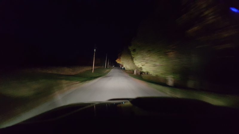

    just finished putting these bad boys in and the harness, shit is it ever bright, easily x2 if not more :thumbsup:

    Enjoy! :)
