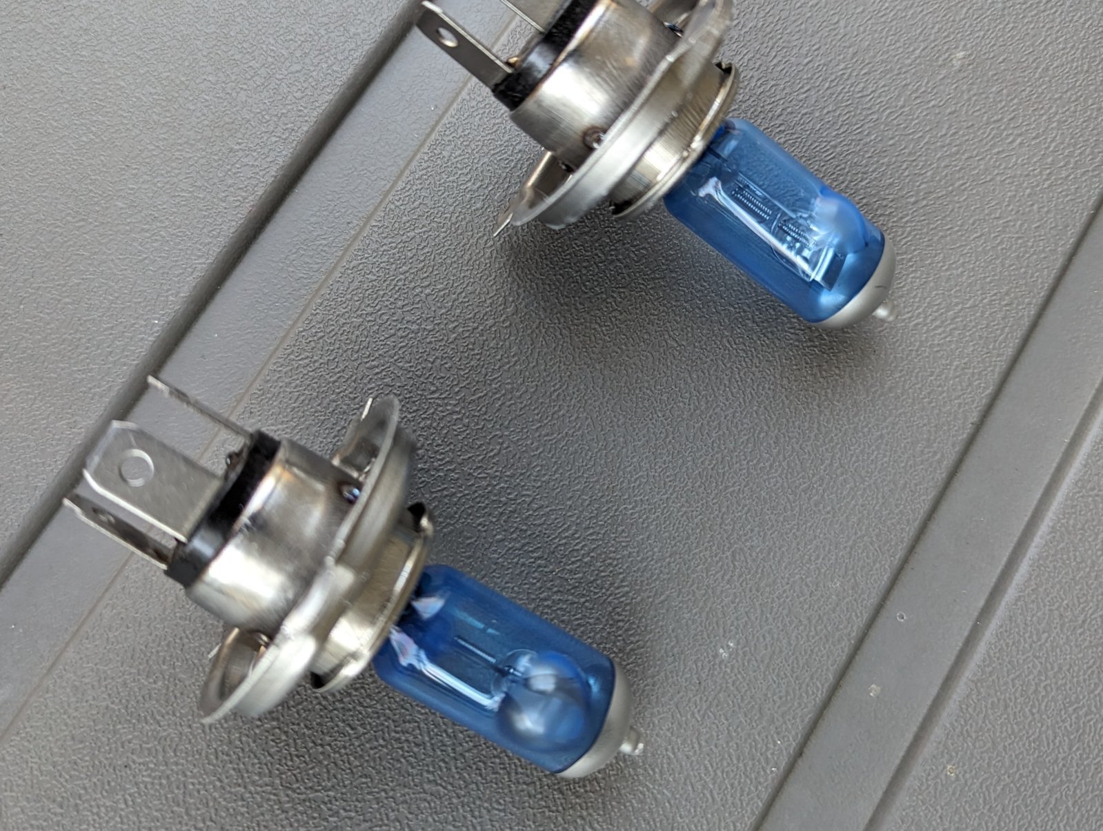

    This is why you don't buy cheap Chinese made crap. These bulbs were supposed to be rated 100W/90W. The glass evidently is not. I really like my OEM style headlights, but changing the bulbs out is one of the biggest maintenance hassles there are for these trucks. Just out of curiosity, are there any aftermarket units (LED) that are high quality and give out impressive light output? I'm staying away from Alpharex, and I'm not sure about Morimotos. Are these the only options? I was about to order different headlights just to avoid changing the bulbs again. :annoyed:

    The blue coatings absorb significant light/energy output in a halogen bulb through filtration to make the light whiter, by absorbing the yellow/warm light. When you step up to a 90w low beam, that is a lot of energy being absorbed by filtration. Energy absorbed through filtration transfers to heat. You'll notice the blistering is right above the low beam filament with the low beam shield reflecting the filament energy upward. Likely would not have happened if the bulb was not coated and that energy could pass though rather than being absorbed at the glass layer. Blistering isn't unheard of, even the highly exotic Osram Hyper 85/80w bulbs would often blister, but that was due to extreme output vs absorbing filters with high energy sources.
    As to what to do, I'd suggest going with the Philips Racing Vision +200s. They have a bulb life 2x that of the Osram 100/90w Superbrights (200 hr) , and way longer than any Chinese high wattage bulb. The Racing Vision +200s are 400 hour bulbs. Based on my use when daily driving 400 hours would be every 2 years, vs the Osrams yearly.
    The only semi-legit LED headlamp for 2nd Gen is the Hybrid Morimotos. I wouldn't recommend them over the 2nd Gen halogen assemblies. You can see the review post here. The low beam performance is about the same as using the Philips Racing Vision +200s, though they have better high beam performance. If you are using a wiring harness with your bulbs, the Philips will perform better, and even better still with the voltage booster and AGM.

    Wow, thank you so much for the explanation. I put a fresh new set of Osram 100W/90W bulbs in today and remembered tonight how much better they are. There's really nothing that compares to the output these deliver. My patrol vehicle at work has white LEDs and it's almost hard on my eyes at night. This setup I have gives off a nice warm light but very bright at the same time. The only thing I wish I did different was order the 2015 TRD Pro housings instead of the regular ones. Thanks again for your time Crash.

    Between the Osrams being clear and the best available high wattage bulb, vs a blue filtered cheap Chinese bulb, the gains will be substantial. 6000k LED lights are fatiguing over time, especially in poor weather.
