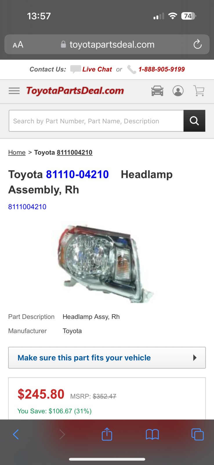

    Really wanting to ditch my Spyder headlights and do this mod. I need some help though on what to do for the headlight housings.
    These are posted as the part numbers for the TRD Sport “smoked headlights” in OP’s original post:
    81150-04173 left
    81110-04173 right
    However there is no picture of them and I want to make sure I know what I'm getting and not order them blindly-can someone show me what these actually look like?
    Another option for me is buying the regular clear/chrome headlights from eBay and doing the BHLM but I don't want to do that entire process if I don’t have to. Could someone also provide a link to a good step by step BHLM thread? I couldn’t find a definitive one.
    edit: toyotapartsdeal.com claims to have the updated trd sport headlights 81110-04210 and 81150-04210 but they look different. Product picture sucks. How do I know what I’m really getting ? Pics attached

  10. Dec 23, 2023 at 3:05 PM
    #5090
    Tiedie
    Tiedie The Only Shantytown Resident.
    Jun 28, 2011
    #58973
    5,672
    David
    WFOY
    Katzkin, Dobinsons full suspension. Redlinegoods console cover and door panel arm rests, Double USB charger in dash installed, Ballistic Jesters 16x8. BlackVue DR 590 Dash Cam
    Go with the numbers in the first post for the smoked/sport housings. @crashnburn80 can confirm this as the new updated numbers are superseded to original part numbers.

    I’ve heard some bad reviews from people ordering parts from that website. Take the part numbers the other guy mentioned are in the post @crashnburn80 listed them in and shop on dealer sites with better customer service like McGeorge or Camelback.
    I almost only order factory parts through a local brick and mortar dealer that participates in online parts purchasing on their website so I can order online and get the online prices and go pick it up in person w/o shipping charges or waiting longer than a day or two and sometimes that very day.
    Just look up dealers in your area to see if they do parts ordering online and you can pick up the parts as one of the shipping options. They tend to be a little more expensive with the initial price of items, but no shipping fees and how quickly the parts are available are worth the difference in price usually.
