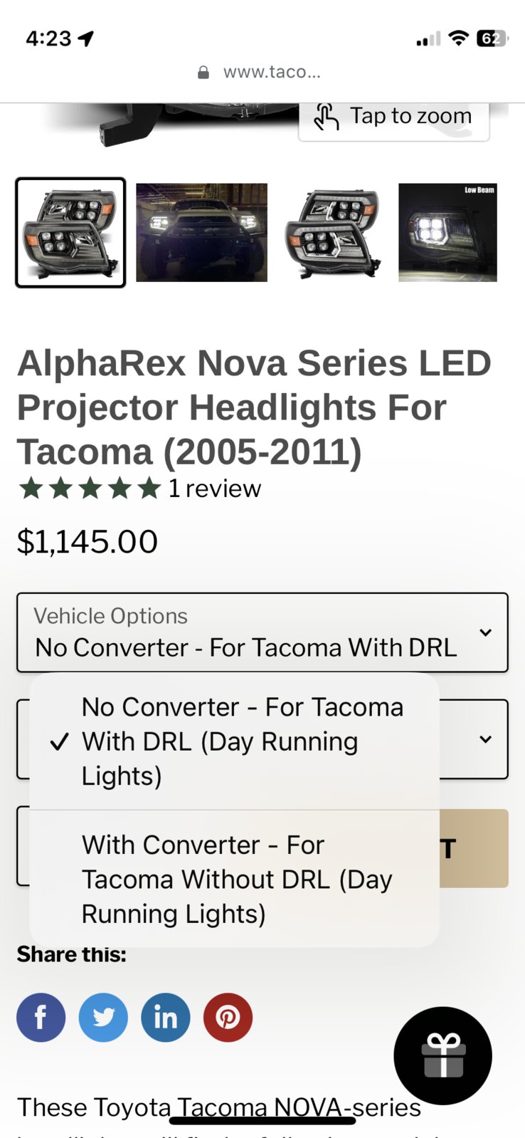

    I’m sure this has been asked, but I’m lazy today so here goes. I did this upgrade on my 2010 Tacoma back in 2016. I’d like to finally move on to something a bit more custom. Does the upgraded wiring harness I installed for this (ultimate headlight upgrade) work with any of the fancier Morimota or Alpha Rex headlights? Hate to have to wire and and buy another but I will. Any help appreciated. When purchasing lights it gives me two options (see pic) - not sure which to pic. I have also done the all the time DRL mod so not sure that makes any difference in my two choices. Thoughts?
    Side note: got nothing bad to say about this mod. Totally practical, and I’ll probably switch back cause the lights are so much butter. I’m eventually giving it to my 13 year old son.

    I think you may have missed an important point about the Ultimate Headlight Upgrade. The secret to its success is not just the bulbs and harness, but those two components in addition to the OEM housings. Adding "brighter" bulbs to a sub-par housing - and that includes all of the aftermarket housings - defeats the whole purpose of the upgrade.
    On a related note, the specific housings that you mentioned both use LEDs for their light source. That means the whole Ultimate Headlight Upgrade currently in your truck would have to go. Are those housings an upgrade from what you currently have? Nope. Save your money.

    Oh, I understand how the upgrade works. I absolutely love the output I get with it. I was just wondering if the upgraded harness, I have, would work in connecting to the AlphaRex lights. Just looking for a little change. I can always go back. And if I don’t need a new harness, it makes my decision so much easier. If I do, then I’ll probably just stick with what I got. Thanks for any help.

    The alpha Rex might use the stock wiring which is still installed in your truck. If that’s the case the additional voltage from the upgraded harness can’t hurt.

    Most (but not all) aftermarket headlights plug into your factory harness, so they should also plug into your upgraded harness. The problem with aftermarket halogen housings though is the crap optics. No upgraded harness and / or bulb is going to make up for optics that don't optimize light source output.
    If you go with aftermarket LED or HID housings, you can plug them into your upgraded harness. But you're still going to have the problem of crap optics. If you do some searching around here. @crashnburn80 has tested some of the more popular aftermarket housings and concluded that they're scientifically a downgrade. Yes, some of them flood the foreground with light - which gives the impression of improved lighting - but they do this at the expense of distance lighting. Translation: You'll be able to illuminate the deer you're about to hit very nicely - when it's too late to do anything about it.
