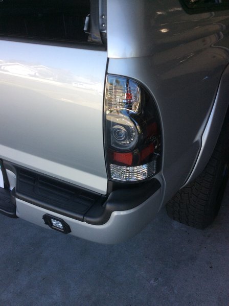

    curious to know how they look
    Appears AlphaRex has new 2nd gen tails
    Not sure if there’s a tail light thread
    Anyone have them? Looks like this truck might.
    Hopefully signal isn’t red.
    Pricier than this one
    Been running DEPO smoked without issue. Integrated circle brake/running red LED maybe not the brightest and not bulb swappable like incandescent rails (DD brake bulb) but still compatible with turn signal and reverse bulb changes
