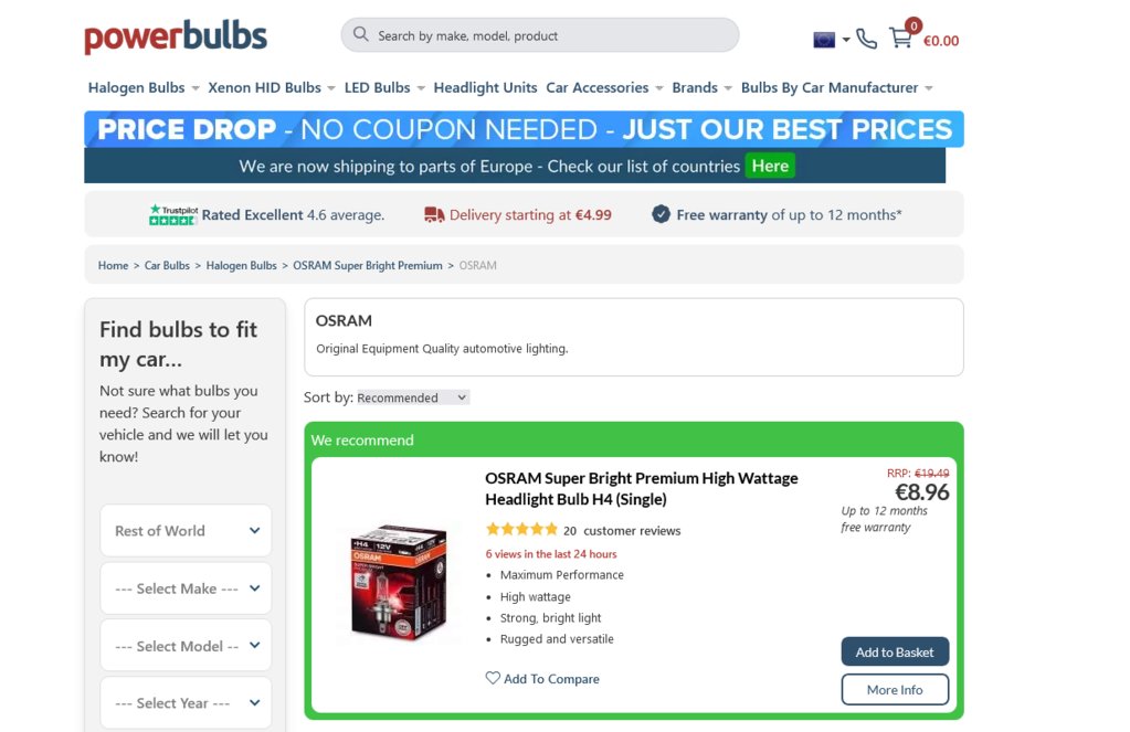

    I tried ordering the osram 100/90w on powerbulbs.com and contacted customer service. They told me for the time being they don't ship to Canada? Anyone else have this issue? Any suggestions on where else to order from?

    They’re likely not shipping due to Canada post but there is an outfit out of the UK that I got ‘em from. Had ‘em in a week but can’t remember the name to save my life.

    Could this be it?
    FastEddy59 likes this.

    Yes! That’s the guys :thumbsup:
