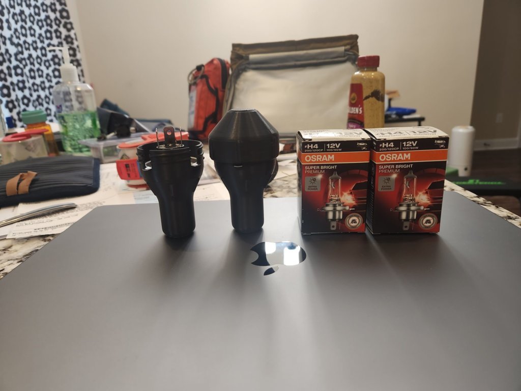

    Resized_20250201_074902_1738414157730.jpg Resized_20250201_074857_1738414156167.jpg
    Got tired of carrying these small boxes for bulbs so I printed these up.
    AllTacosFloat, TRD10, Robb_R and 10 others like this.

    Care to share the file? Got the same bulbs and the same problem, don't want to mess them up.

    Headlight bulb H4 case by gbazil - one I printed
    9003/H4 Bulb Case by Moto | Download free STL model | Printables.com - another one I found
    I picked up a Bambu P1S during the Christmas sale, I've been tearing up some pla since. Im just trying to get set up to print ASA and ABS. Ive been looking at printers for years, I've been reluctant because it wasn't plug and play for a long time.
