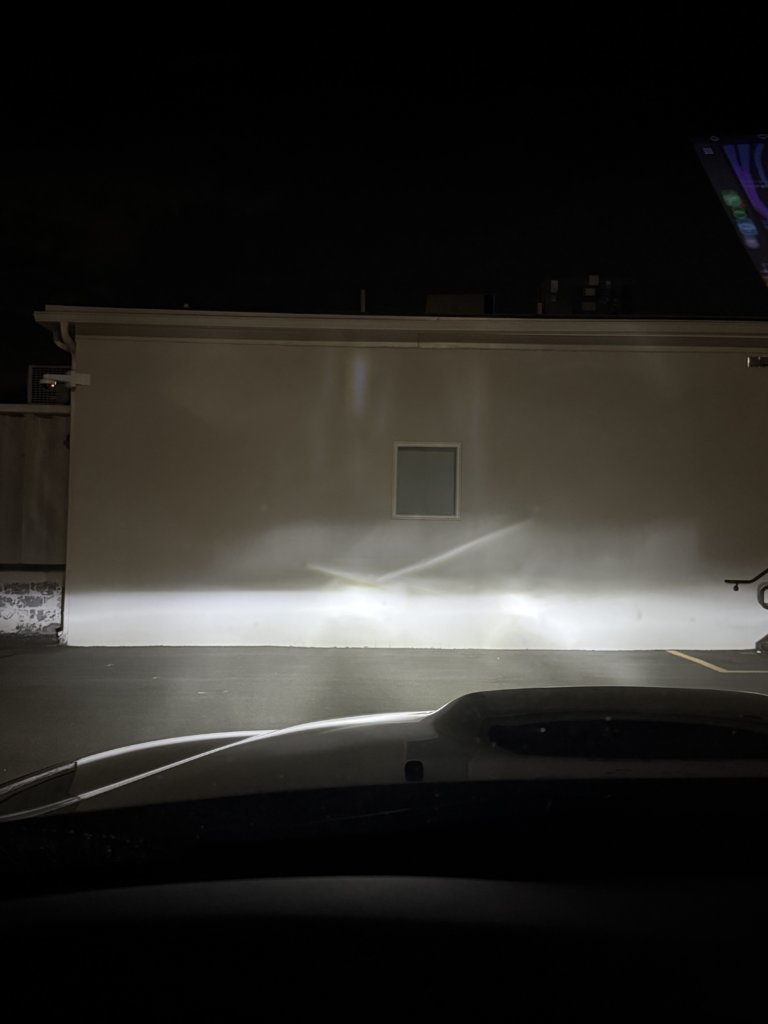

    Looking for some assistance. Been trying to solve this issue for about a month now. For some reason I’m getting stray refractions from my housings. They’re OEM reflector housing replacements with H4 LEDs. The bulbs are oriented correctly. Anyone have an idea of where to go from here?

    To the auto parts store for some halogen bulbs. In all seriousness, It’s actually the purpose of this thread. You won’t get rid of the scatter from the LEDs. Check out the first post in this thread for some solid info/advice. @crashnburn80 has done an amazing amount of work/research on this.

    Those "stray reflections" are what causes the glare that plagues drop in LEDs. Dump them in install the correct halogen bulbs and they will magically disappear - as will other drivers flashing you.

    The first post in this thread has all the information you need on where to go from here. Get rid of those lousy LEDs and do the halogen upgrade with the harness. You’ll see much better and won’t be blinding oncoming traffic.

    The LEDs themselves are your problem.
    :amen: x 3!

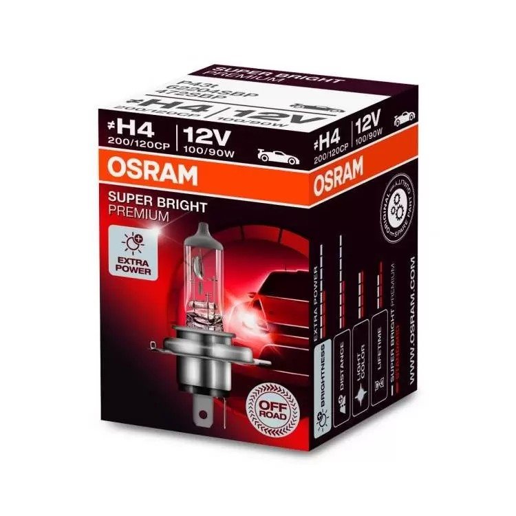

    Just thought I'd share my 41 year old BMW motorcycle takes H4 bulbs, but I won't be putting in these upload_2025-5-7_6-15-44.jpg

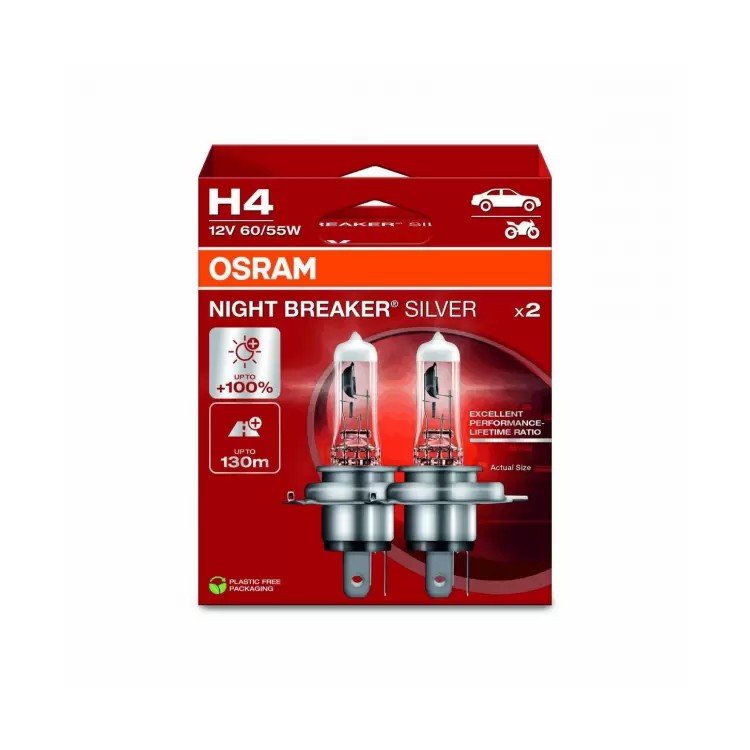

    Instead I'll be putting these in
    Don't want to overload that antique wiring o_O.

    same with my Honda. Was thinking the Night Breakers or the DSLs

    Stock wattage bulbs are the only way to go, if you can't upgrade your wiring to safely use Osram Super Bright 100/90w 2900 lumen H4s.
    According to @crashnburn80...

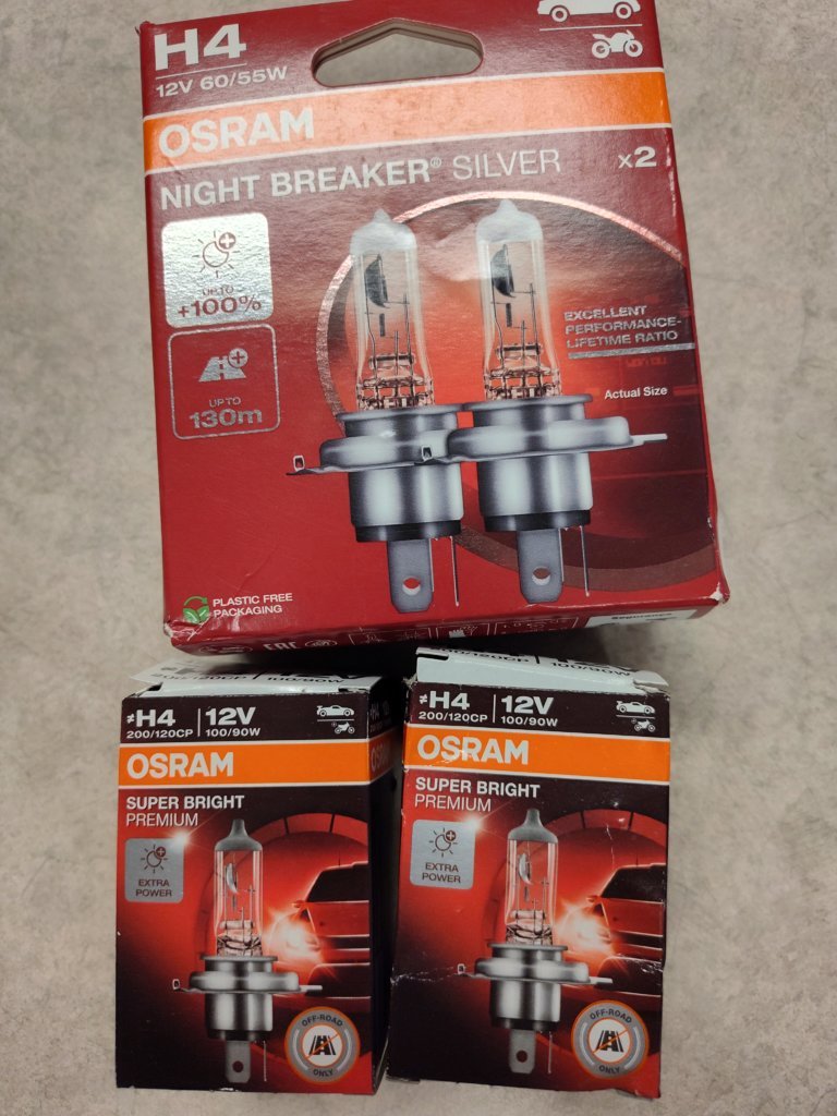

    Look what showed up on Saturday.
    The 55/60 are for this
