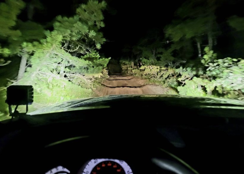

    I followed this thread a few years ago.
    Upgraded to higher wattage bulbs in my headlights and fogs.
    Bought the harness kit for both, also wired the fogs to come on with the high beams (lots of forestry road driving).
    Spent the money and bought OEM headlight housings too!
    By far ive never had a better light combo. This setup kills any lightbar aux lights that ive seen. Bonus is that I never get bright lighted back unlike my new car with LEDs, 400 watts of Halogen !
