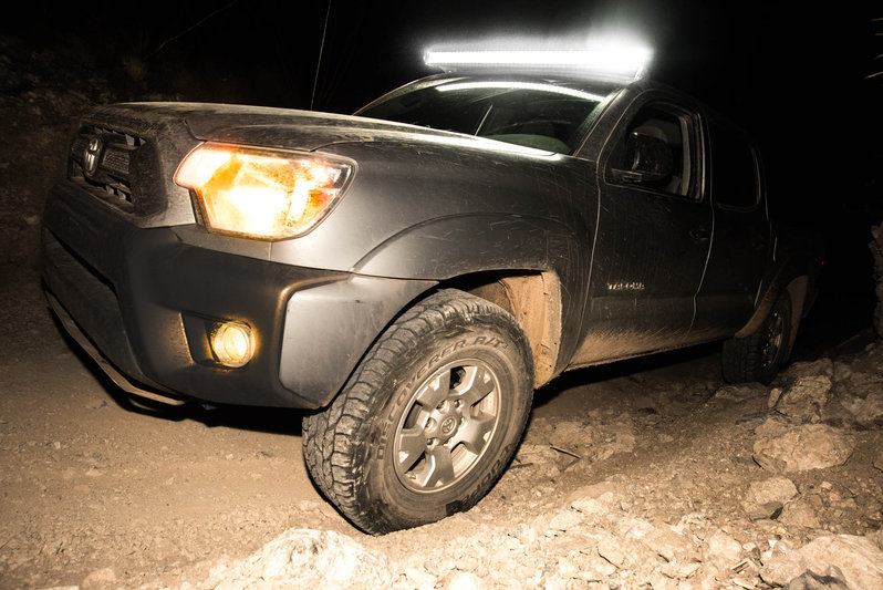

    Liking this so far, have some questions and concerns for the op. My main issue with the stock lights isnt necessarily luminosity itself (though it does suck a pretty large one) but with the spread of the high beams. When I have my brights on there is almost no light hitting the first several meters of road in front of me, which is very important for my needs. Im used to vehicles that use dual bulbs or just have much lower ground clearance. Will this upgrade help with that at all? Was also considering going with the bright boxhttp://www.amazon.com/The-Brite-Box-Model-performance/dp/B002N2LCMS but that combined with higher wattage seems to be a recipe for disaster, weather it be in the form of a truck fire or just needing to replace bulbs on a bimonthly basis. Im also calling matching color temp into question here. I do A LOT of night driving on remote roads and run my LED bars more than anyone I know. Its unfortunate that after spending any amount of time with them on, I feel blind once I switch back to just the headlights for legal road travel, but also it takes my eyes quite some time to adjust to the color change... which I just cant have in my line of work. How white is white? Last and also least is aesthetics, I know Im not going to fork up the cash for the pro housings, and am not patient enough for the BHLM(which was why I was leaning towards projectors) but looking back at my running truck, it hits my fashion nerve to see my lights mismatched by a few thousand ˚k. That being said I plan on throwing an amber cover over a few of my pods for foggy conditions. See attached photo. Just cant have that, now can we?

    And for comparison ;)
    ^Totally shopped bumper color btw
