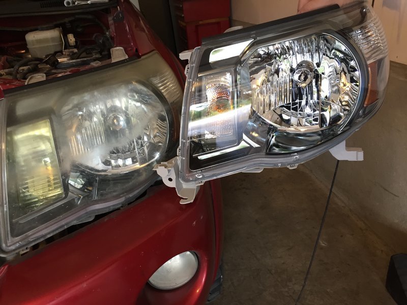

    Here yea go! I installed them this past Sunday as well as Rigid SAE fogs (which are ridiculously bright)
    Comparison of headlights
    Old Headlights
    New Headlights

    Maybe you should read the whole thread. This isn't like an HID kit w/o retrofit. It's like stock cut-off with more light. Nobody gets blinded with stock cut-off, right? Same here. Just brighter.

    I agree. Look at the cutoff in my pics. I am very happy with the result.
