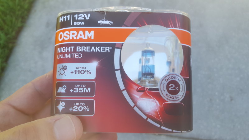

    Just got these today.

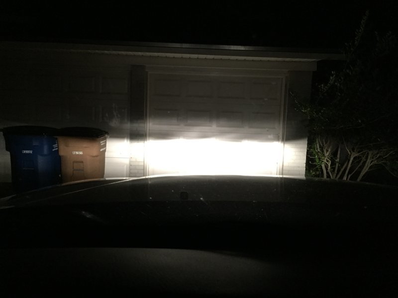

    Glad to see i'm not the only one with the faint strip of light above the main beam pattern. FYI, i did the upgrade. I was running the Philips LED's before but they were spotty and had no distance. This light dispersion is much better and i can see further.

    Welp these didn't fit....back to the drawing board

    Those are H11, your truck takes H4 headlight bulbs. Or 2012-2015 fogs.
