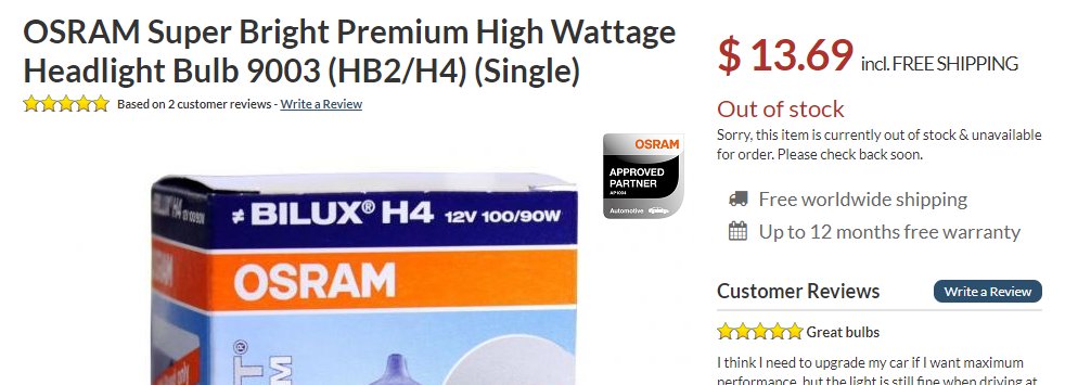

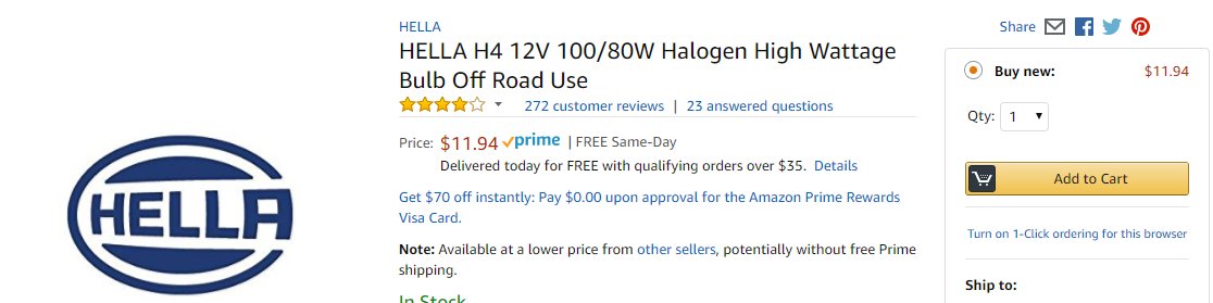

    and how ironic that the 90/100 9003's are out of stock
    Anybody tried these???

    I haven't, but if I recall correctly their lumen output was a little less however their bulb life was significantly less. Something like 150hrs Hella vs 200hrs Osram.

    Yep, I rec'd an email today from customer service. They're shipping part of my order and expect new stock in a couple days and will send the remainder.

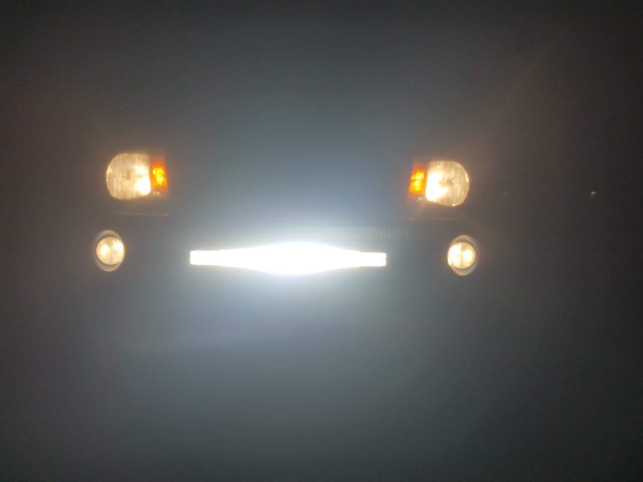

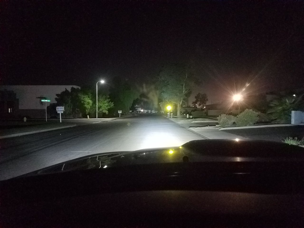

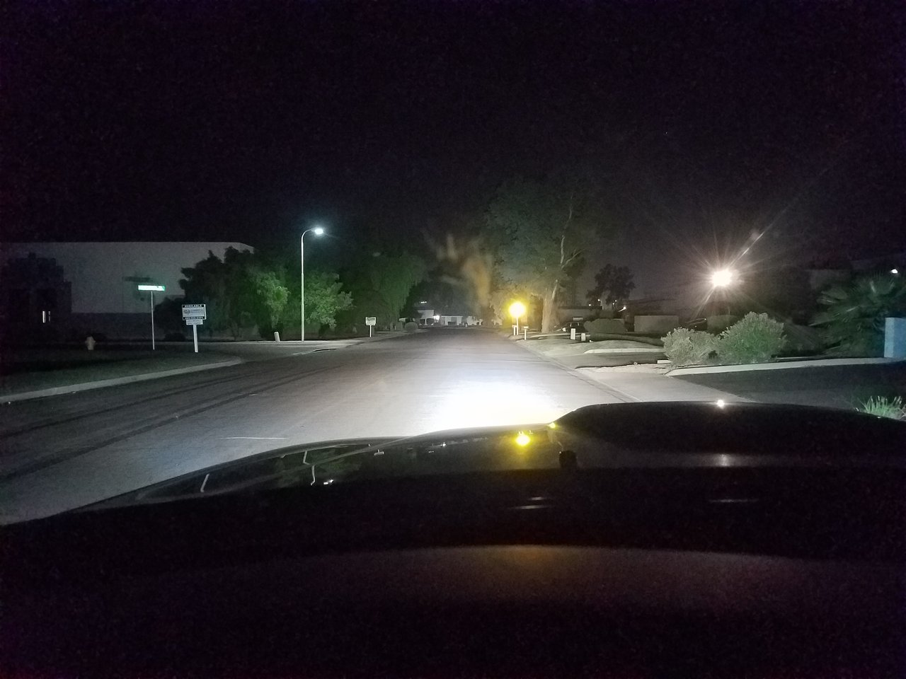

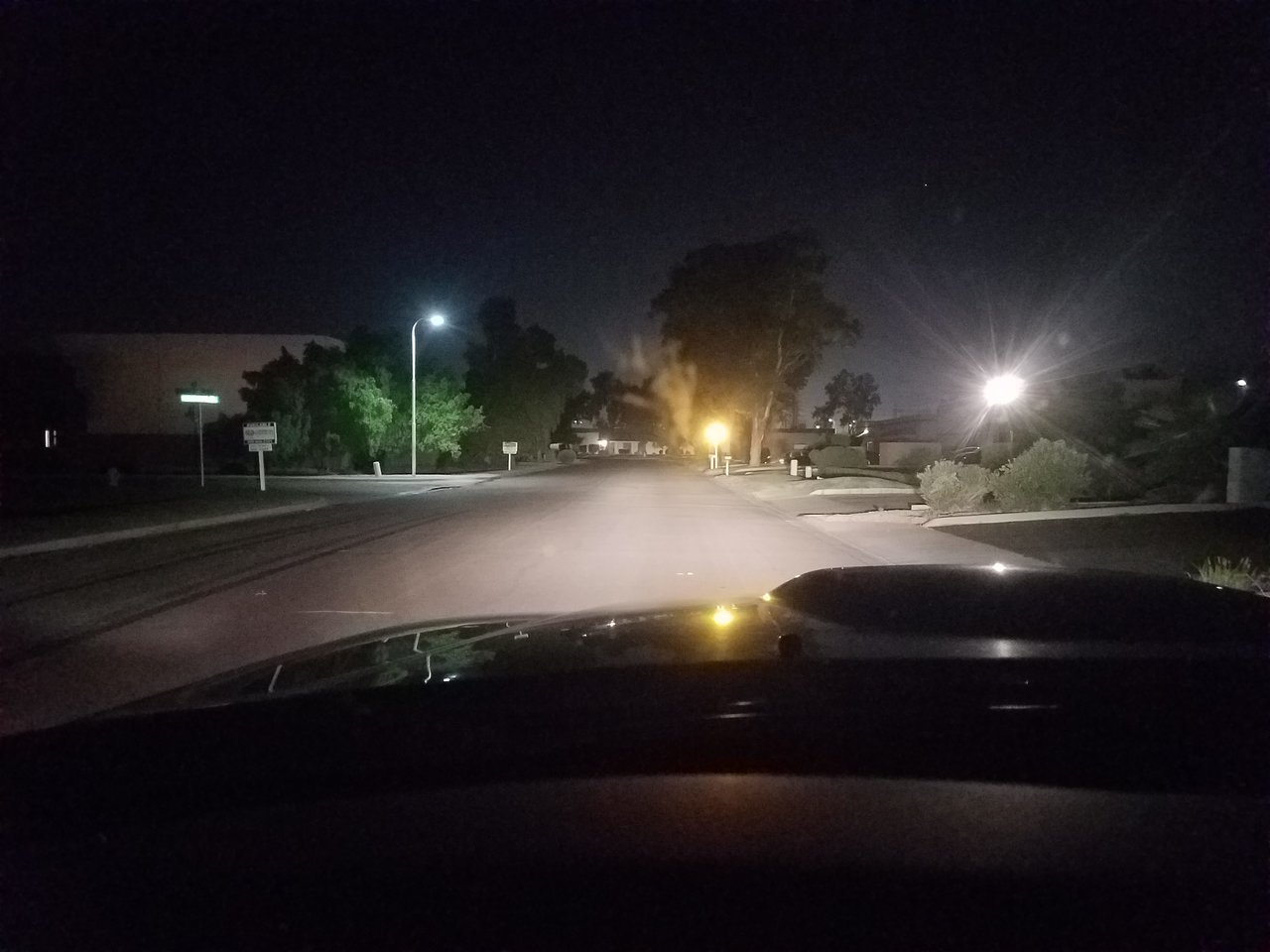

    The 100w bulbs are awesome. I hate dealing with HID kits and i dont want to do LED as its still crappy & too much effort or $ for retro fit. Below is some out put pics of the highwatt fogs and headlights from my whip

    There are a few in the thread over the 37 pages. There is also a thread with first gen results pics:
    https://www.tacomaworld.com/threads/proper-headlight-upgrade.407879/
    Pictures are so easily to manipulate, intentional or not, which is why my photos show side by side vs before and after. I've also got quantitative lumen measurements for real numbers vs just photos.

    But that could have been due to the color temperature difference. The halogen upgrade does not look sexy, it does not have the 'hyper white' or 'cool blue' look that is trendy. It is purely functional, same light color and look, 2x as bright.
    Hard to see how you can barely tell the difference when the light output is scientifically measured to be 2x. Swap one bulb back to stock and run it on the factory harness, while you leave the 100w bulb in one the standalone harness. You will quickly see the difference.
