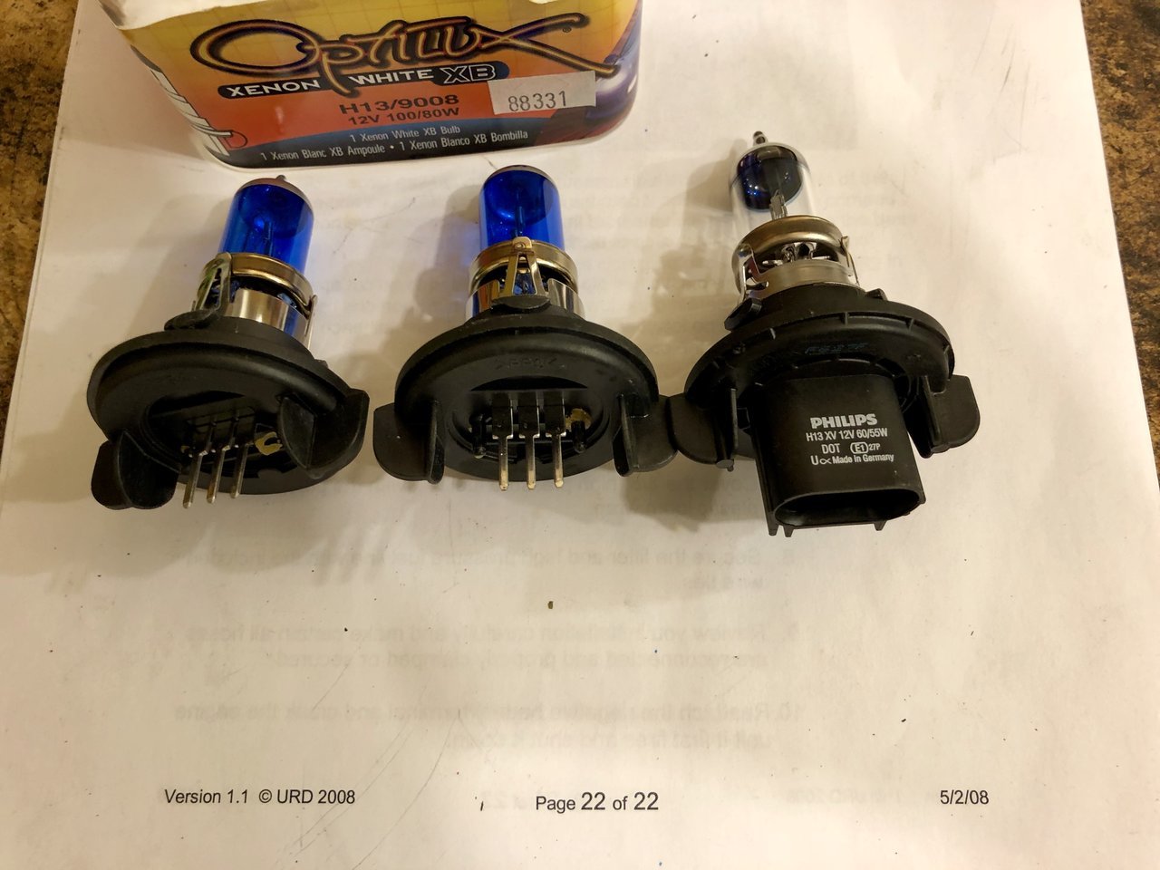

    On a different lighting project, I purchased some Optilux H13 4000k 100/80w bulbs, because they were the lightest coated H13s in high wattage I could find. Clear is not available from any reputable brand in H13.
    Optilux is a value brand Hella company, but not the same quality as Hella, made in Korea instead of Germany. I've run many Hella products over the years and always been impressed with their quality, so being a Hella company I thought even value brand the product should be decent, and the specs looked decent.
    This was the first time I bought Optilux. I was appalled by the quality of their products. I will no longer recommend Optilux as a reputable brand.

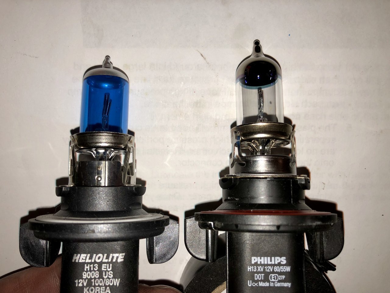

    What I pulled out of my Optilux package was 'Heliolite' bulbs, not 'Optilux', so it appears this is a rebranded mark up of an even cheaper bulb. The filaments in both bulbs were crooked, not even crooked in parallel with the other filament, but independently crooked in differing axis.
    Compare the 'Optilux' bulb (left)to the Philips Xtreme (right).
    Philips filaments look to be laser aligned. I could freehand filament placement better than the Optilux. Precise filament placement is critical in halogen headlight beam quality.
    Looks like I'm going to have to try my hand at retros for the H13 project.

    I pulled out those terrible Optilux bulbs today after one test drive. The bases came off of both bulbs. Complete trash for quality. Now the bases are stuck in the harness, and trying to remove them the flanges cracked off the remaining portion of the bulb leaving the harness plugged. Fortunately it is a stand-alone harness I put together and not the OEM harness. I’ve never experienced such a poor quality bulb.

    $35. Which is about $50 too much.
