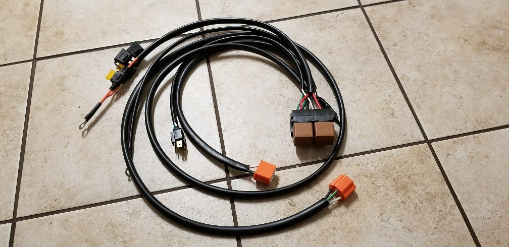

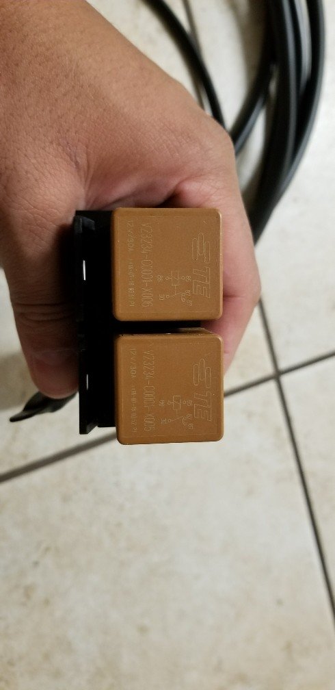

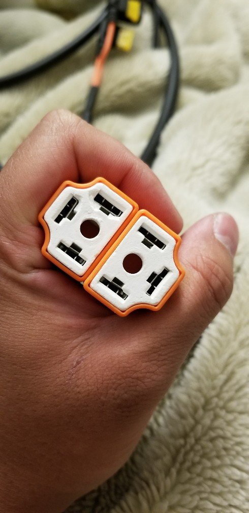

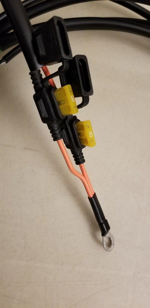

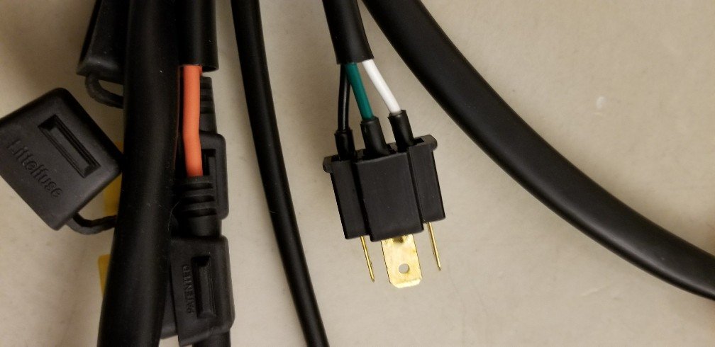

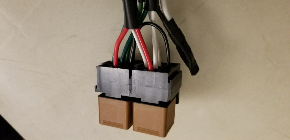

    Headlight harness from headlight service came today. Super impressed by the quality. Still waiting on my bulbs, but might install the harness tomorrow, to see if it makes any difference on factory bulbs.

  12. Dec 18, 2017 at 8:41 AM
    #832
    BenMara
    BenMara That Asian RedNeck
    Apr 14, 2011
    #54903
    1,951
    Ben
    Belton, SC
    2011 DC 4x4 SCed
    TRD Blower, Ham Radio, DBA T2 Rotors
    Now thats quality product... Is that the harness from http://www.rallylights.com/ ??

    From those close up pics, you can tell that there is a lot of attention to detail in that harness. When I did the ultimate headlight upgrade, I bought the Rally lights harness, because it was highly recommended by crashburn80. Even though it was overpriced, and they reamed me on shipping, I stepped up to get a known quality product. The headlight services harness was not well documented as to quality at that time and I only wanted to pay once. Now, looking close at the headlight services harness, I see 1 potential problem. The relay they chose to use, is a dual output relay. In other words, 1 common terminal and 2 N.O. terminals. Although this is appears to be a great relay for this application, a problem will occur if you need to replace a relay for any reason. If 1 of the much more commonly available relays that have common, N.O., and N.C., is plugged in, 1 headlight will be on constantly.
    I just looked at my Rally Lights harness and it uses that same style of relay. So, the lesson here is, even though any ordinary relay will plug right in, don't do it.

    I just installed mines today, only took 20 mins, including fabricobbling a mount for the relays. Something I did notice, due to the heavier gauge wire and stiffness, when installed, they pulled the bulbs up a little bit. Maybe the retaining spring thingy is worn out?
    The current bulbs are still stock (waiting on new ones to come in), but I can tell the lights are slightly brighter, although minimal. Can't wait to see the difference with the new bulbs.
    As far as the relays go, I zero to no knowledge about them. But if your saying Rallylights also use something similar, I would imagine it to be okay? Haven't read about any failures, but what you bring up is a very good point. I'll try to get a spare or two. Thanks for pointing this out.

    I doubt that relay failure is common, and it's probably not worth carrying a spare. After all, since there's a sepparate relay for high beam and low beam, it's not likely that you're going to be stranded with no lights. It's just something to be aware of that if you do have a relay failure, you can't just rob 1 from your lightbar circuit.

    I’ve run the setup on multiple Toyota’s over nearly 10 years. Never had a failure. Buying quality parts pays off long term.
    Even if this did happen, you can disconnect the harness from the battery and run standard H4s available everywhere for just a few bucks until you get a new relay.
