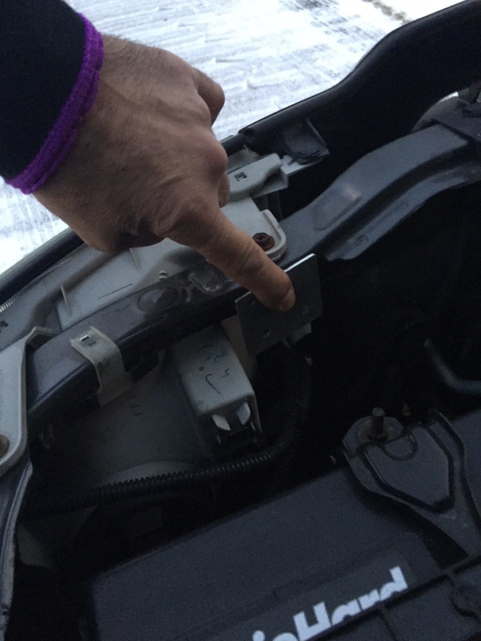

    Okay, so despite my previously mentioned aversion to the cold, I braved the elements today and made some measurements for a bracket to install the relays on. With some scrap aluminium sheet I had around I was able to make not one but three brackets. It will mount to the rad support by drilling two holes, and the relays will mount to the bracket. To thank him for his many group buys he's set up for us here I'm giving @Unchained 5150 dibs on one if he wants, the other one goes to whoever posts up an I'll take it and pms me their mailing info (conus only please). Price including shipping will be free. As in no cost. Free. Figure I can just through it in an envelope. I'll send them out next week, I have to paint them first. You will have to provide your own small nuts and bolts to mount.

    Hmmmmm I don't know if I can afford this overinflated price. I will have to check with my accountant and get back to you.

    I would take one but @GHOST SHIP made this one for me to attach to the battery holder. It is all painted in black now.

    Happy your all set up then Rick. That means there's two up for grabs TWers.

    Yes, they are. All painted and ready to go. Should be able to get it in the mail tomorrow. PM me your name/address.
