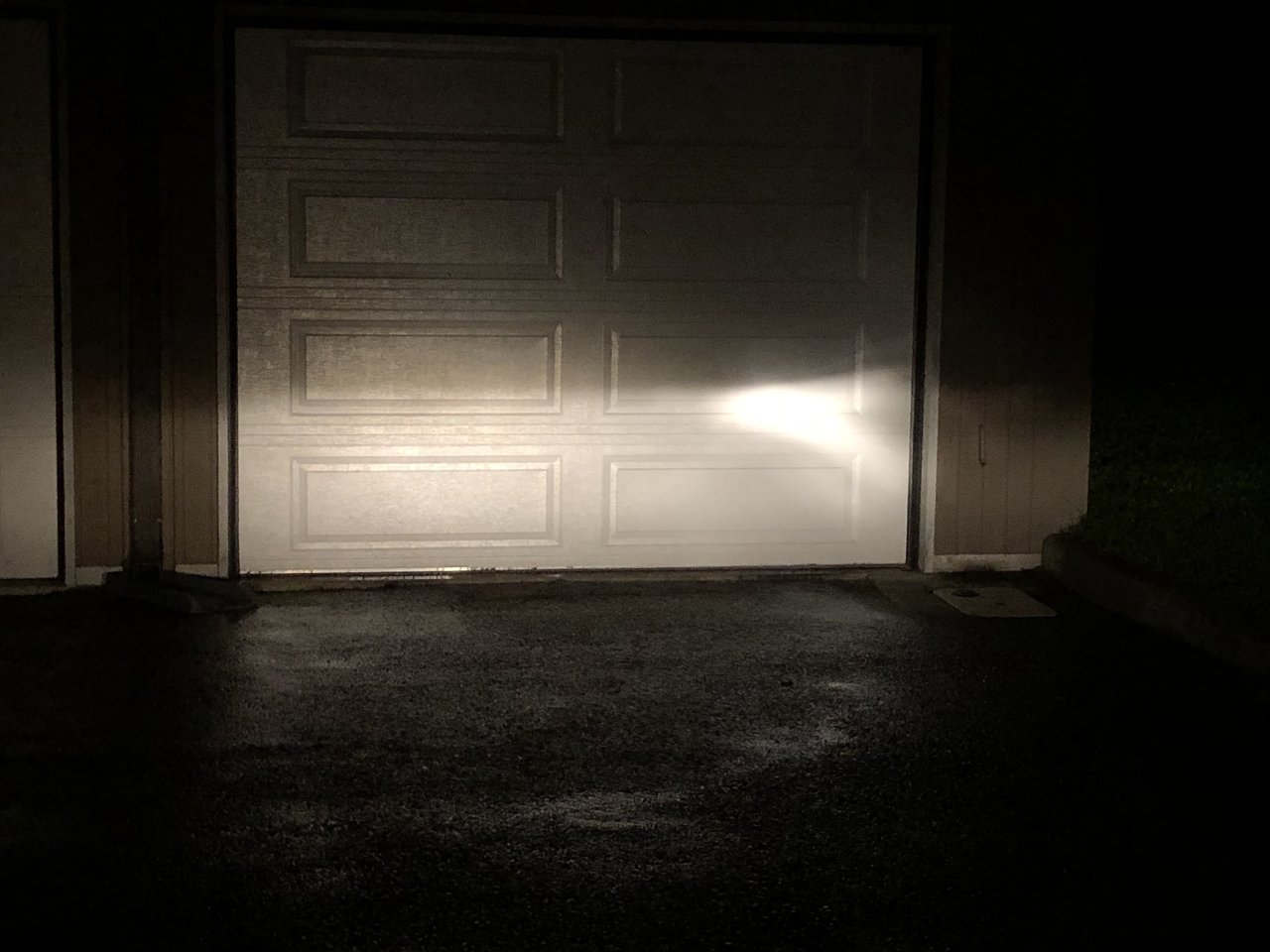

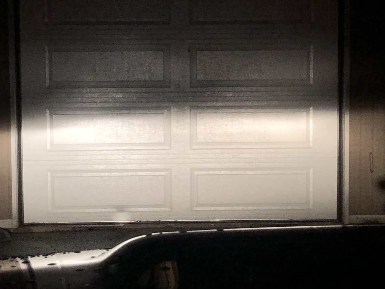

    These 2 bulbs are end of life, meaning their companion bulb has burned out. Bulbs should always be replaced in pairs as bulbs dim 20%+ over their lifetime. These 2 bulbs are the surviving bulb after the other one burnt out.
    Hyper 85/80w left, 100/90w right
    I was messing with the aiming so the driver is a bit low. Not only is the Hyper noticeably brighter in low beam with a better hot spot, it is noticeably whiter.
    I’m swapping back to the 85/80w Hypers.

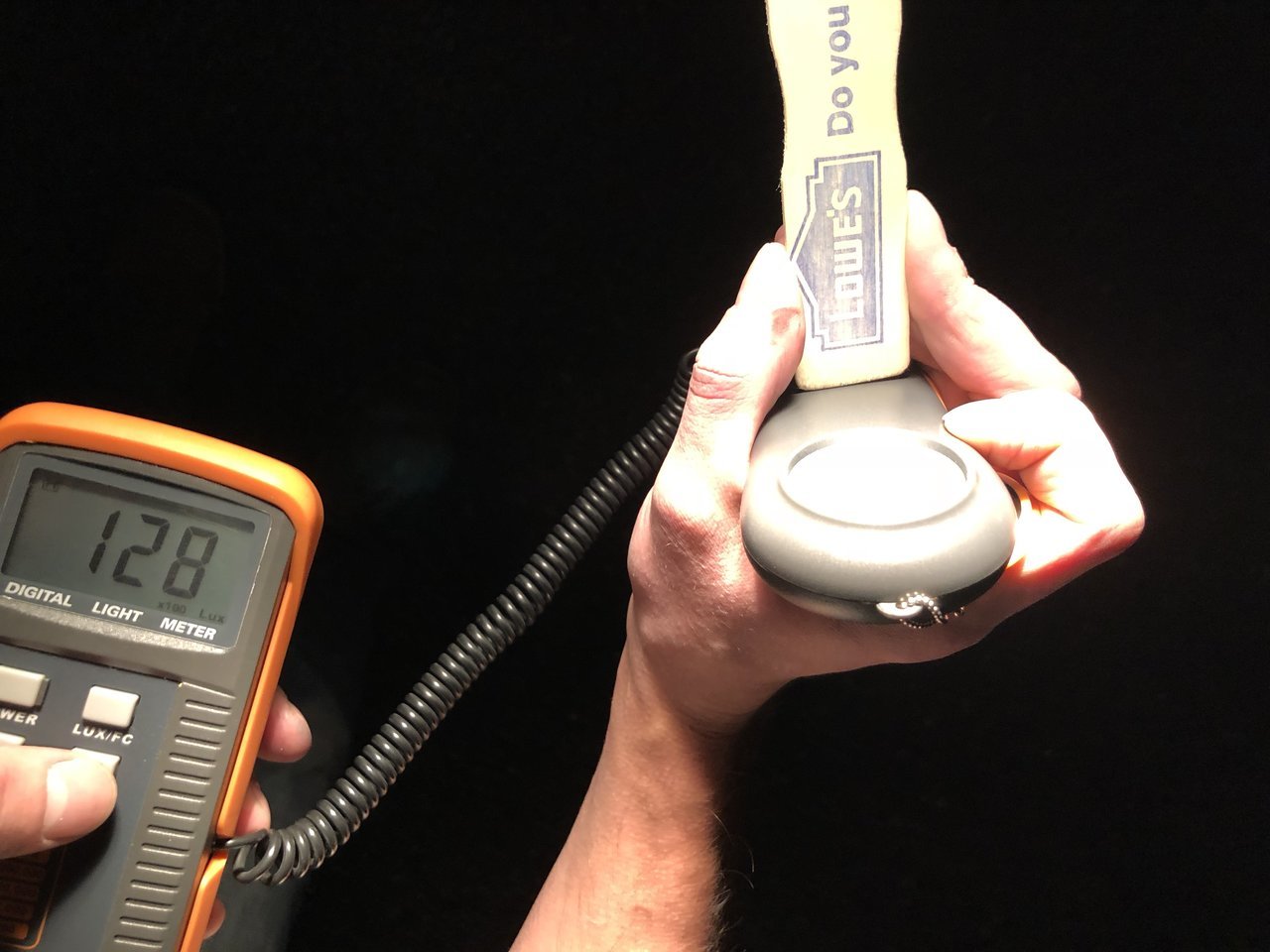

    We did a headlight tune up on a late model 1st gen this evening. The OEM headlights were in poor condition due to life in the Arizona sun. Swapped the badly hazed headlights for new CAPA Depo units + Volsa +100 bulbs. No harness.
    Old headlights and bulbs left, CAPAs and Volsas right (beam still needed aiming)
    Before reading:
    After reading:6BCE4874-4AAE-4BCF-A71A-2A28230F4F7C.jpg
    A 2.6x+ improvement by just keeping things in good operating condition and using stock wattage performance bulbs.

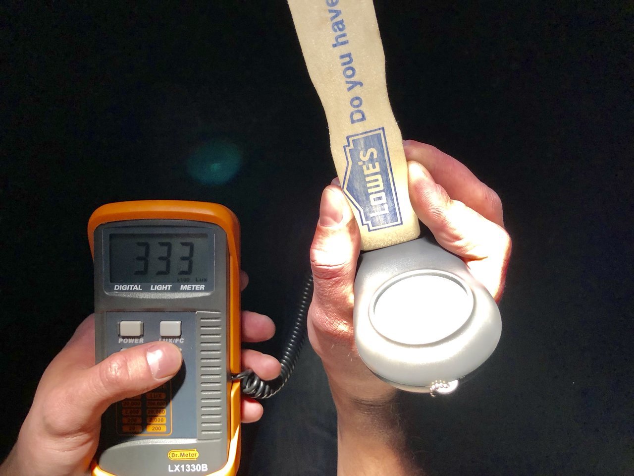

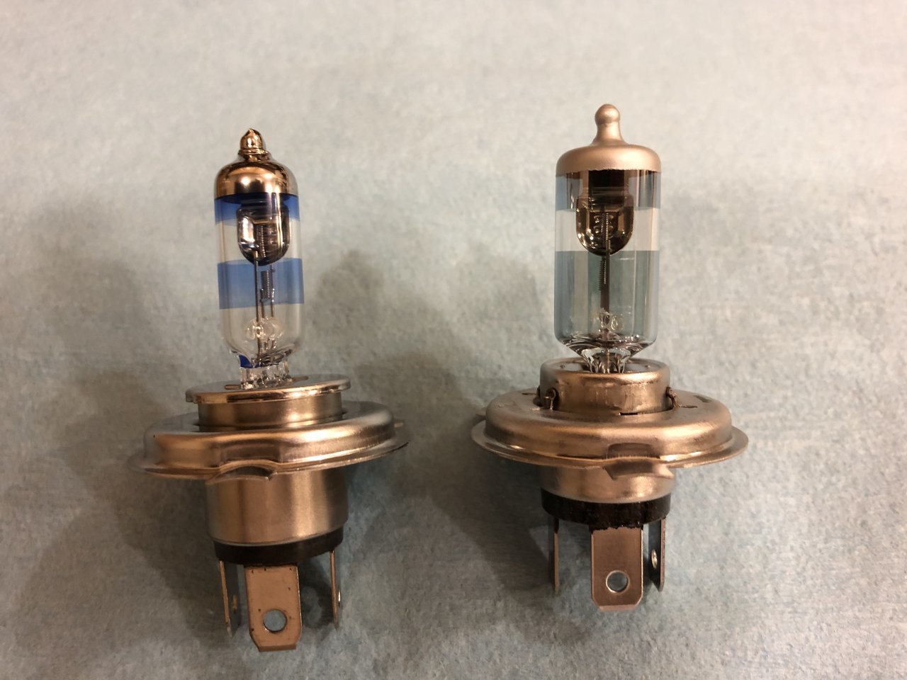

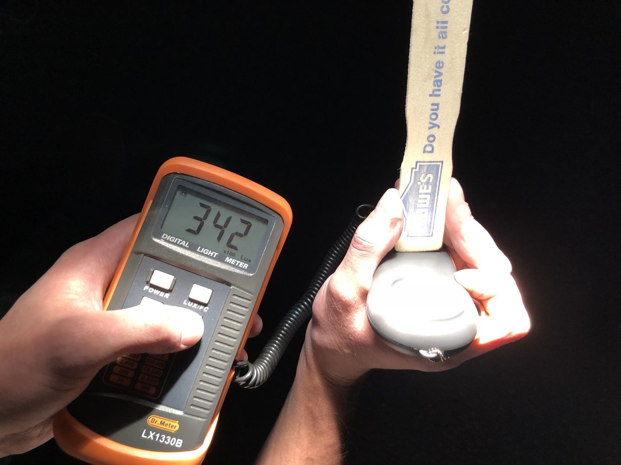

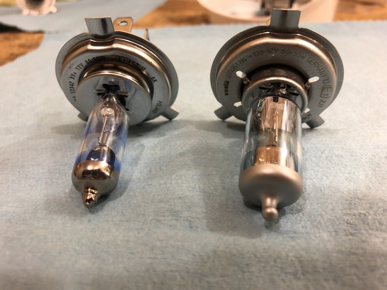

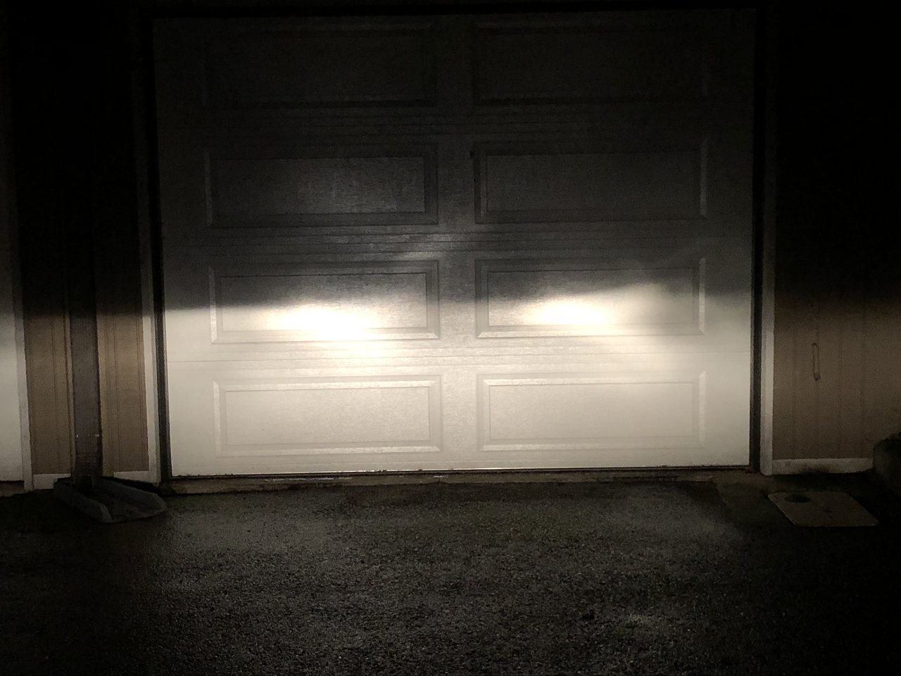

    Volsa +100 vs Philips Xtreme +130
    While swapping to new CAPA headlights with Volsa +100 bulbs on a late model 1st Gen, I thought I would be a good opportunity to throw in the best bulbs from Philips and Osram for comparison to see if Volsa is really worth it.
    I picked up a set of the latest Philips Xtreme +130s but unfortunately I wasn’t able to get the Osram Nightbreaker Laser +130 in time for the mod day. However many sites have documented they are equivalent to the Philips, with possibly Philips having the edge. But I haven’t seen any compare either Osram or Philips go to the new Volsas.
    Philips left vs Volsa right
    No this is not some weird angle, the Volsa bulb capsule is freakishly massive.
    You can see differences in the proximity tinting, Philips left vs Volsa right
    Measuring output in new Depo CAPA 1st gen assemblies:
    Volsa +100
    Philips Xtreme +130
    With a reading within less than 3% of each other on a tool being used freehand with a paint stick, I’d consider the readings about the same.
    A little hard to tell in the photo, but the Philips appeared to have a slightly larger hot spot and was a bit whiter in light color.
    In the end after comparing side-by-side and taking a few test drives, the owner selected the Philips and saved the Volsas for spares.
