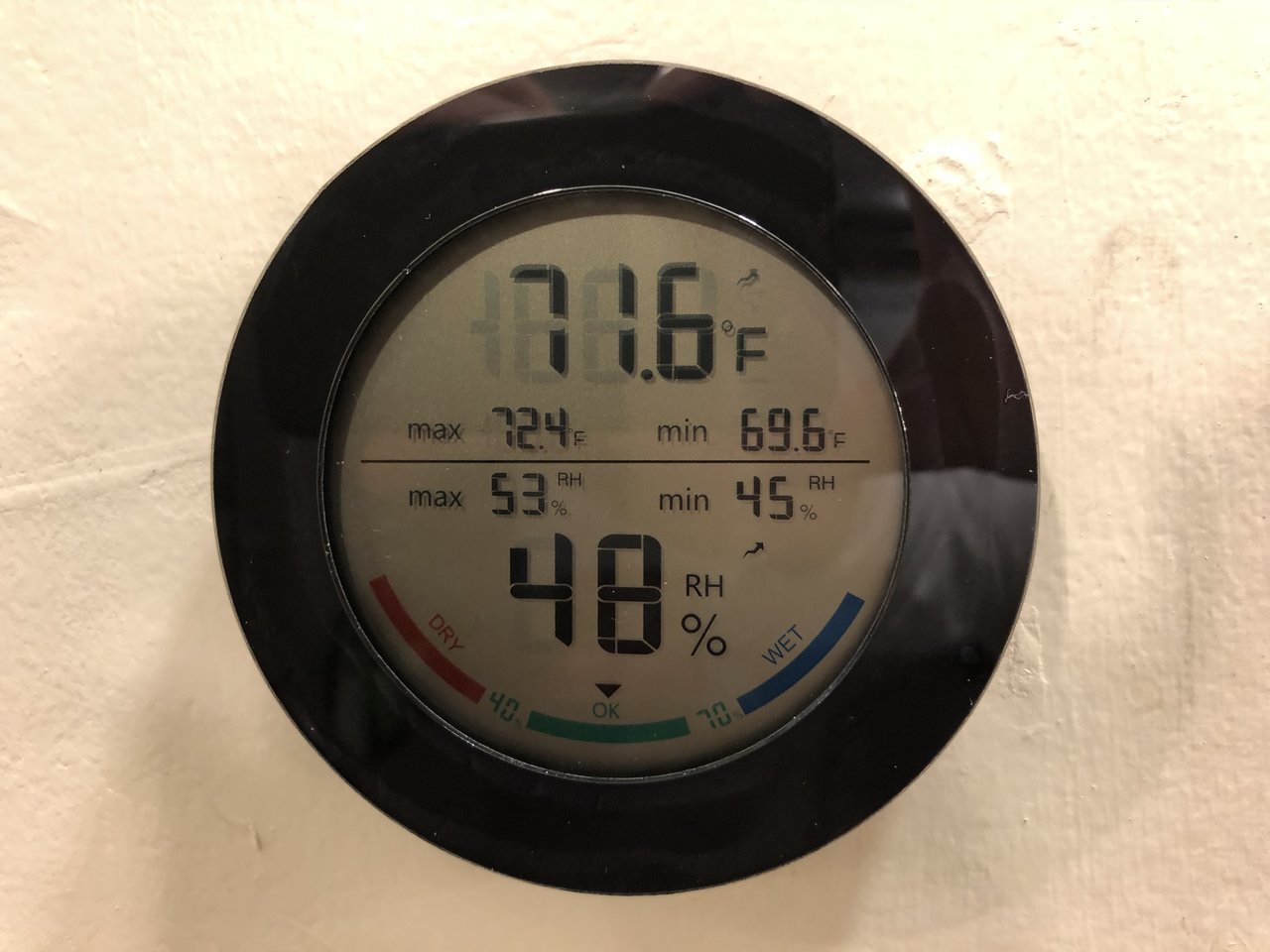

    Too bad you are so far away. Would be quick to hammer out in my toasty heated garage. 40 degrees outside.
