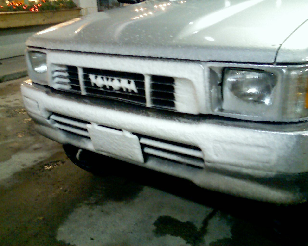

    Found this older pic and thought I would share.
    Most scary moment driving? Easy.
    Crossing Stevens Pass at night in what should have been an absolute complete highway closure. Massive snow storm moved in, with so much snow my center skid was clearing the snow drifts in-between my wheels in a complete white out with cliff drop offs just on the edge of the highway. If you know this highway, a whiteout is the last thing you want on the deadliest highway in the state.
    This is my highly modified 89 with front and rear Truetracs among other mods, including my ultimate headlight upgrade. Despite having 85/80w hot headlights with E-code lenses they nearly froze over in the storm. For those that know hwy 2, this is in Leavenworth, way, way after the pass. Had I been running 'cold' LEDs without lens heaters the outcome could have been worse as they would likely end up looking like my signal markers.

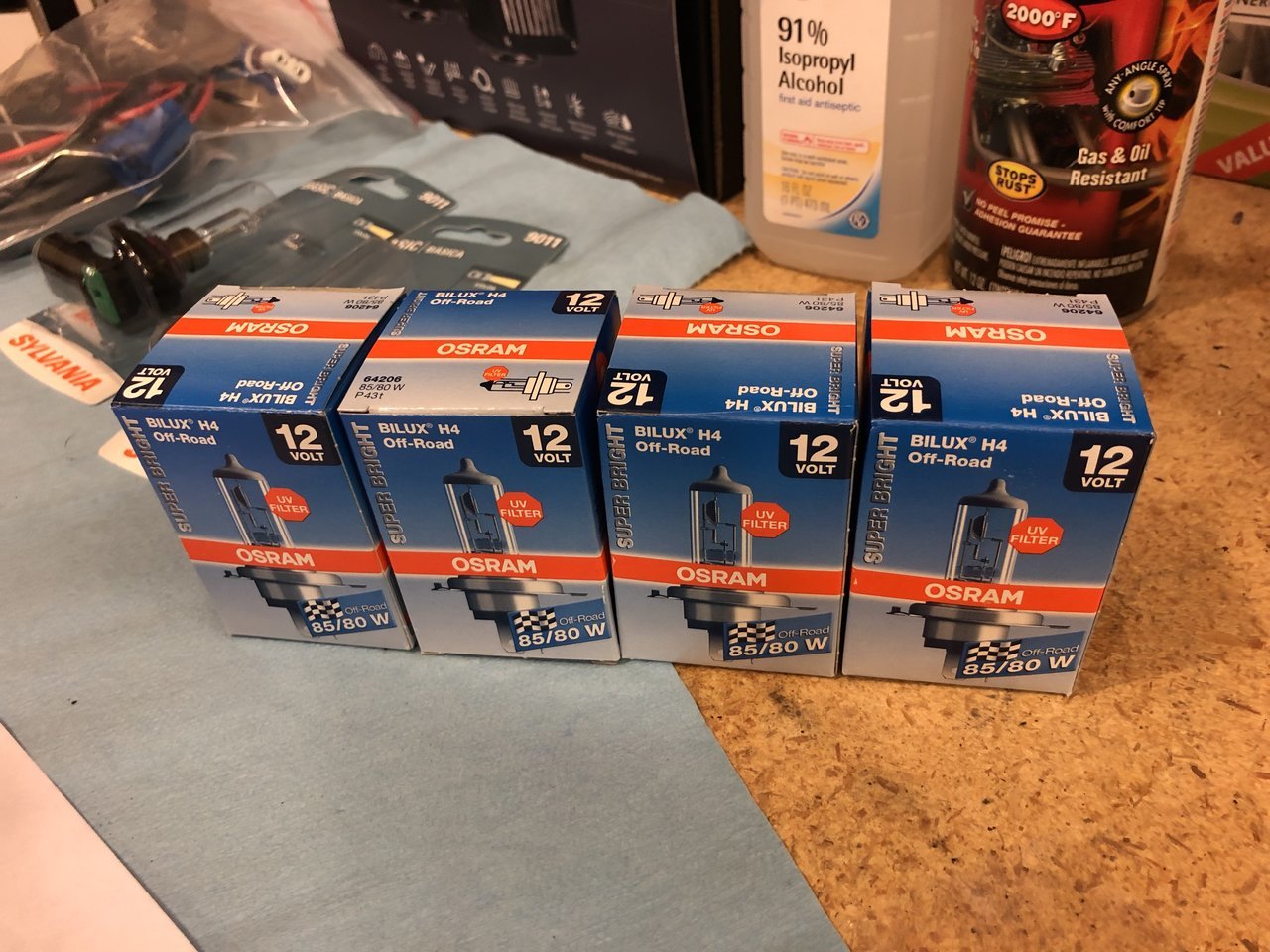

    Fresh shipment

    I recently switched back to stock bulbs temporary before swapping in my new 85/80w Hypers which I installed today. I don’t know how people drive with the stock headlights, I kept double/triple/quadruple checking to make sure they were on.

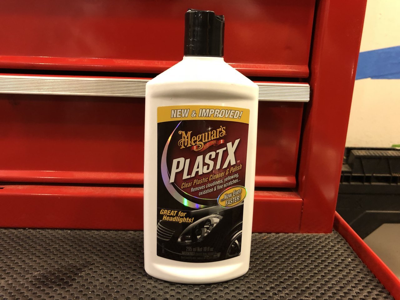

    If you need a quick cleanup for light/moderate hazed headlights, I highly recommend this stuff. I always kick myself for not taking before/after photos. It is very impressive.

    Headlights should NEVER haze if a proper coating is applied and they are cleaned every 2 weeks. I've been driving for 23 years and have never had headlights haze, or clearcoat fail. Abrasive products will clean them up nice, but will only make them oxidize faster if not followed by a durable coating.

    I always put paint sealant on my headlights a few times a year.
