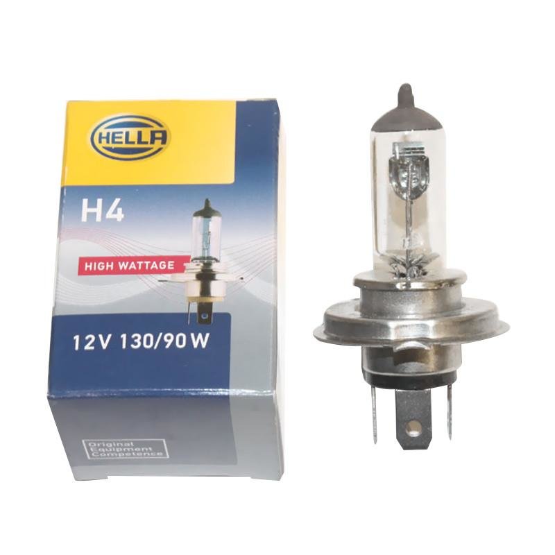

    They will produce a good output difference with the harness, as that wattage will not be adequately supplied on the factory harness. The nice thing about the harness upgrade is allows one to run a variety of high wattage bulbs, it does not have to be limited to the ones I recommend. But I have done a lot of research in my recommendations and make them on a balance of output vs bulb life.
    Compare:
    Osram 100/90w: 2900 lumens, 200 hour life
    Hella 130/90w: 3400 lumens, 40 hour life
    Cost:
    Osrams: $14
    Hella $9
    For about a 17% output improvement, you pay steep penalties in bulb life and will need to buy far more Hellas to match the life of the Osrams, negating the cost savings of buying a cheaper bulb. There is a tipping point of diminishing returns with high wattage halogens, I try to strike the balance between output and life. IMO the Hellas are beyond the tipping point with very short bulb life for marginal gain over the Osrams.
    Toy4me, Norton and BenMara like this.
