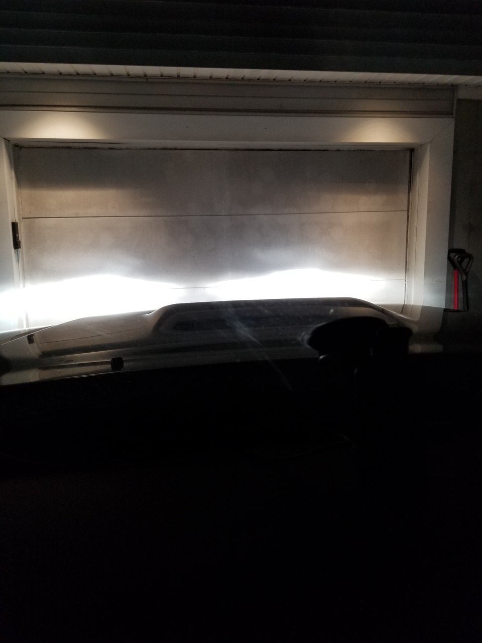

    So I did a night shot with the ZXE's off the garage door. And tomorrow I will do the same with the Philips X-Treme +130's but no matter what the ZXE's are a lot brighter than the candle light that come in it.

  17. Feb 8, 2018 at 4:47 PM
