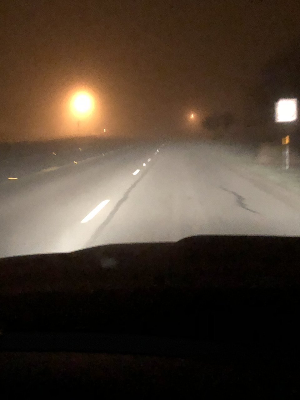

    @z0six here’s a pic of my low beams with the harness an Sylvania ultra Silverstars with fog an about 200ft visibility without fog lights. Well worth the investment an got some Osrams waiting to be delivered.
