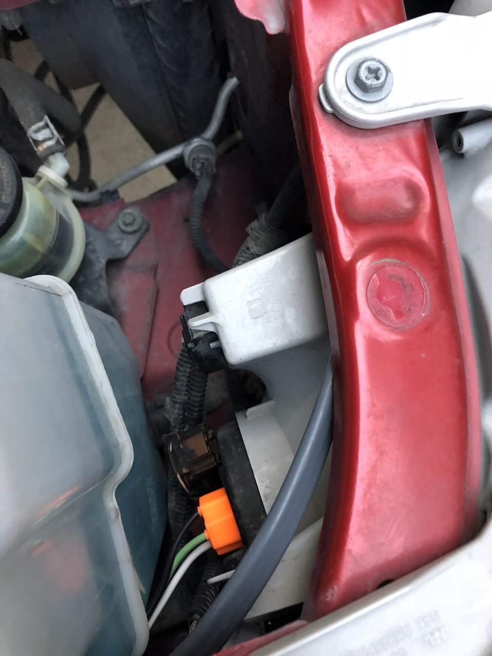

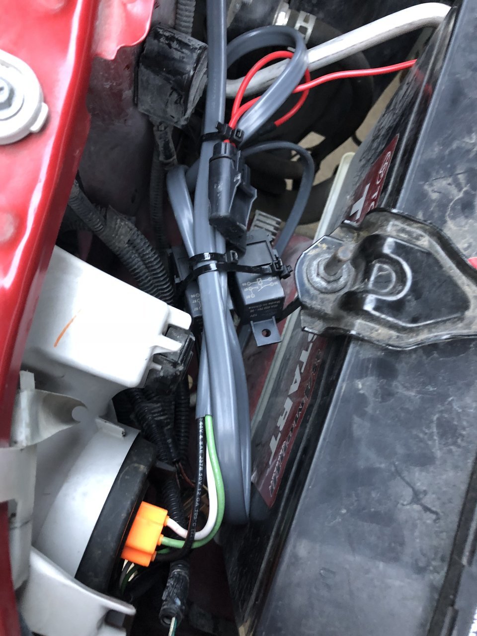

    Here’s mine half baked right now need to tidy it up but you can see attached straight to the battery an male connector in factory harness nearest battery an it attached to bulb ran under Radiator shroud an zip tied underneath an attached to passenger side

    Male connection is the pronged connector on harness an other 2 plugs goto headlights I left my factory harness hanging an zip tied new one

    Since you've found the answer to your first question you've kinda got the answer to your second - the driver side connection takes care of itself. As far as the passenger side tape it up well and zip tie out of the way. Do not remove it. If there was ever a problem with the harness you could just plug the stock harness back in until you were able to repair. This also lets you remove it and connect it back stock if you decide to sell. Then you can move it to your new truck. If Can't help with #3, I bought from Headlight Services and it's fuses are inline an don't require separate mounting.
