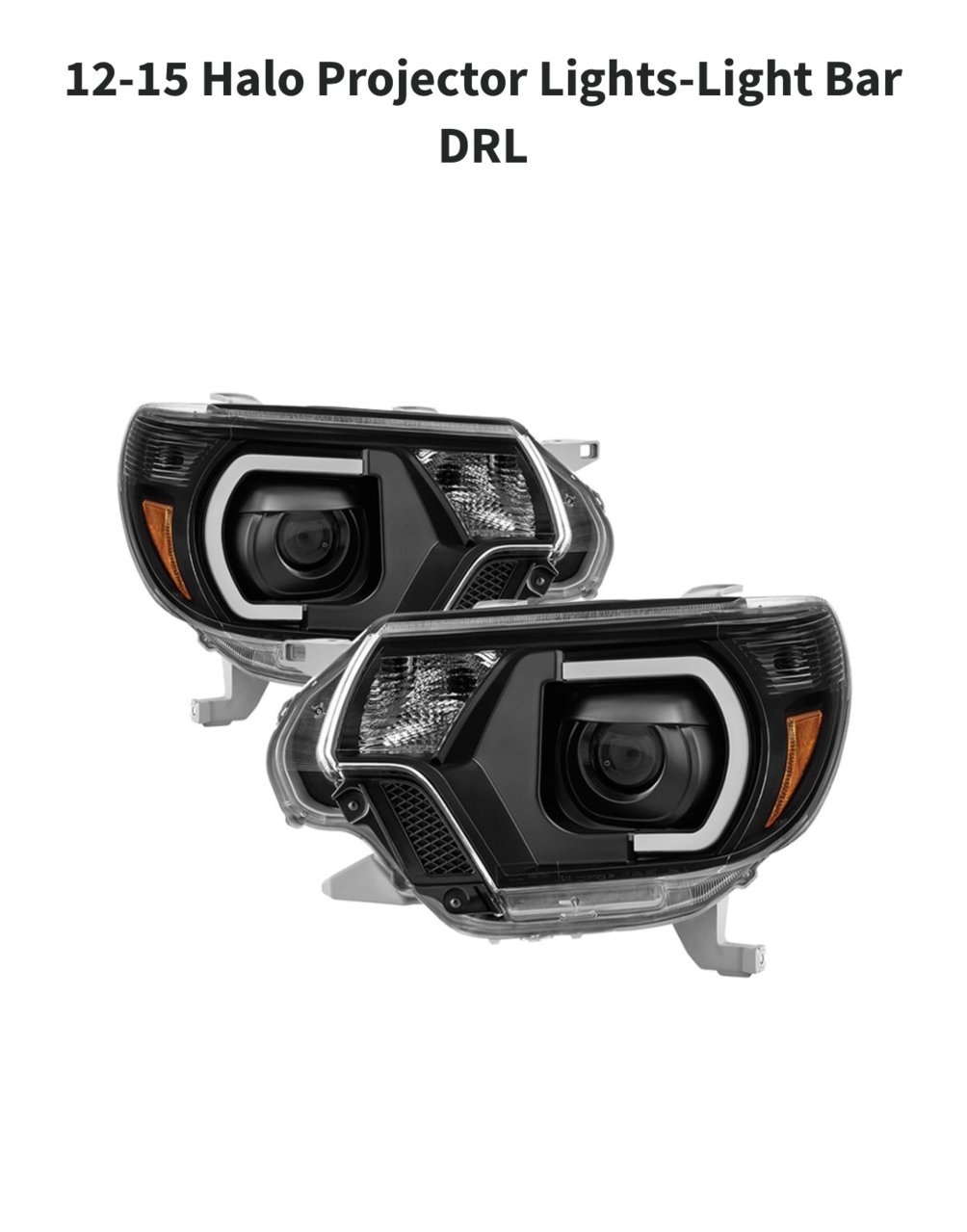

    Ok I’ve tried t read as much as I could without going cross eyed on my phone. I read through the fog light thread and a lot through this thread...
    I just had some questions either for OP or someone more knowledgeable than myself (which would probably be most people here) on a few things.
    -I plan on ordering the headlight and the fog light harness from rally lights that OP suggested.
    -I know OP doesnt prefer the “white” or coated type bulbs and saw the link provided regardless of the more (what I call) pure white lights.... Did anyone purchase those? Is there a similar color light with high output for the fog lights as well?
    -lastly I’ve been noticing the beginning of some slight hazing on my headlights, so I’m planning ahead for my next set. I’ve seen the BHLM/TRD Pro lights and I really like those... But was also wondering if anyone has used the after market lights posted elsewhere in the 2nd gen forum with the projectors? Again, if so, how do they perform with the higher output lights? Is the heat an issue? I live in Texas and am concerned about heat. I’ll post a photo below of the general style of lights I am talking about.
    Thanks in advance TW. I’ve learned a lot from this place and it’s always a pleasure hearing from other members.

    I'd recommend the headlight harness from Headlight Services as the better buy. Not only is it a better price, it also has actual German relays vs Hella German brand Relays made in China.
    http://www.headlightservices.com/Wiring.html
    For fogs you might checkout the latest capped H9s from Daniel Stern. You'll get a huge bump in output without the need for the fog harness, though the harness will still net you further gains. See my post here:
    https://www.tacomaworld.com/threads...1-not-led-or-hid.435419/page-16#post-17685981
    The reason I do not recommend 'white' bulbs is that they are coated, and coatings reduce output and bulb life. You are paying a significant performance penalty for color cosmetics.
    Aftermarket lights nearly always fail to compare to OEM in terms of output and quality. Real quality projectors can set you back $800-$1000, the Chinese 'cool' looking projector lights for a fraction of the price are almost always playing to the cosmetic buyer, sacrificing actual performance and quality. Words you will not find on any other Tacoma headlights aside from OEM, "Made in the USA".
