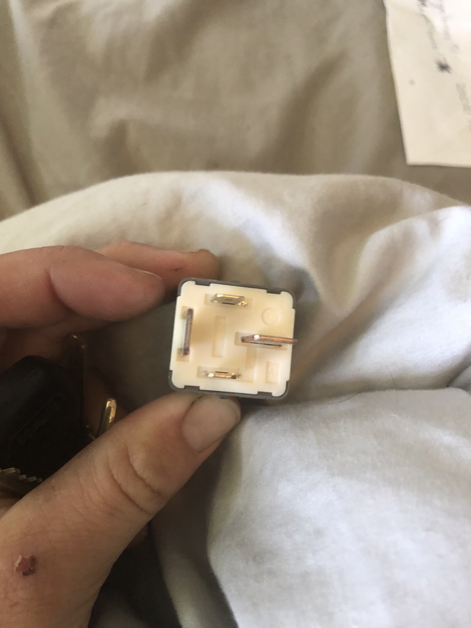

    Anyone have issues with high beams stopped working all I have is lows now or stuck on high. High beam doesn’t click on anymore. Got the rally light conventional with Parma super bright premiums h4 100/90w. 2014 Tacoma dblcab 4x4

    Plugged new harness into the fuse box where headlight relay used to be. The old relay does have an extra plug in/fin on it.

    I’m confused by this you should install the harness where your factory driver side harness plugs into the bulb at the headlight. And connect new harness to new bulb an passenger side unplug factory harness swap bulbs an plug new harness to it. Then wire to the battery should be good to go.

    X2. Nothing should change or plug into the fuse box. The OEM relay should be left in the OEM position.
    The harness plugs into the H4 headlight connector on the driver side as mentioned.
