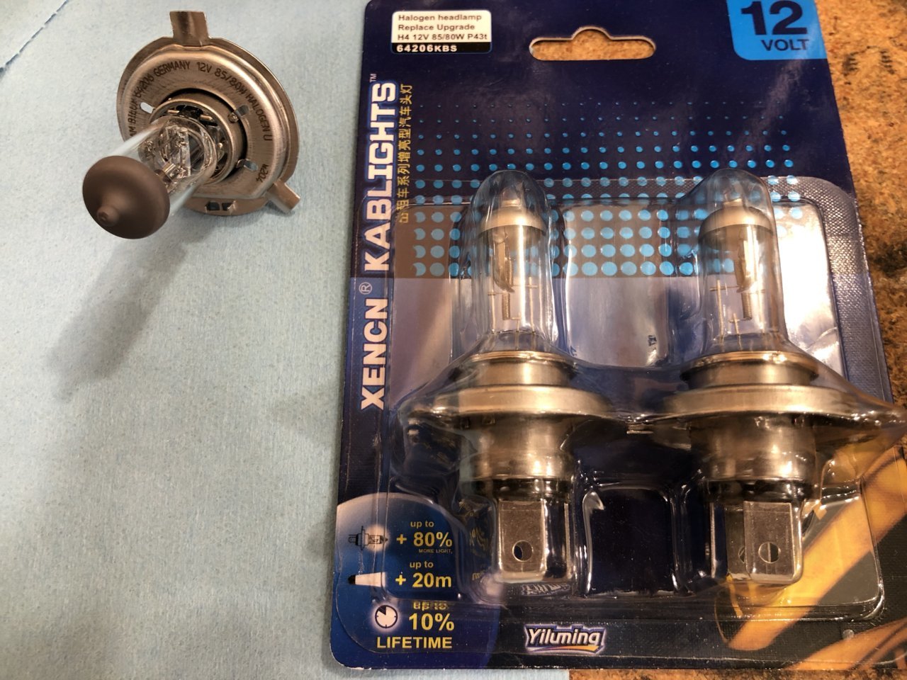

    A while back @Yo'ta pinged me on these bulbs that seem to have similarity to the discontinued Osram Hyper 85/80w bulbs, the bulbs are Xencn Kablights 85/80w. While clearly Chinese with poor english translation, they do say 'German lighting technology' and claim longer range (meaning more precise filament like the Hypers) while also being over wattage in the same amount as the Hypers. The color temperature was also spec'd equivalent to the German Hypers. It did appear they could be a knock off/copy of the successful Osram product, and if so (while quality would be suspect) at $10/pair off eBay would be a good find. So, I decided for $10 to try them out. See them here.
    Packaging
    First thing that should strike as suspicious, higher power and greater distance bulbs have shorter lifespan. The package claims higher power, greater distance and longer lifespan.

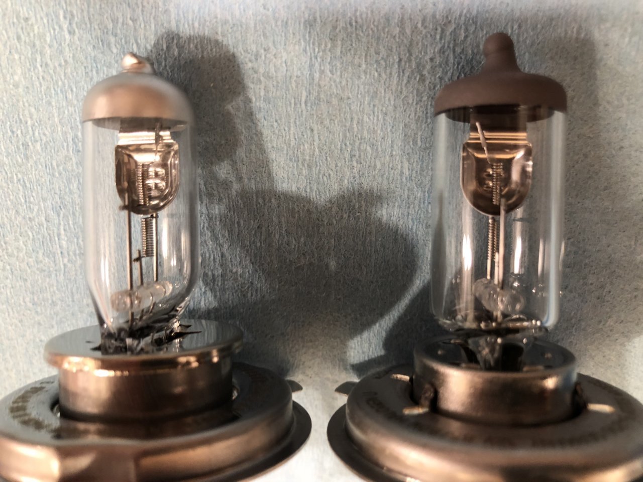

    Xencn left vs Osram right.
    Might be difficult to see in the photo, but the Osram bulb has a thinner more precise filament, which is going to mean more intense hot spot. The Xencn bulb actually has better filament alignment and precision than the $90+ ARB bulbs, but the filament coils are thicker meaning more diluted hot spots. The Xencn bulb overall feels more 'tinny' with thinner materials and the base has a multi-piece attachment point for the bulbs tack welded together where as the German bulb uses a much more substantial single piece base.

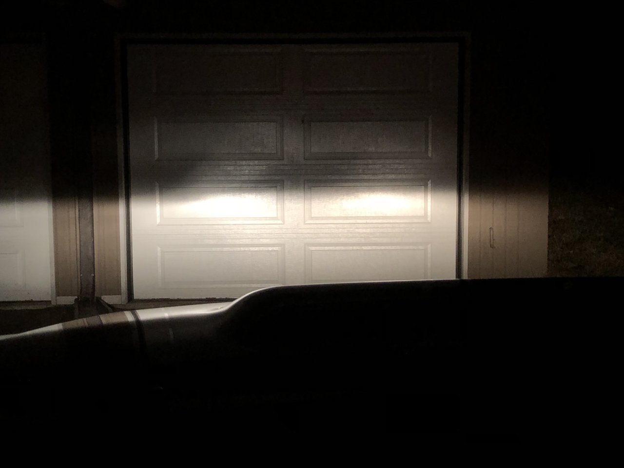

    Light comparison
    Osram left vs Xencn right
    The picture isn't great but the Osram has a more concentrated hotspot with greater intensity than the Xencn bulbs. In person it is clear the left sides hot spot is much hotter than the right.
    Low beam output measured from 19ft:
    Osram Hyper: 1837 lux, color temp: 3400k
    Xencn Kablights: 1630 lux, color temp: 3200k
    Now I was comparing the new Xencn bulb to a well used Osram bulb, so a new Osram would likely rate higher as halogen bulb output decreases over the life of the bulb. It is difficult to say what bulb life would be on the Xencn's, though they are certainly a more price friendly option. While I tested these against the Osram Hypers, the Hypers do outperform the Superbrights, but I do not have any Osram Superbrights on hand to compare against at this time.

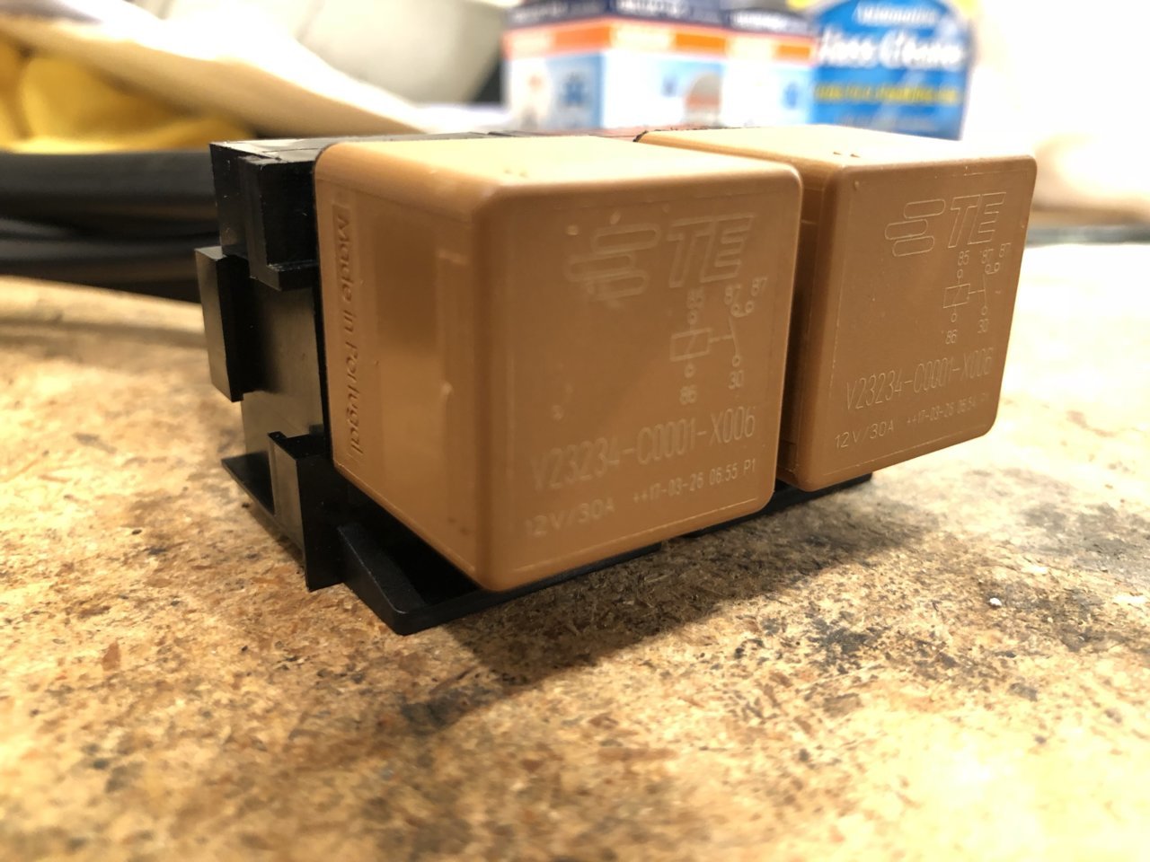

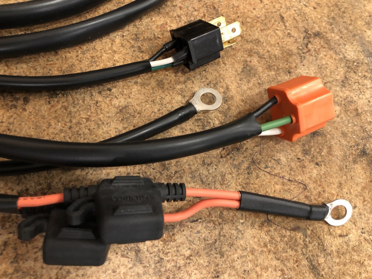

    Mike at Headlight Services sent me a headlight harness for evaluation. Mike had explained how he will only use the highest quality parts, refuses to use Chinese relays in his builds and takes great pride in his work. My initial thought was that it is a wiring harness, aside from relays, how different can they be? All I can say is WOW! The attention to detail in his work is astounding.
    You do not see raw wire, or wire connectors anywhere on this product. Everything is shrink wrapped and sealed. The fuses are even bent and non-equidistant to be off set from each other so they can sit more flush, while using higher end silicone/rubber fuse holders which are easier to operate. It also uses seperate fuses for high and low, whereas Rallylights combines everything into a single fuse, meaning if the single fuse were to blow you’d have no headlights.
    The relays are European made Bosch-Tyco TE relays.
    And to top it all off it included zip ties, a spare fuse, excellent install directions that were very clear and the wire loom is a more appealing black (vs grey from Rallylights).

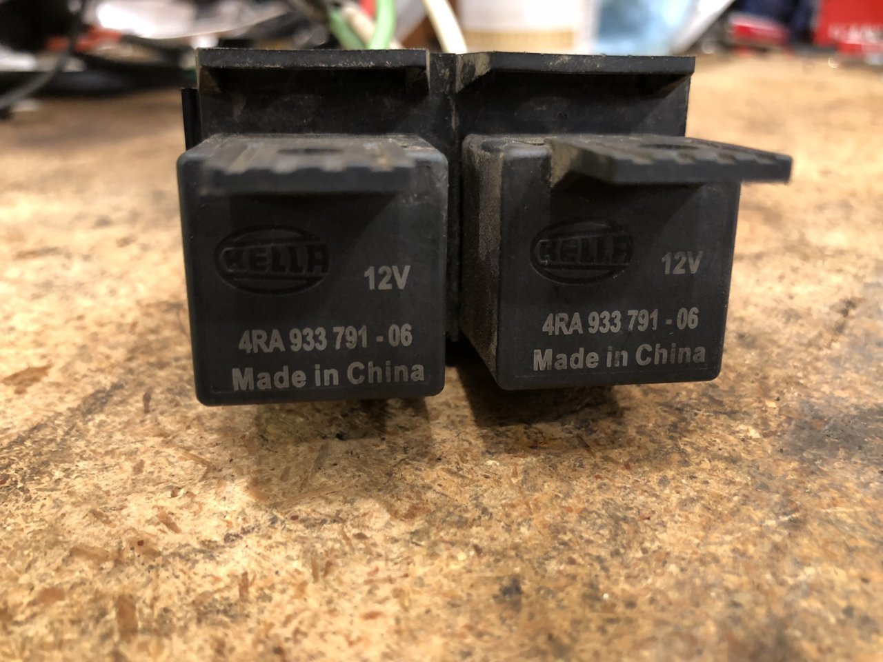

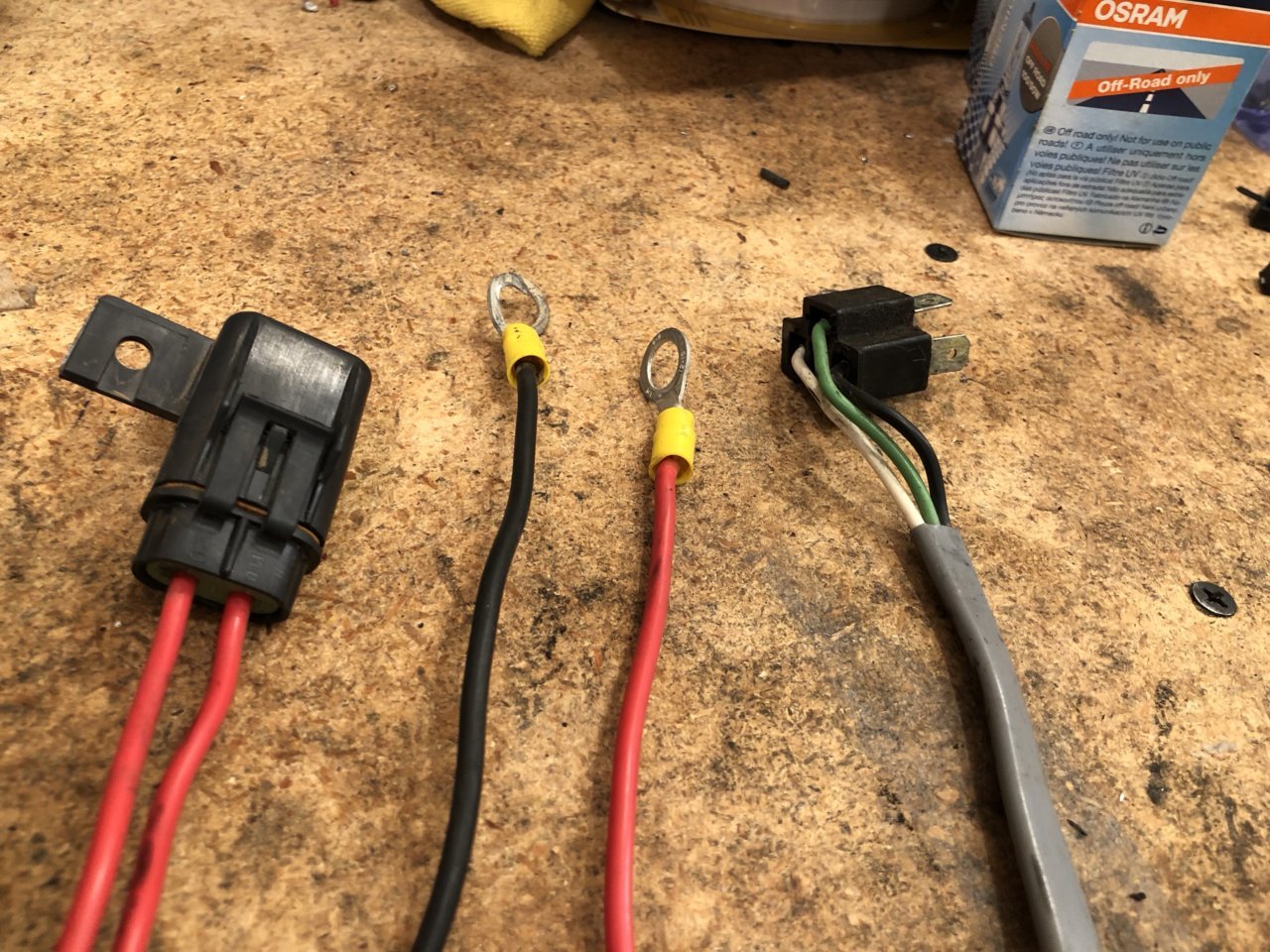

    To compare to the Rallylights build (this is used off my truck, so it is a little dirty, don't fault the product)
    Basic crimp battery terminal connectors, with exposed connections. The headlight harness plug connections are entirely exposed and open. The headlight plugs themselves (not pictured) used clip shut doors on the back of the plug to cover the connections, which are now both broke held shut by electrical tape.
    While Hella is certainly a quality name brand, they now produce their relays in China.
    While the Rallylights harness has served me well over the last 3+ years, the build quality is not up to that of the Headlight Services product. After seeing the outstanding build quality of the Headlight Services harness, it is readily apparent this is a product of passion. To top it all off the Headlight Services product is notably less expensive than the Rallylights harness while being better built with higher quality components.

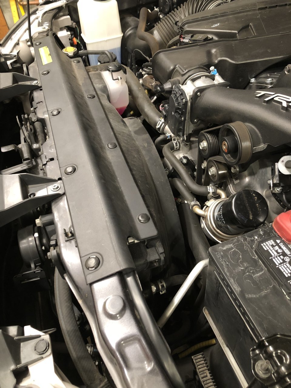

    I now run Mike's harness, which with the black loom is even more stealthy under my radiator shroud.
