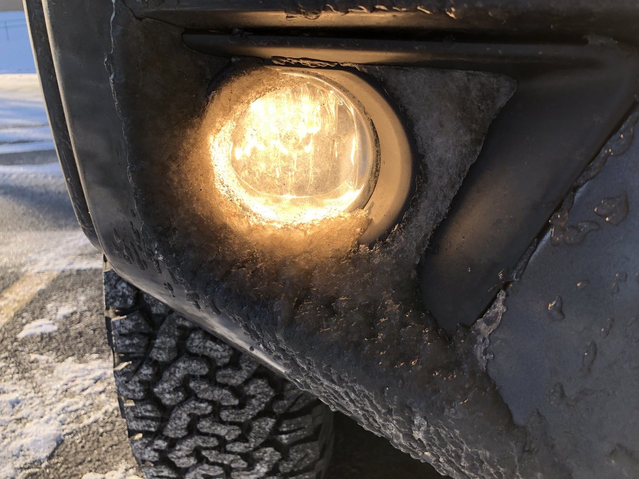

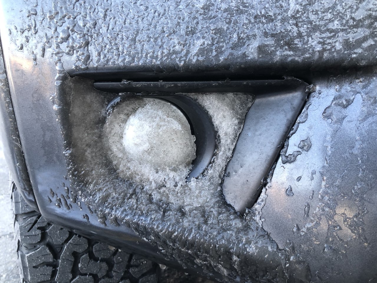

    I did realize looking over the fog threads that I did not include information on how to use the fogs. If you have PM'd me about fog upgrades, I have likely asked if you drive with your fogs on all the time or reminded you not to if looking at a higher output foglight. Fogs should only be used when needed otherwise the foreground light reduces distance vision. I don't use my fogs often, usually it is in awful low visibility conditions crossing a windy mountain pass in a snow storm with dangerous steep drops and lack of ability to find the edge of the road way. Headlights are completely useless, and often times I cannot even tell if I am in the oncoming lane or where the road actually is. Ever come head-on to an 18 wheeler and not know if you need to swerve right or he does? There are no highway lights, no markers. I want the power of the sun in my fogs to try and see where the edge of the road is in these conditions. I realize this may seem very extreme, but these are the conditions that I have developed my fogs for. I do not drive with them on when they are not needed, they are not aux lights, and an LED fog would freeze over and leave me blind in these conditions.
    I've been messaged by multiple others that the fog upgrade has literally saved their truck from deer on back mountain roads (with no oncoming traffic) that the extended range of the fogs has allowed them to see further to the proximity of the vehicle and avoid accidents in deer country.
    I should likely add a section in the fog threads for how to use fogs effectively, and that they are not 'aux lights' for street use.
    So yes, DS is correct in his statements. I present information and provide options but rely on TW members to make the best choices to fit their use cases. I warn people all the time about the the foreground light causing loss of distance vision, especially in retrofitting LEDs. I know my modifications may be ridiculously overpowered in some cases, but when I'm forging a mountain pass that should have been closed in a white out where it is challenging to find the road in a windy 2 lane highway with no other vehicles on the road, I want all the power I can to illuminate the roadway.
