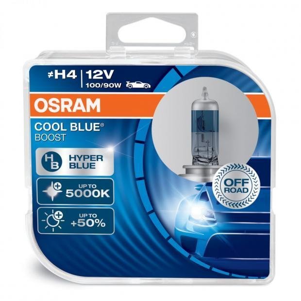

    Well.. (as a caveat I have read the pieces of this thread on coated bulbs and understand I get less light than otherwise)..
    But I do prefer the whiter/bluer light on my Volts Lowbeams... So I found these... Higher wattage, likely with coating for color... But overall will best stock and get me closer to a color of light I really react well to..
    OSRAM Cool Blue Boost 9003 (HB2/H4) (Twin) - from power bulbs
    OSRAM-Cool-Blue-Boost-H4-62193CBB-HCB-At-PowerBulbs-1_620_620.jpghttps://www.powerbulbs.com/us/product/osram-cool-blue-boost-h4
    Anyone have personal experience with these? Or test them? Seems like a good compromise..
    Just looking to find bulb life listed.

    Never tried them. They will pay a heavy penalty with the coating, but they are also high wattage to generate greater raw output than stock. Osram is a quality brand, cannot comment on their performance but it will surely be better than the Optilux equivalent.

    Yes, after reading through the posts you linked, I will be avoiding the optilux mark. :)
    I'll give them a try, as they will be genuine Osram at least, and they are a good price right now.
    Thanks for the help. I still plan on Harness with stock old bulbs for a baseline, then do the bulb swap and see how they go.
